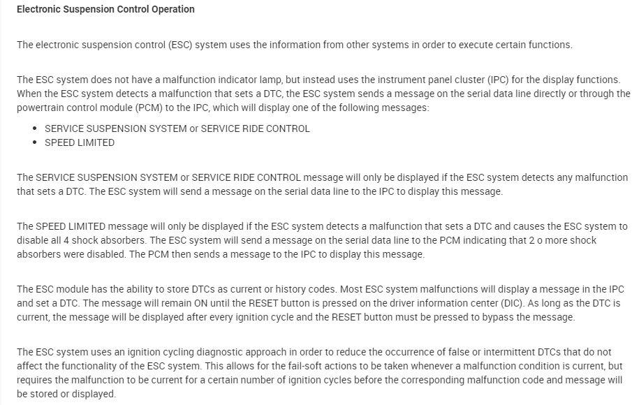

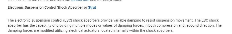

The vehicle ride suddenly turned bumpy and bouncy as if the front end shocks were bad. It has MRC shocks. The front end (both sides) seem very stiff compared to the back. I was told that they may have “locked up”.
How can they lock up and what would cause them to lock up?
The other thing that coincides with this was a recall for loss of braking vacuum firmware update.
This problem became noticeable & showed up after the GMC dealer update.
If they are locked up, is there a solution other than to replace them?
May 2, 2020 at 11:52 AM

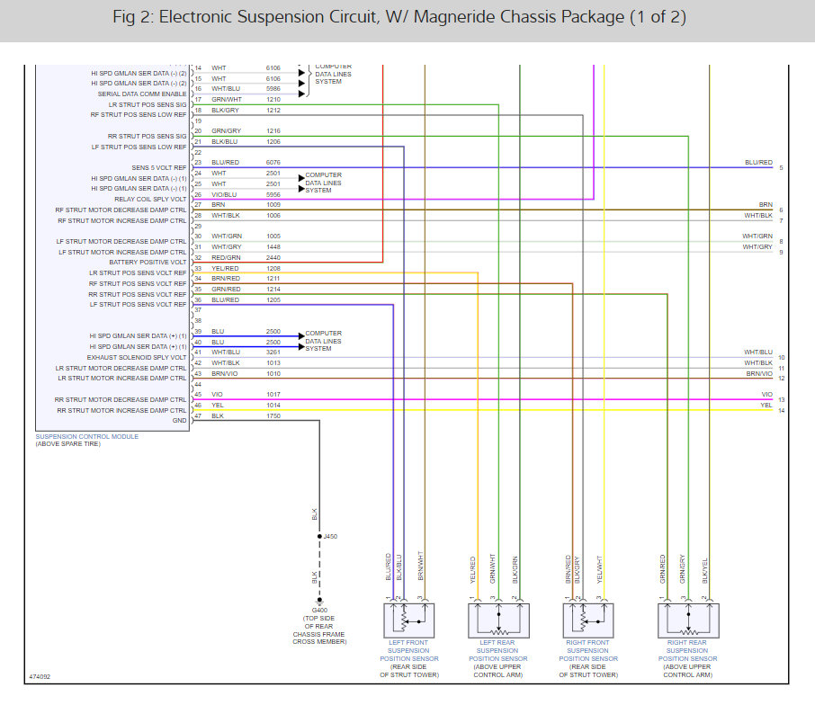

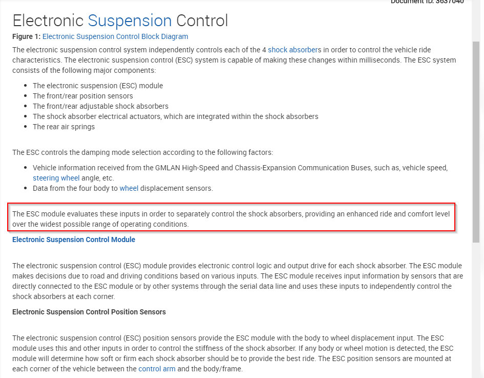

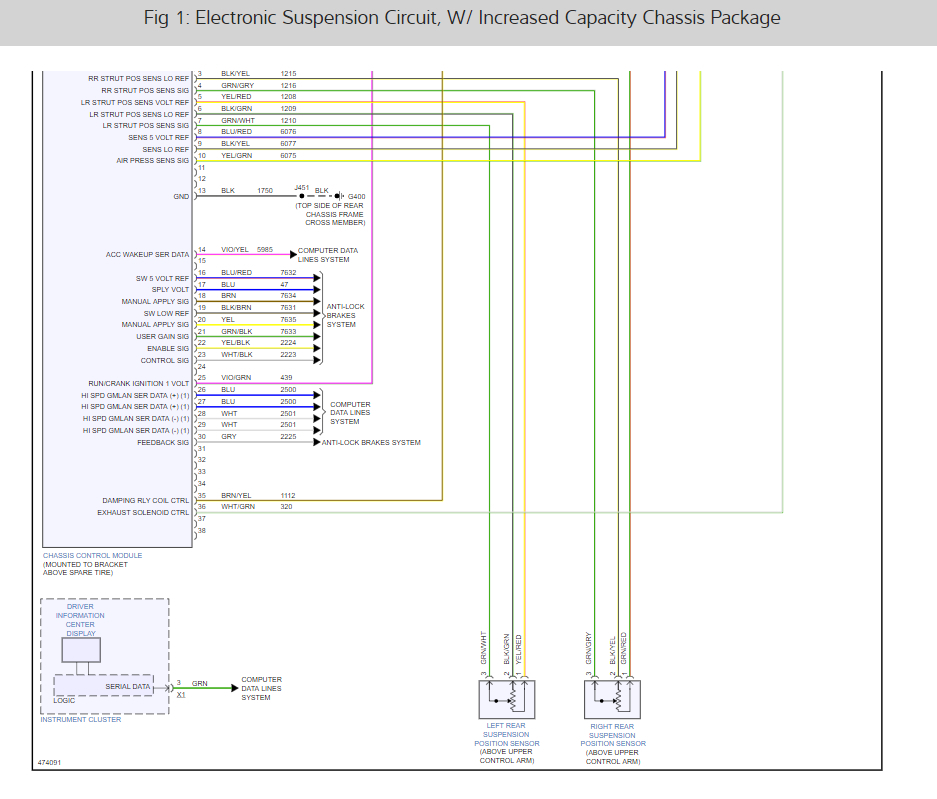

If both sides failed at the same time then it is unlikely that the shocks themselves failed. It can happen but is not likely. Basically these are independent components and for them to fail at the same time is highly unlikely. The fact that both of them are controlled by a singular module, I would look at the module as the issue. Also, it is most likely a faulty sensor or other input to the module to make it think that the more firm setting of the shocks is needed.
I included all the info about this system for your review. Let me know what questions you have.
As for the recall being related, that is very unlikely. If this were causing a problem it would be well documented because they have done tens of thousands of those recalls and I don't see any other documented complaints of this happening after the recall.
As for how to figure this out, we need to find out what the input sensors to the module are telling it to find out if there is an issue. The only way to do that is monitor it with a scan tool that can look at this live data.
Let me know what questions you have and we can go from there. Thanks

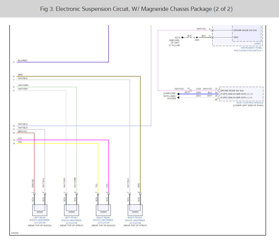

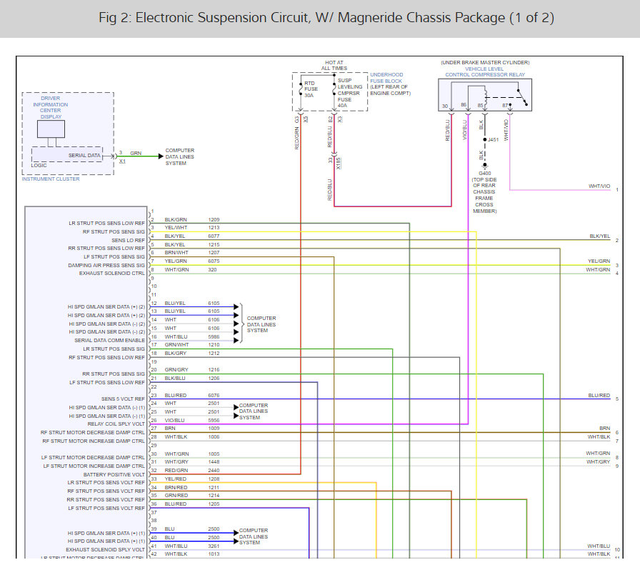

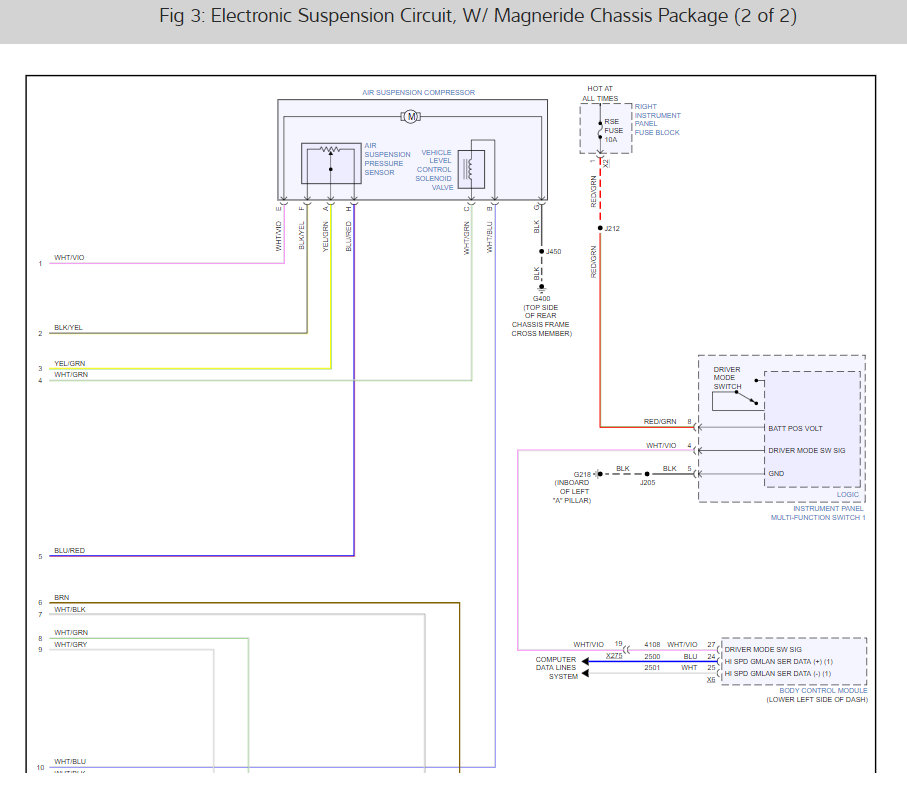

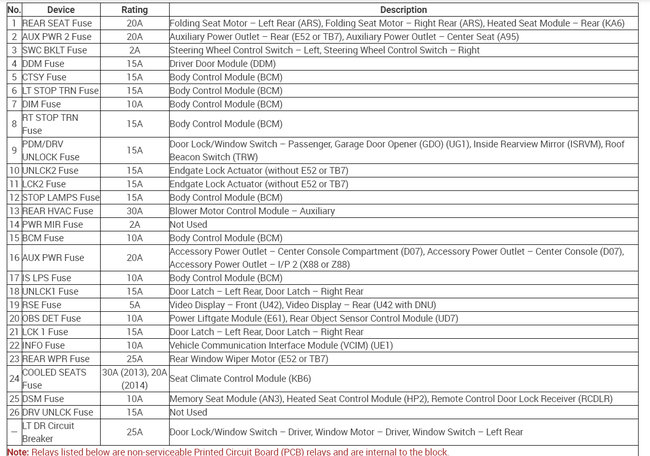

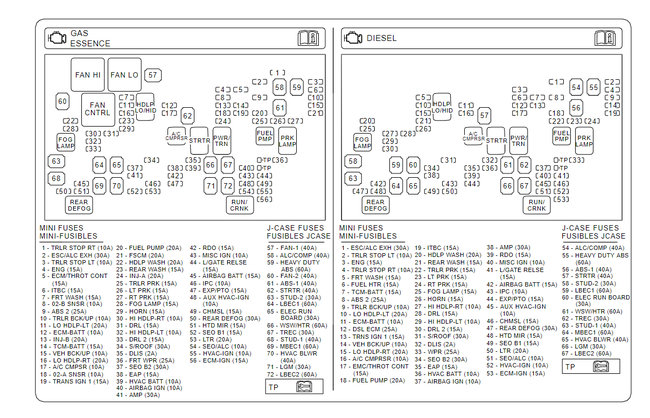

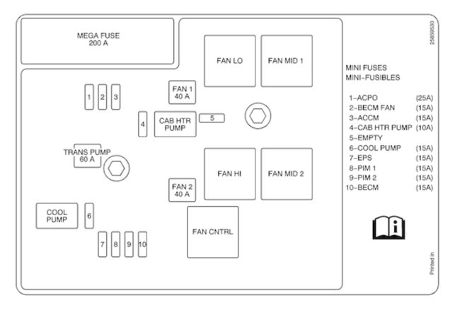

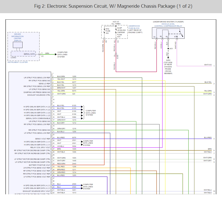

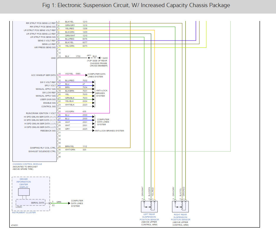

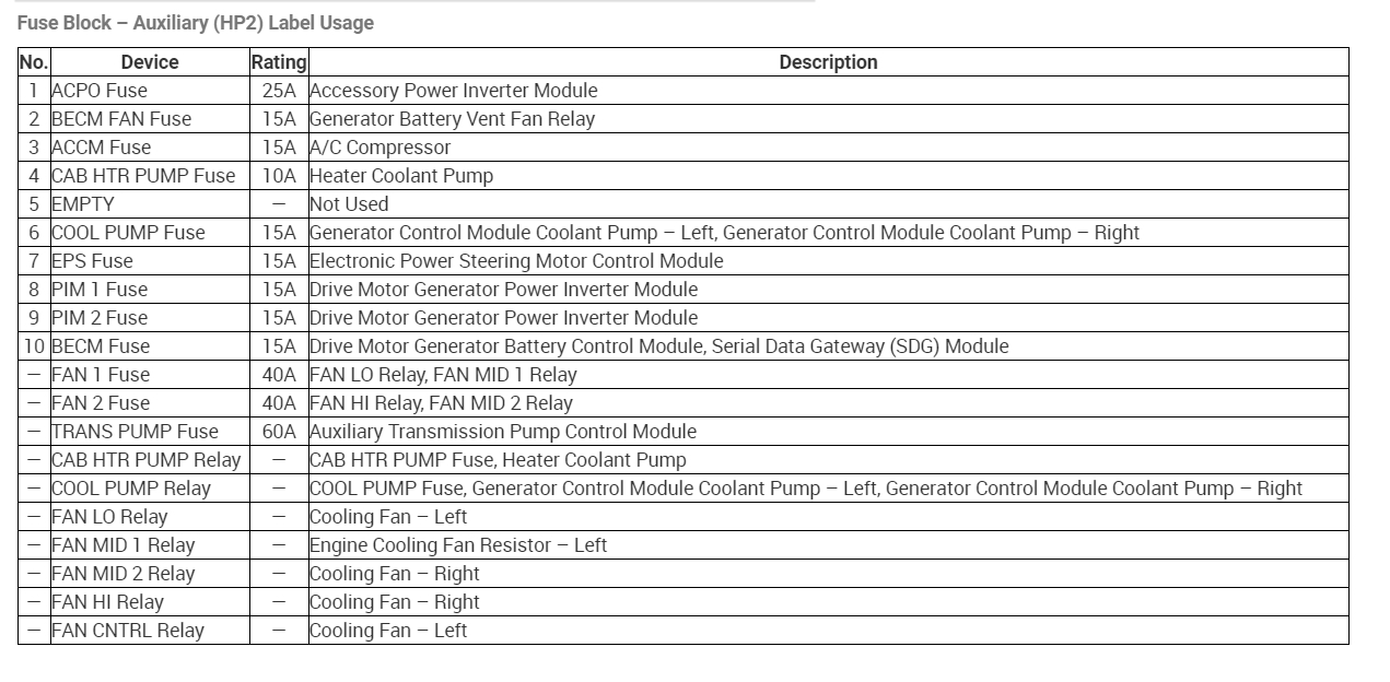

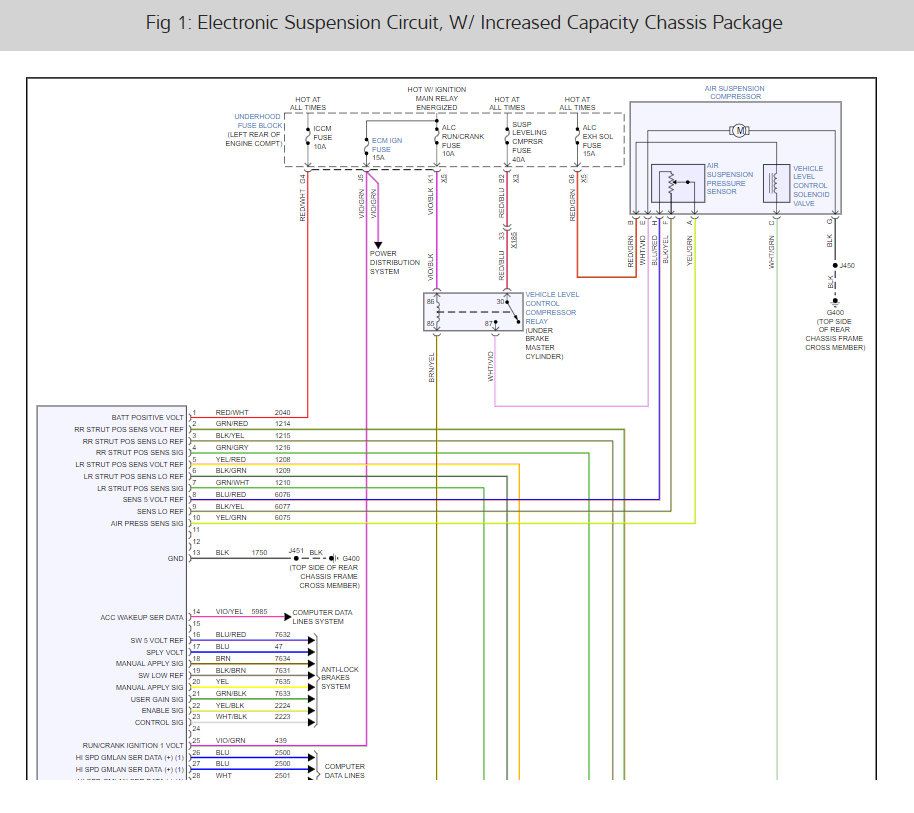

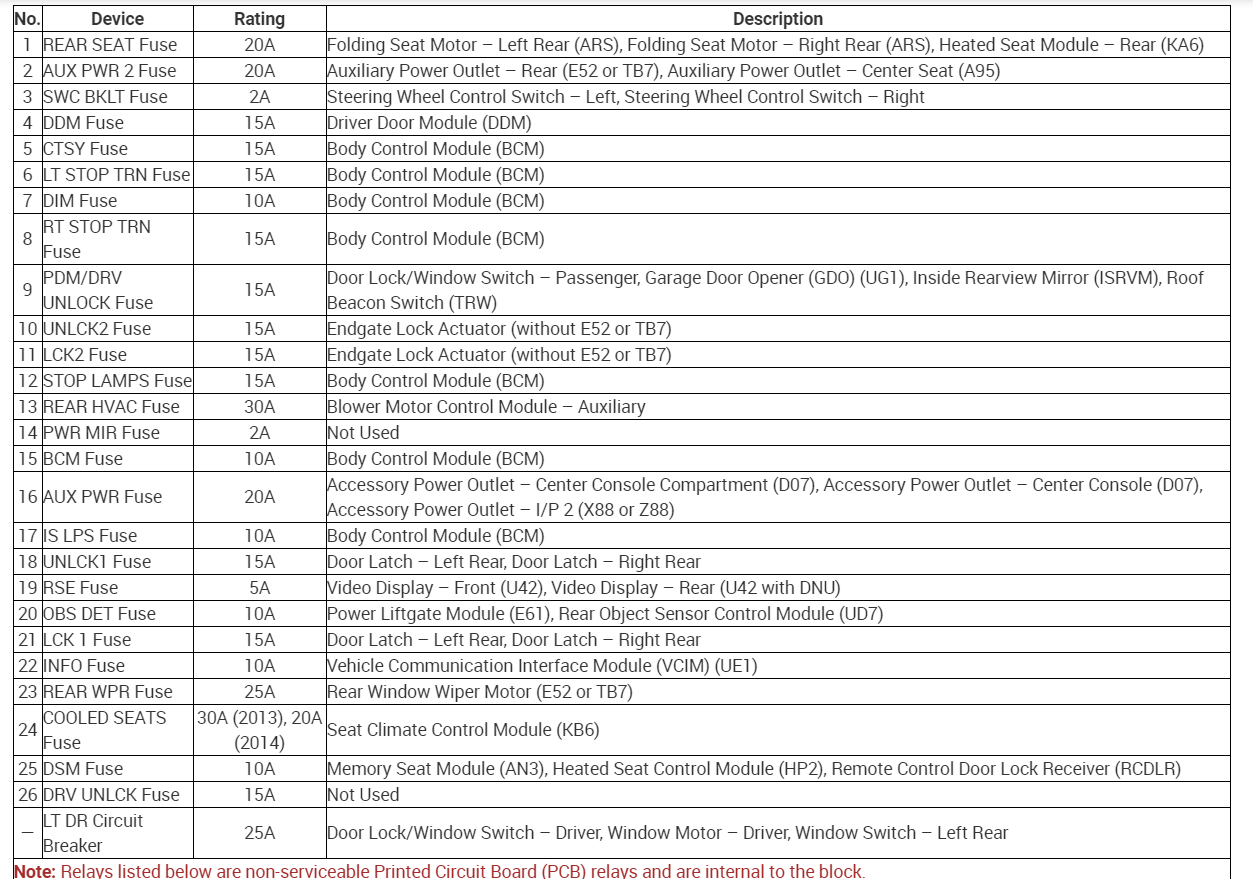

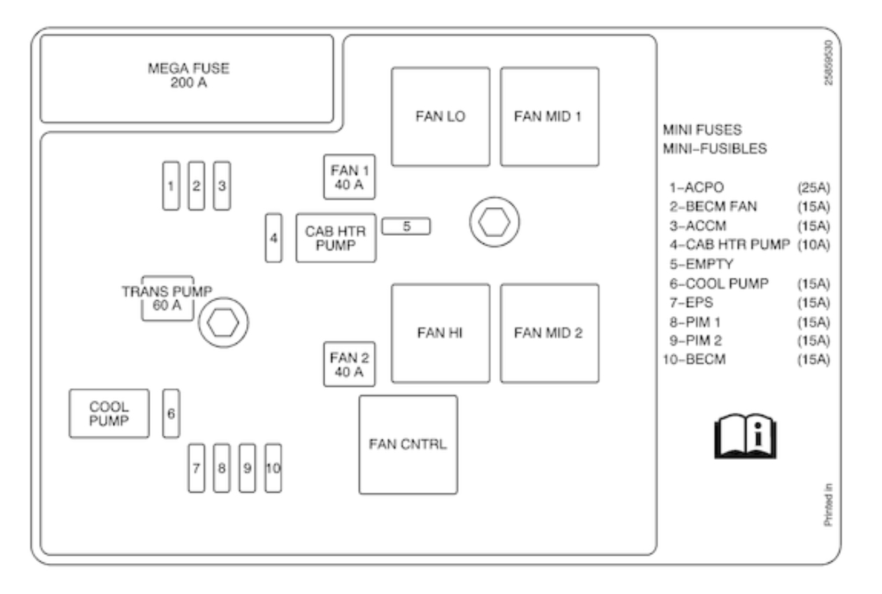

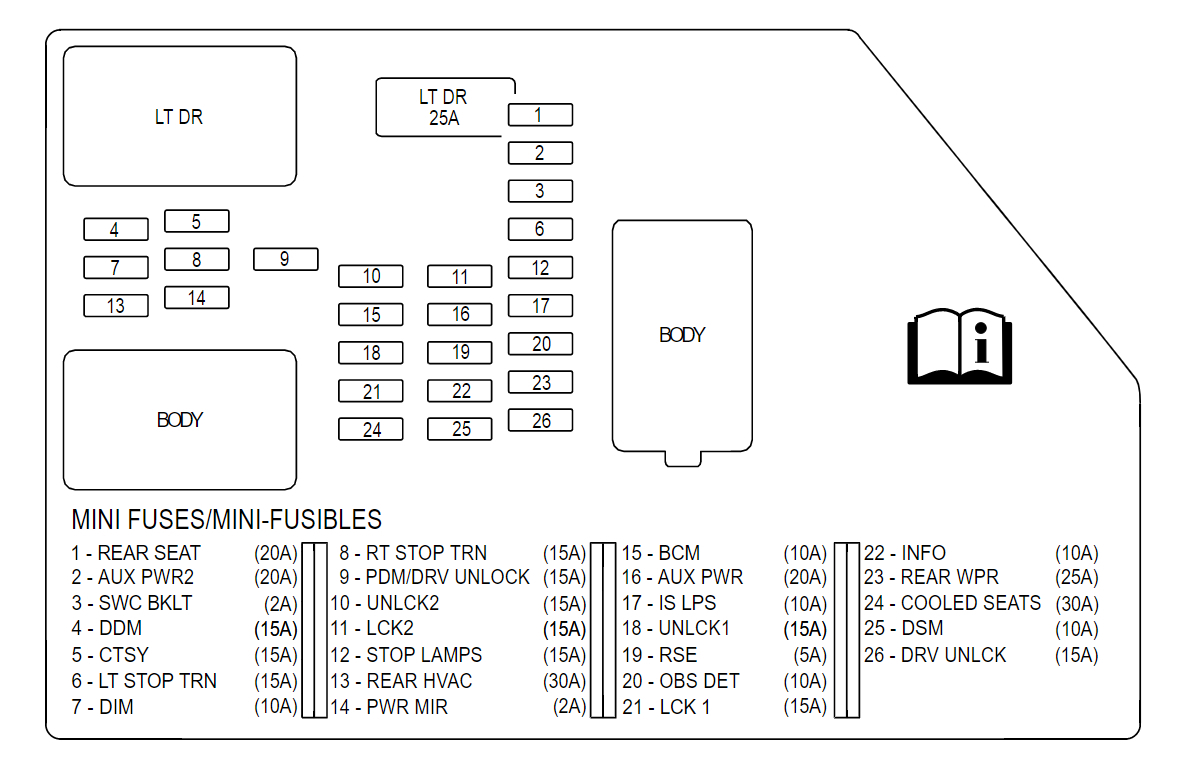

4th time? I only see the once. Anyway lets start by checking the fuses (RSE, RTD, ICCM, etc) here it a guide to help you with the suspension wiring diagrams so you can see how the system works with the fuse locations as well:

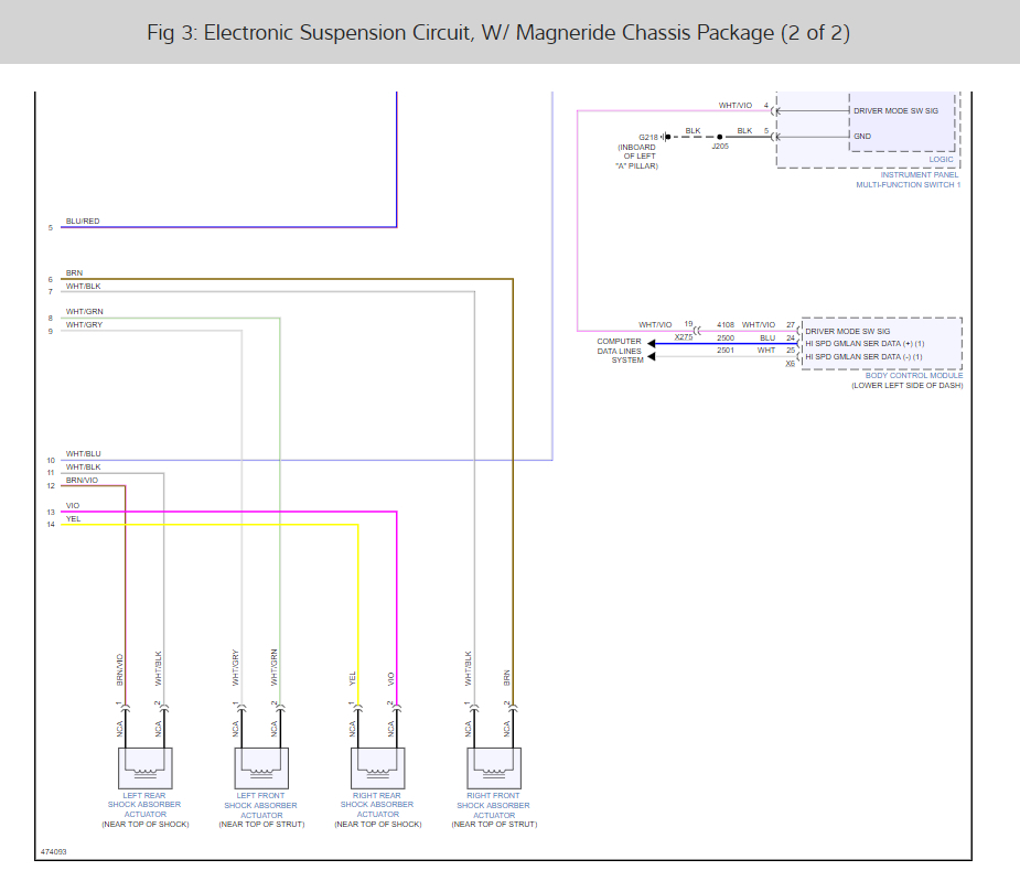

I don’t believe the issue is electrical. The shocks as reported by 2 different technicians are “locked up”. No dash alert.
I removed the electrical connections to both shocks. Drove it, bounced it. No difference in performance. Got dash alert. Both shocks extremely stiff with or without power.
If the shock control module were out or a fuse blown(?) Why don’t i get a warning like i did when the shocks were dis connected?
If the shock control module is out or fuse blown, wouldn’t the rear shocks act the same? (they don’t, but rather like a shock with give with the engine off.
Back to the original question, how can these shocks lock up? How to unlock them?

I’m reviewing the schematics as well and will check for a fuse problem. As I said, it doesn’t follow for a dash indicator when disconnected and none when connected.

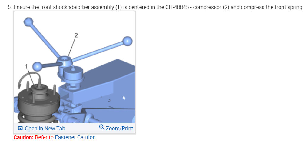

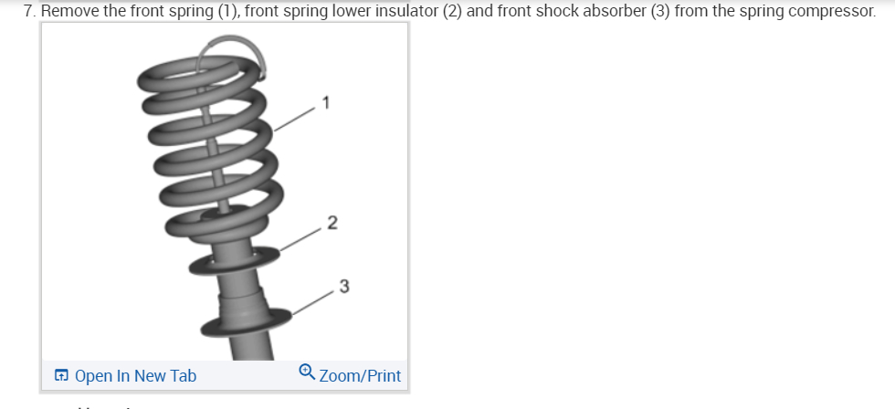

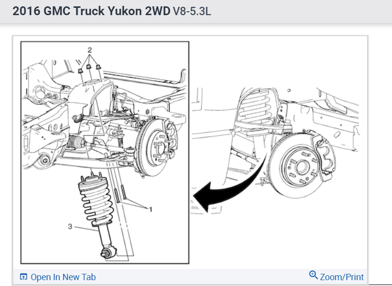

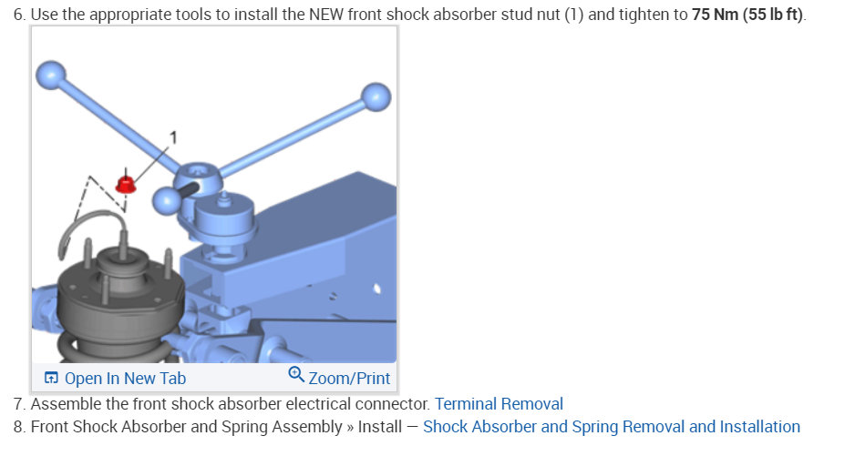

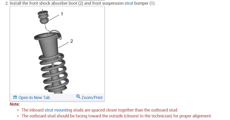

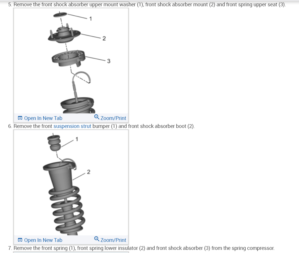

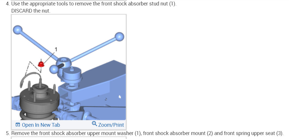

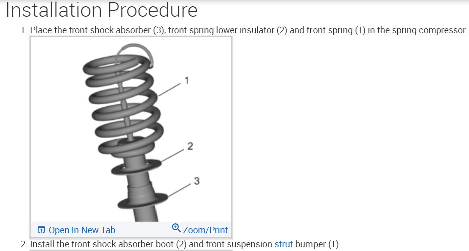

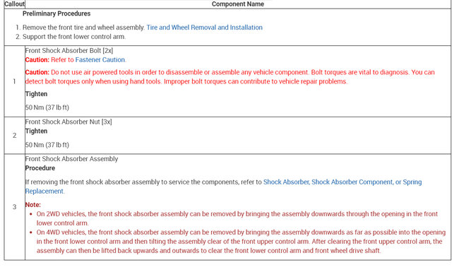

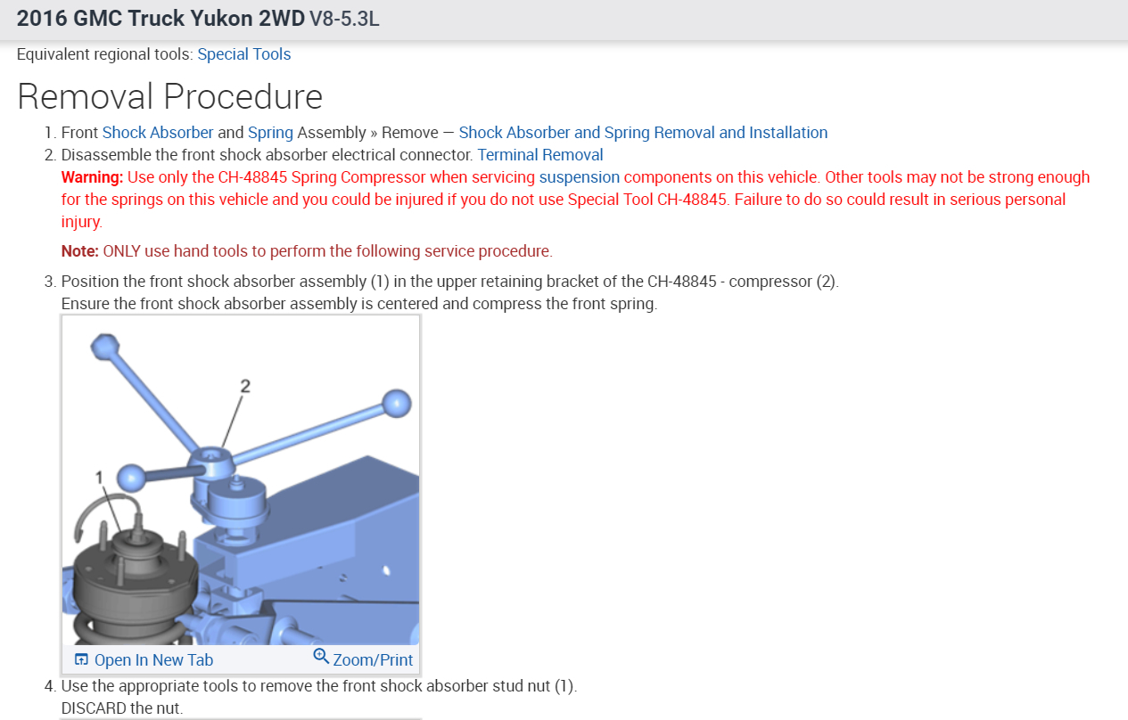

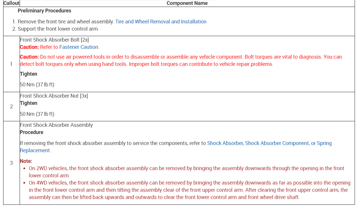

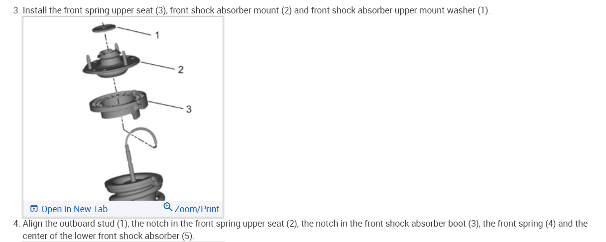

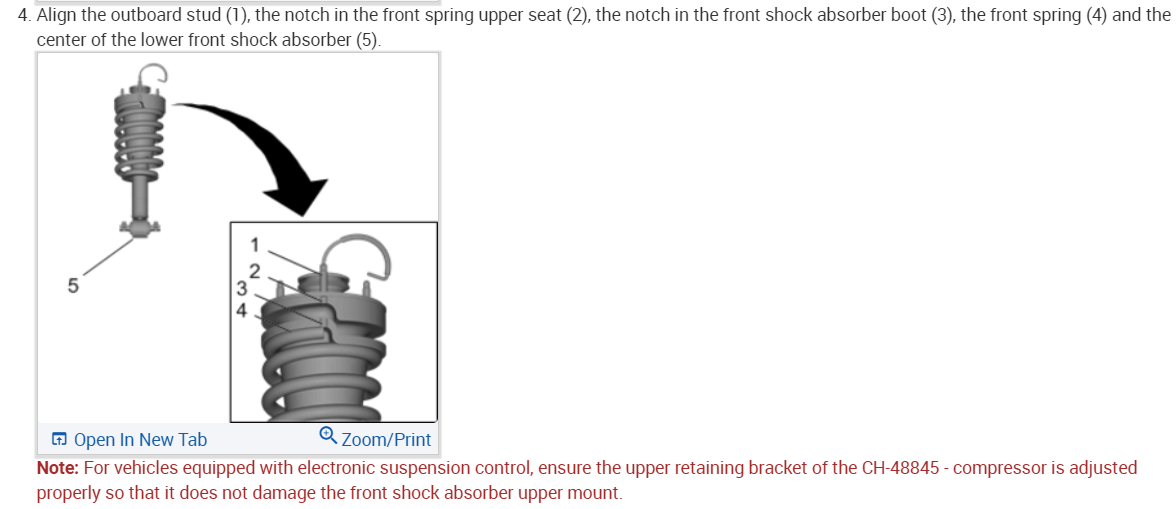

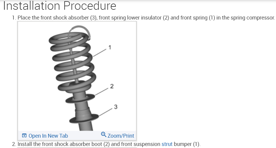

The shocks should not be stiff with the electrical disconnected. It must be one shock that is locked up causing it to seem like both. lets remove the shocks to confirm here are instructions in the diagrams below. This video shows how to remove the shock and spring on a similar car which the process is the same:
https://youtu.be/sug_NoHfXG0
May 11, 2020 at 4:14 AM
