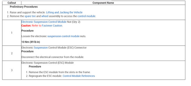

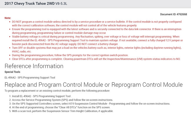

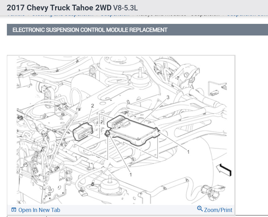

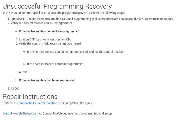

It sounds like it, I am wondering if the first left replacement strut shorted out the module or you have a bad connection at the strut or module. Here is the location which is on top of the spare tire so you can check it out. It looks like the suspension module needs to be programmed so I would search google or eBay to look for a preprogrammed unit. Please check out the instructions and location below.

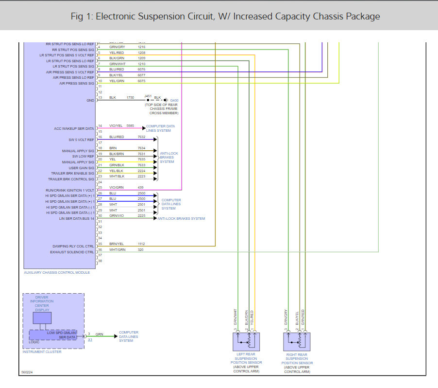

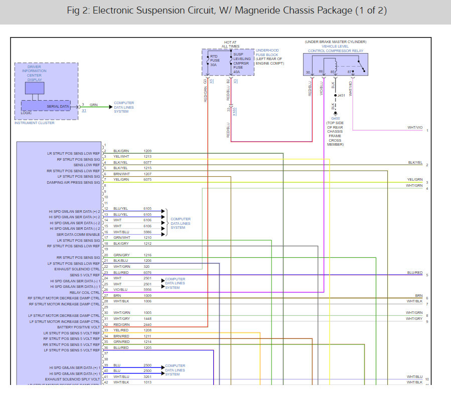

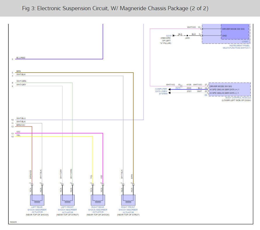

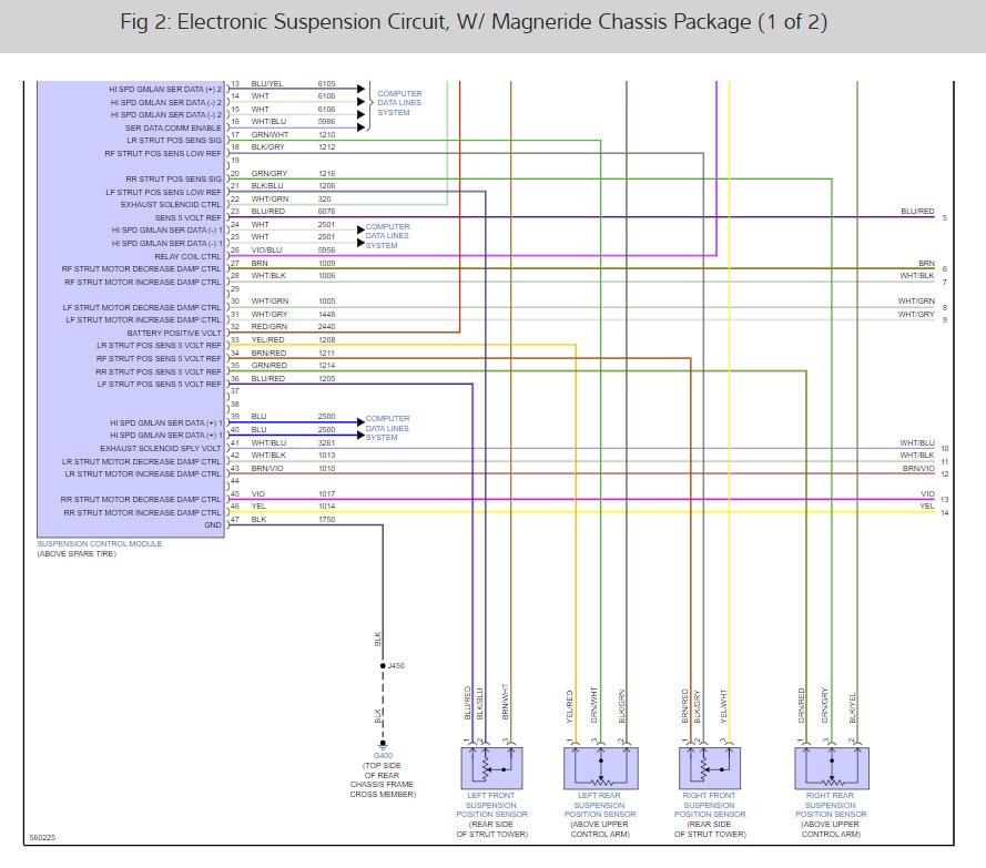

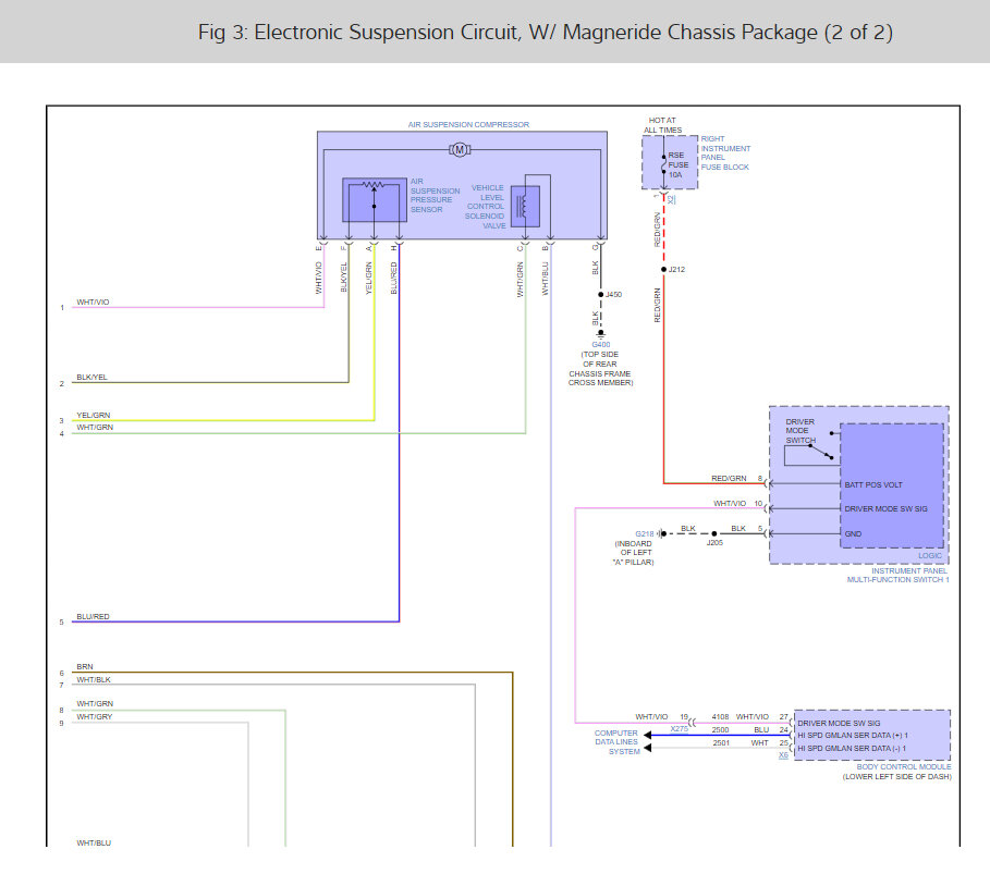

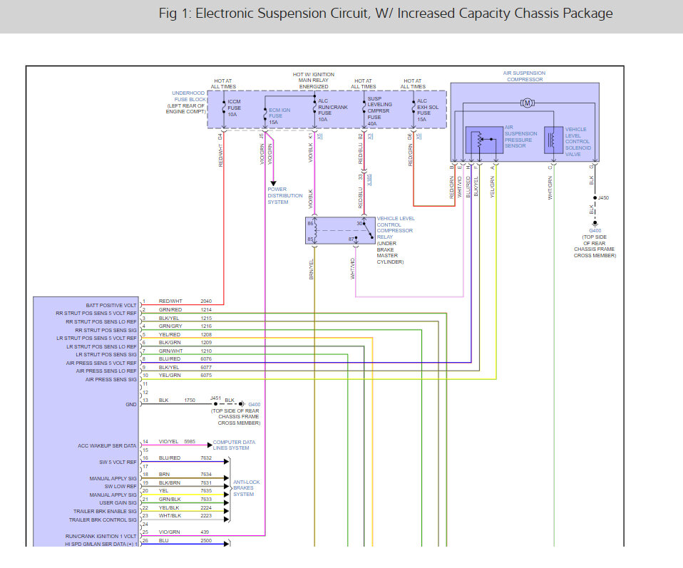

Yes, it could be the module is not working correctly, Can I ask how much the module was? Also please check the fuses to make sure they are okay here is the wiring diagrams so you can see how it work and which fuses to check.
Feb 23, 2023 at 3:07 AM

Dealer was unable to program so I’ve ordered a new one from GM. Pretty sure the shocks are ok since this is now the third one on that side that’s giving me the same error. The only thing I think might have caused this was I was messing around with the actuation function on my scan tool trying to actuate the shocks and it was taking a while to respond. Thinking it froze up I pulled the plug from the OBDII port. If it was in the middle of sending a command to the module, could I have damaged it? I’m not a mechanic but I’m not a novice. This is the first time I’ve used a bidirectional scan tool. Probably messing around where I shouldn’t have been.
Quick question. Can I drive the car to the dealer with the new module installed before it’s programmed? I’d like to avoid paying another hour of labor to have them swap the modules. It’s easily accessible and I can do it myself. But I don’t want to risk bricking another one by driving to the dealership without the software.
