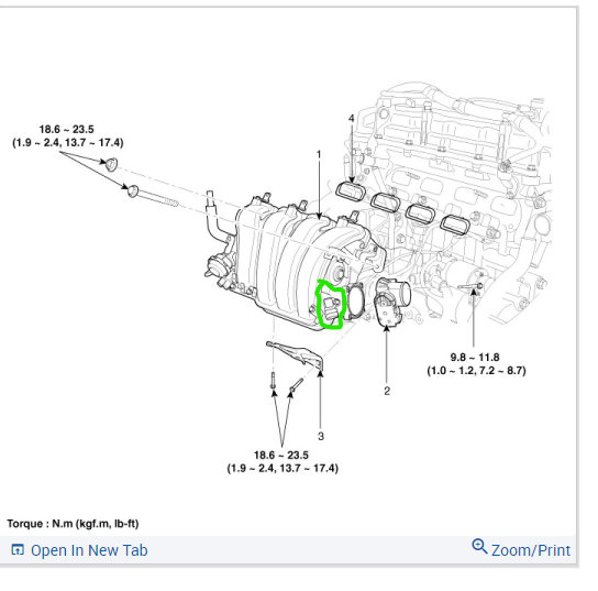

Where is the MAF sensor located?
2012 HYUNDAI SONATA
134,000 MILES • 2.4L • 4 CYL • 2WD • AUTOMATIC
WONDERWEB
There is not a Mass Air Flow sensor located after the air filter and before the throttle body. Where is it located? Thank you

This vehicle doesn't have one, it uses a MAP sensor. Manifold Absolute Air Pressure. It is located on the right side of intake manifold. Here is a picture of your intake manifold and I circled the MAP sensor. It is small and 1 10mm bolt holds it in. I have had no luck trying to clean those. I just replace them.
