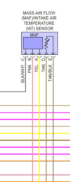

I need a MAF sensor plug wiring diagram for the vehicle listed above VE commodore. The plug I'm using is a GM brand made for a VE. I'm just need a diagram and color coded of which color wires go to where. Please and thanks.
Jun 7, 2022 at 4:24 PM
  • 55,594 POSTS
Yes, here you go. let me know if you need the entire engine wiring diagrams. here are the color wires going to the MAF sensor as you requested. Check out the diagrams (below). Please let us know if you need anything else to get the problem fixed.

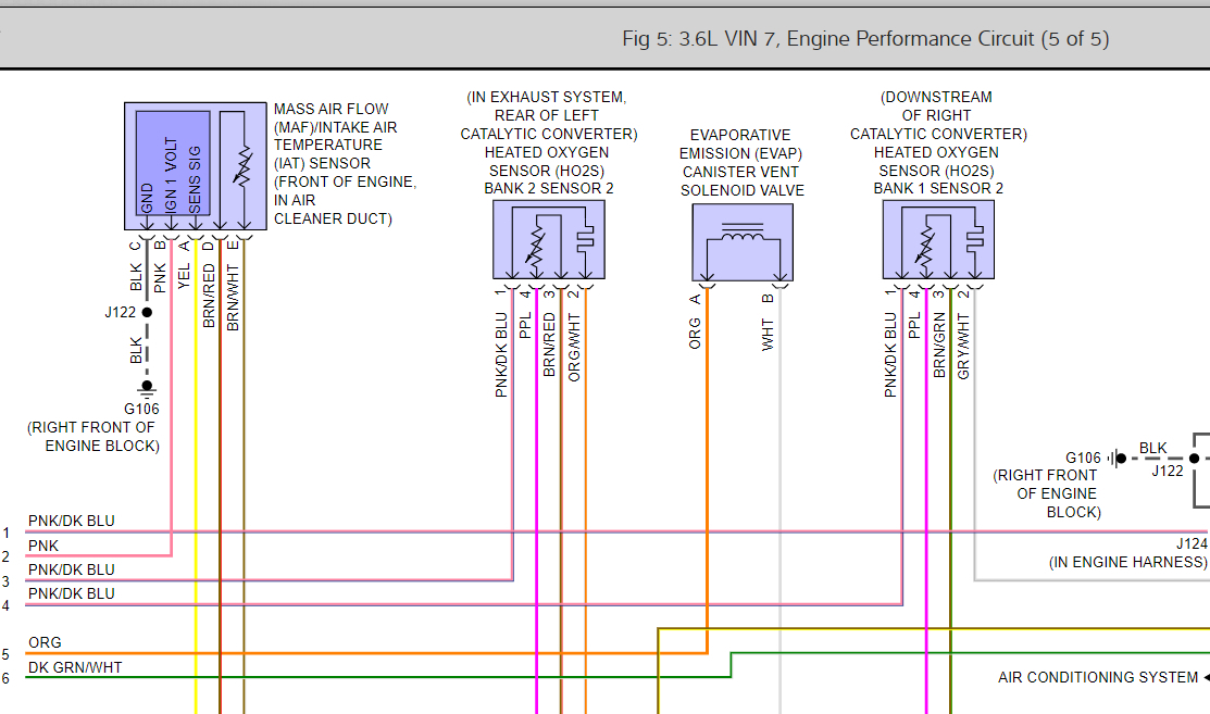

Thanks for the diagram but I don't have these colored wires on my car. The colored wires that are in my car are as follows:
Yellow
Black
Pink
Red/white
Red
Thank you

Hmm, this is what they show. I did find this one though, we only have access to the GM equivalent. Let me know if this works.
