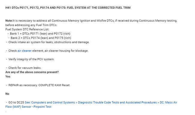

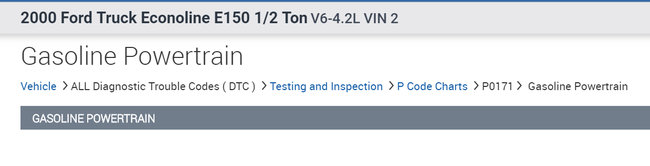

In the diagrams down below I have included the factory diagnostic troubleshooting guide for Direct Trouble Code (DTC) P0171. I see no listing for DTC P1133 listed for your vehicle. If you double check the DTC number for me I will be happy to look it up for you. The guide for DTC P0171 is pretty straight forward. I would definitely check for vacuum leaks. By vacuum leaks, what I mean is any unmetered, or any air leaking into the intake air system after the Mass Air Flow sensor (MAF). A good way to do this is to get a propane torch and crack it open on the lowest setting, making sure not to light it. You just want the propane coming out of it. With the engine running, run the propane torch along the air intake duct, throttle body, intake manifold, vacuum hoses, EVAP hoses, paying special attention to Positive Crankcase Ventilation hoses, EGR inlet, and the intake manifold, both inside the valley and outside. Anywhere there is a leak when the torch passes by it the engine rpm's will pick up as the propane will get sucked into the system. This will take care of this DTC. I have also included a link below for you to go to:

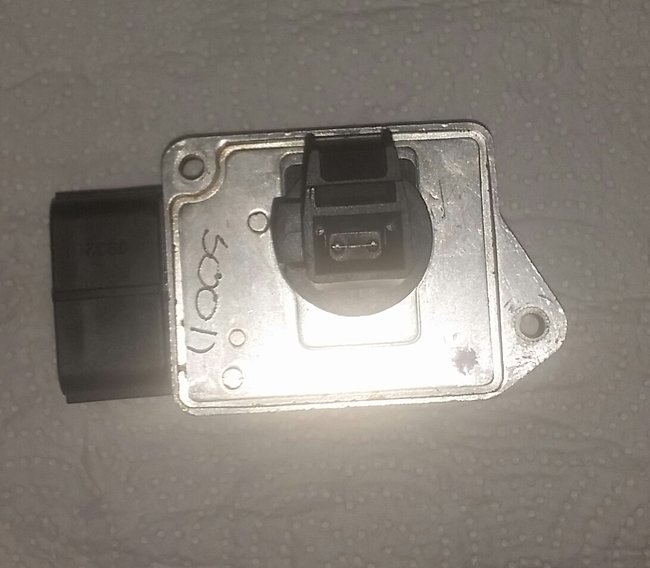

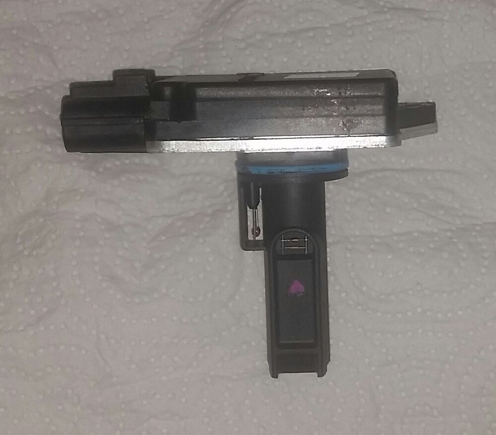

Here's what it looked like the mass air flow sensor we took off ourselves. Plus it was a remanufactured one too. I had a brand new one on there before the repair shop replaced it with this one.

Usually, junk yards or pick n pull places will put red dots on parts that they recycle that are in good working order, so that's nothing to worry about. What you need to worry about on MAF's is the two fine platinum wires. You can purchase MAF cleaner at any auto part store specifically formulated for cleaning these wires. It is manufactured by CRC and dries very quickly so as not to damage these wires. The way a MAF sensor works is these two platinum wires heat up to 500 or so degrees. As the air flows past these wires as it is entering your engine, the wires cool down and more electricity is needed to be added to heat them back up to 500 degrees. The PCM is able to read this electricity and correlates it into the amount of air entering the engine. If there is corrosion, or a bug, or something on the wires, then more electricity is going to added, and the information that the PCM gets will be skewed. Anyway, please keep us informed as to your progress.

Oh, oh okay. I didn't know that. about how the junk yards operate. Thank you for the information Alex on how the mass air flow sensor works too. I have a can of CRC mass air flow cleaner. I had sprayed it on the sensor i posted up there at one time but the error code came back. I drove it today and it ran really good and the service engine soon light is still off where i cleared the codes. (I believe the Lord fixed it for me myself. People laugh at me when i say that. But I believe he did.) The funny thing is i am so used to it being on. It looks funny it being off, lol. Not that i am complaining it being off etc. Well anyway, if anything else comes up i will keep you guys posted. I just wished i had a scan tool that does live data so i could read the computer while it is running good and not producing any error codes.
