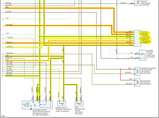

Would this problem be caused by the MAF sensor? It idles perfectly to 2,000 RPMs but when you go beyond its backing from the intake and will not increase in speed.

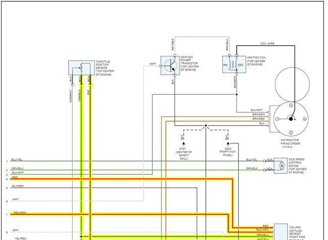

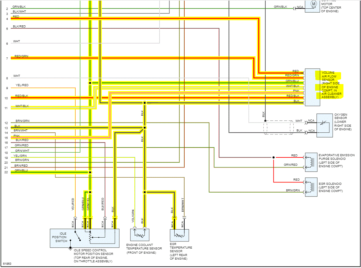

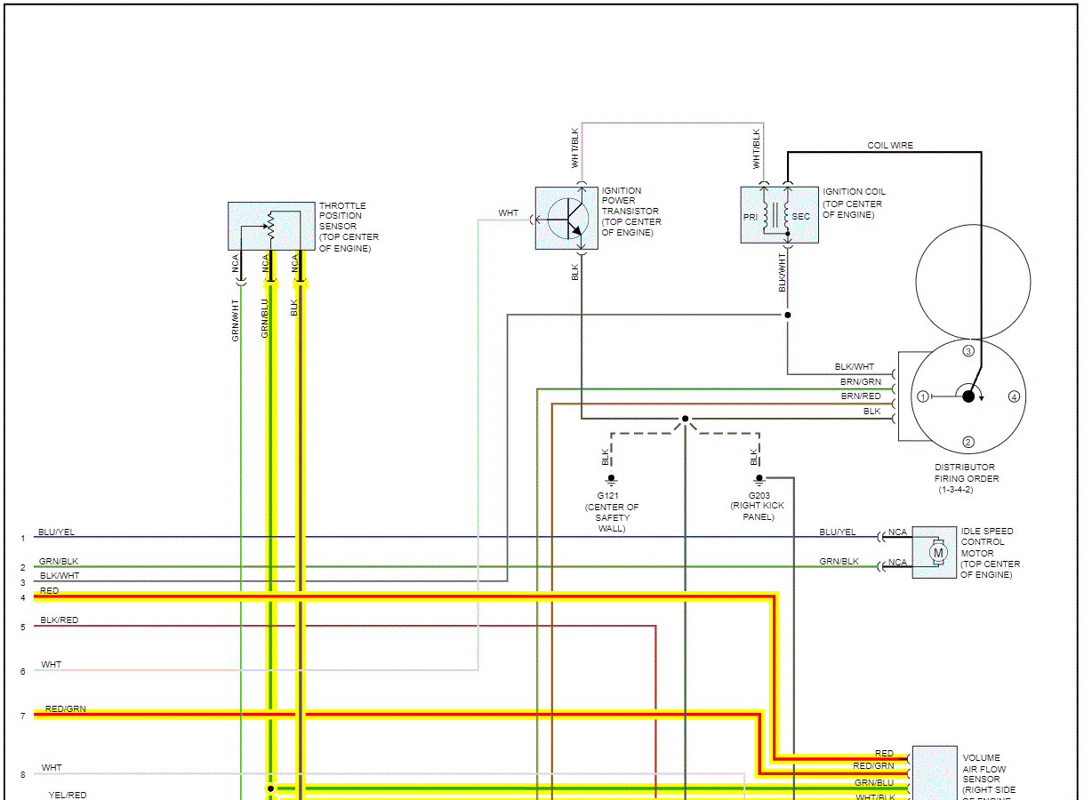

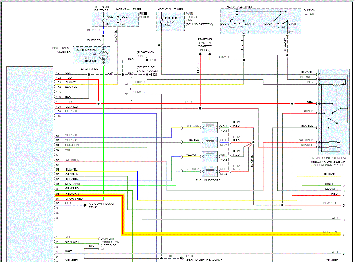

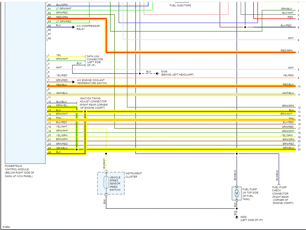

Joe, can you give me the pins on the MAF sensor and where they go? going to check it through the PCM.
Dec 4, 2021 at 1:09 AM
  • 110,194 POSTS
The best I have is the powertrain management schematics. I attached them below. As always, I cut them in half to make them readable for you and overlapped them. Also, I highlighted all wires going to the sensor to hopefully make it easier for you to trace them.
I hope this helps.
Dec 4, 2021 at 7:09 PM
PACIFICISLANDER
  • 239 POSTS
Thank you, it was traceable to the T. I check wire to wire and two of them are broken-no reading. Now I guess I have to pause what I'm doing need to save it isn't that cheap. Thank you, Jacob, you're the man I can communicate for my needs and always there to solve the problem together. Don't know what to do without you. once again Thank you my friend. Merry Christmas.
Dec 4, 2021 at 8:21 PM
