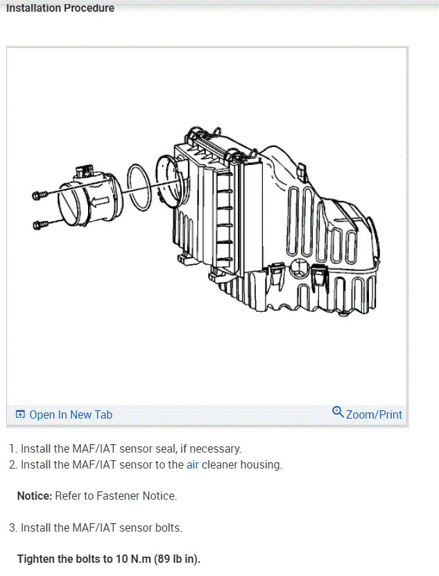

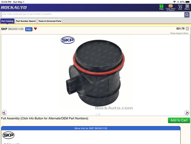

On my MAF sensor and in the picture, it shows sensor with a gasket, but when I call auto part stores, they say it doesn’t have a gasket.
May 1, 2022 at 2:09 AM
  • 110,241 POSTS

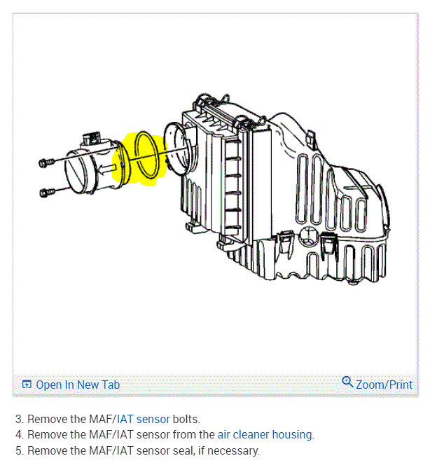

It doesn't have a "gasket" in the sense of a paper gasket, but instead, it has a rubber o-ring.
I'm not sure if they are confusing that with what you are referring to.

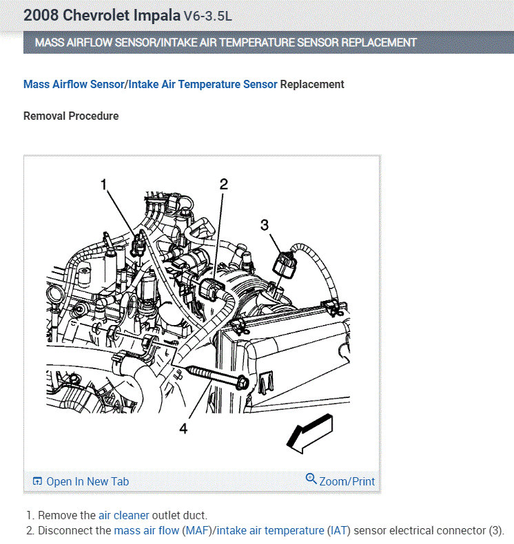

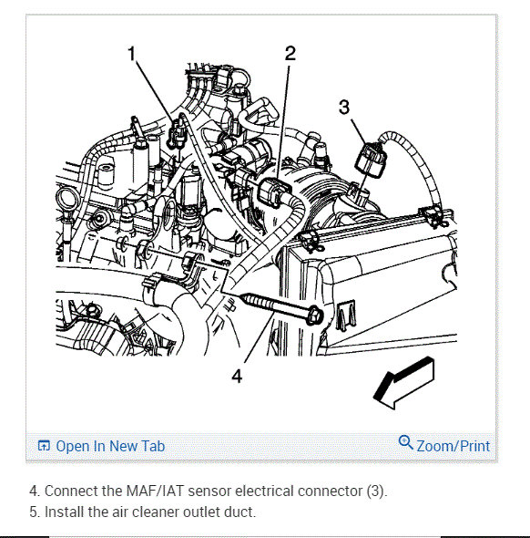

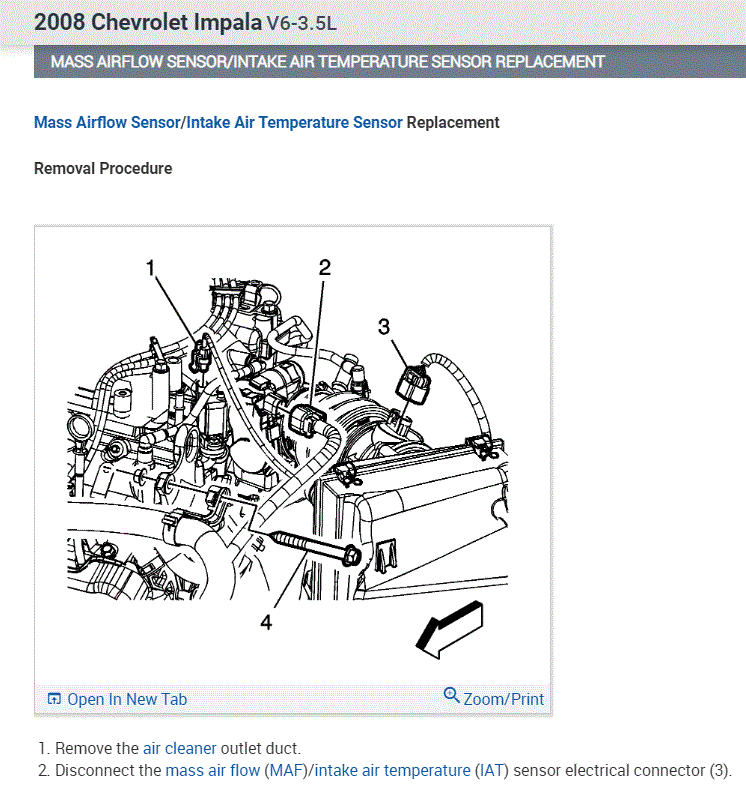

If you look below, I attached the directions for the removal and replacement of the MAF sensor. It indicates there should be an o-ring. Otherwise, there would be an air leak, and the MAF signal would be off.
Keep in mind, the o-ring is likely to stay in the air intake box. Maybe because of that, most new ones don't come with a new o-ring.
The best thing to do is remove your sensor and see if there is one on the MAF or if it is part of the air intake box.
I attached the directions below for you if needed.
