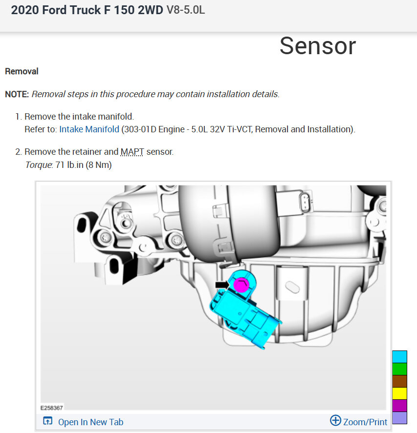

Does the truck listed above XL have a MAF Sensor? Because I can’t seem to find it, and if it does where is it located? They told me at O'Reilly's to check the engine air filter to see if it was dirty. I already checked but it was clean.

This truck does not have a MAF sensor, it has a MAPT sensor, (manifold absolute pressure and temperature sensor) which is located at the center rear of the intake manifold. Check out the images (below). Let us know if you need anything else.
