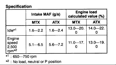

What MAF sensor should read g/s please? key on engine off.

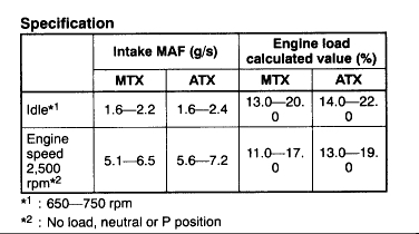

Thank you for using 2carpros.com. Here are the directions for testing and specification. Please note that the sensor should be checked when the engine is running to determine proper specifications. See last picture for specification information. Additionally, you will need a live data scanner.

If the MAF sensor PID value or PCM terminal 88 voltage are out of specification, carry out the "Circuit Open/Short Inspection".

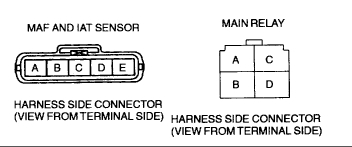

Open circuit
MAF signal circuit (MAF sensor connector terminal C and PCM connector terminal 88)
Power circuit (MAF sensor connector terminal A and main relay terminal D through common connector)
GND circuit (MAF sensor connector terminal B and PCM connector terminal 77 through common connector)

MAF signal circuit (MAF sensor connector terminal C and PCM connector terminal 88 to GND)
Power circuit (MAF sensor connector terminal A and main relay terminal D through common connector to GND)

NOTE: The If you have a scan too, it should show the MAF rate and load value. Please refer to the last picture which shows specifications.
Let me know if this helps.
