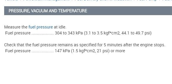

First, the code you listed indicates a lean fuel mixture. Can the MAF or other things you replaced cause it? Yes. However, many other things can too. First, I would like to suggest checking the following; fuel pump pressure and the engine for a vacuum leak. A vacuum leak allows unmetered air to enter the engine. The result is not enough fuel and too much air which creates a lean mixture. Also, although the pump is new, fuel pressure could be low. If that is the case, it will cause a lean mixture. Here are two links which describe how to check both. Both of these tests require basic tooling. If you do not have the needed items, and most people do not, most parts stores will lend them to you, such as the AutoZone that gave you the code.

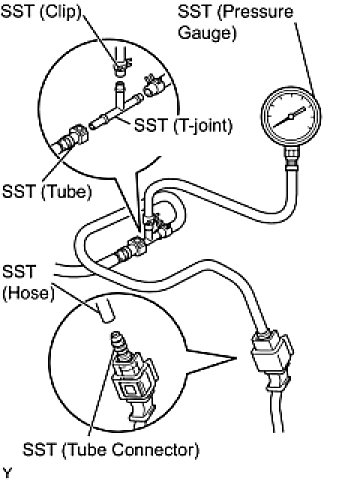

Here are directions for checking fuel pump pressure specific to your vehicle. Pictures 3 and 4 correlate with these directions.

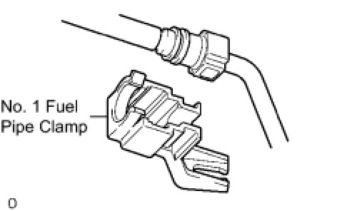

(d)Remove the No. 1 fuel pipe clamp from the fuel tube connector.
(e)Disconnect the fuel hose from the fuel main tube.

(f)Install SST (pressure gauge) and the fuel tube connector using SST as shown in the illustration.
SST: 09268-31012
09268-41500
90467-13001
95336-08070
SST: 09268-45014
09268-41200
09268-41220
09268-41250
(g)Wipe up any gasoline.

(o)Measure the fuel pressure at idle.
Fuel pressure:
304 to 343 kPa (3.1 to 3.5 kgf/cm2, 44.1 to 49.7 psi)
(p)Stop the engine.
(q)Check that the fuel pressure remains as specified for 5 minutes after the engine has stopped.
Fuel pressure:
147 kPa (1.5 kgf/cm2, 21 psi) or more
If the pressure is not as specified, check the fuel pump, pressure regulator and/or injectors.

(t)Install the No. 1 fuel pipe clamp to the fuel tube connector.

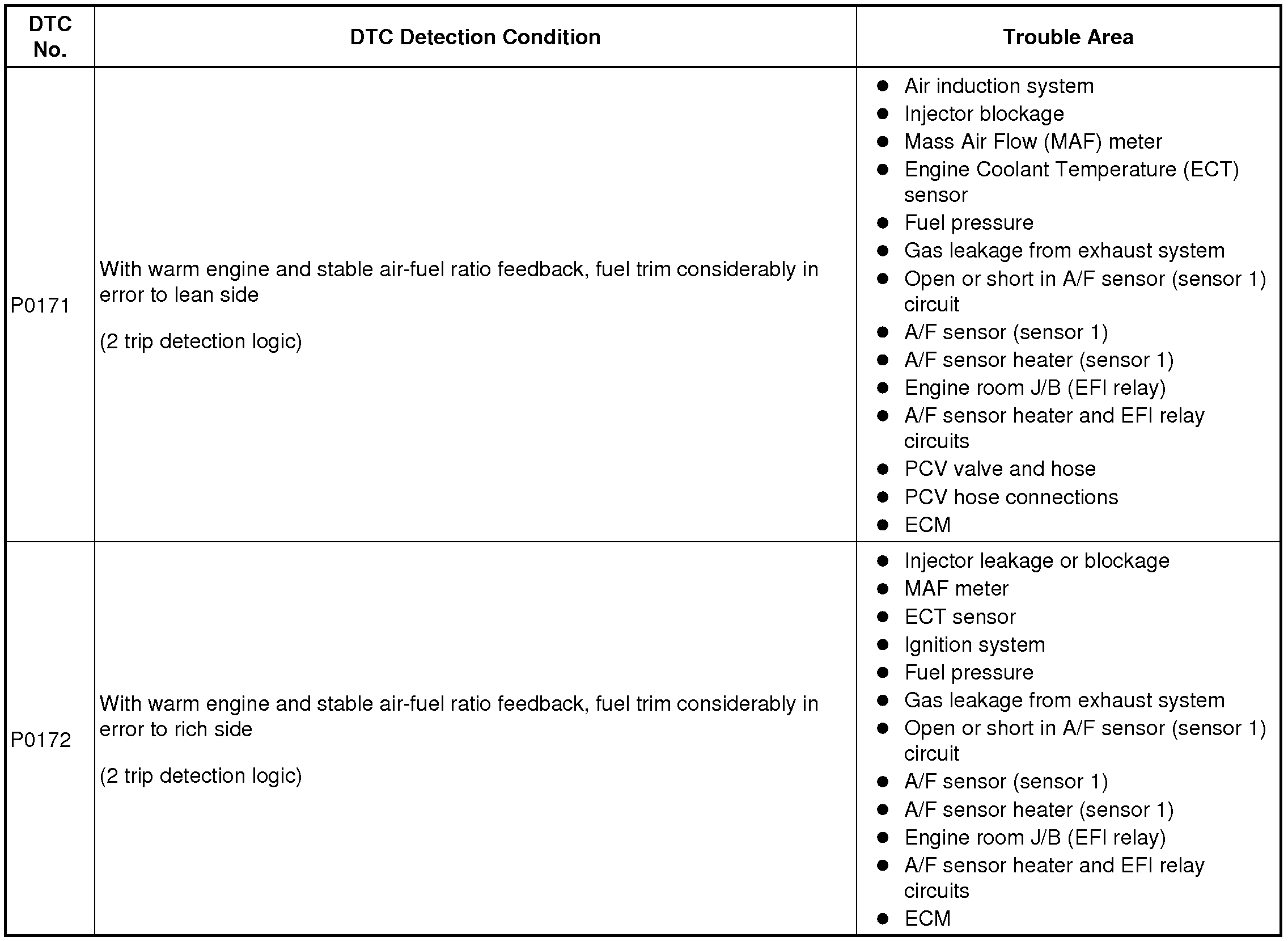

I have attached a picture with the list of possible problems which could lead the the code you are dealing with. Take a look through the possible causes. You will notice things such as the air induction tube, PCV hose... These are all components which could simply not be fitted correctly, torn, loose... allowing unmetered air to enter the engine.
Picture 2 includes the manufacturer's specifications for fuel pressure.
Take a look through the items I mentioned as well as the picture I attached. Let me know if you have questions, need help, or if you require additional information. One last thought, if the dealer and other mechanic did not require at least 1.5 hours to check the vehicle, they could not have gone through the diagnostic checks for this code.
