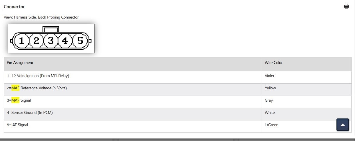

MAF pigtail connector wiring diagram
2014 MITSUBISHI OUTLANDER SPORT
70,000 MILES • 2.0L • 4 CYL • 2WD • AUTOMATIC
BRENNA KIRWAN
Wires came undone need the diagram to know which order to repair.

Please see the attached image. It contains the information that you are looking for. Let us know how it goes.
May 2, 2018 at 8:40 PM
BRENNA KIRWAN
Only way it would work was cut the connector completely off and stick the wires individually to the pins inside the sensor using superglue and two framing nails. No stores in LA sell the part and the only place I found it where it was able to be ordered it was $105.00 just for the connector. I guess I will just have to keep it rigged up like this for a while. Thanks for the help.

Well at least you got it going. I would suggest checking with local junkyards and u-pull-it places. You might get lucky and find your car there and be able to pull what you need for cheap.
