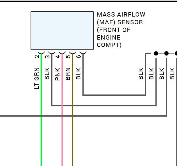

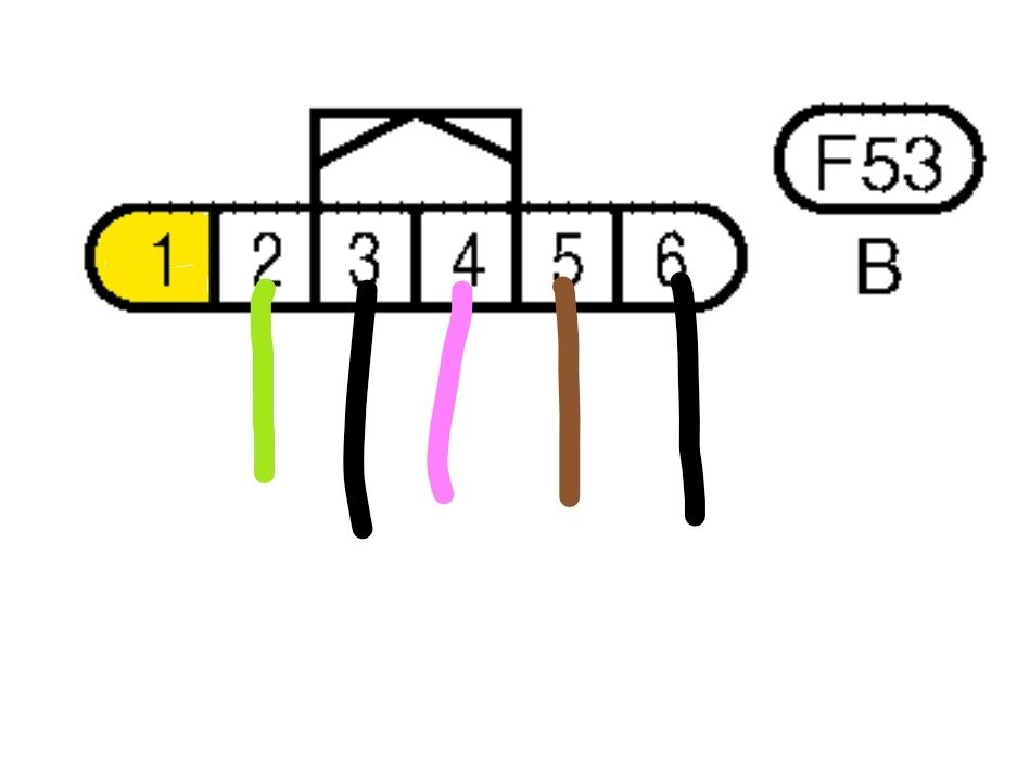

i have pink brown green and two black wires coming from the wiring harness my connector that I bought has all five black wires how do I know what to connect to where please help
Jan 21, 2026 at 11:40 AM
STEVE W.
  • 15,419 POSTS
That is common with replacement pigtails as it allows them to fit multiple makes and models. The easiest way is simple matching. Verify that the new pigtail fits the MAF sensor. Now look at the old connector and orient them both the same way. With the clip on the same side. Now pick a wire on the old connector and match it to the same pin in the new connector. Pin one has nothing, pin 2 is green, pin 3 is black, pin 4 is pink, pin 5 is brown and pin 6 is black. The two black wires go to the same connection. The connector or the MAF should have the numbers on them.
