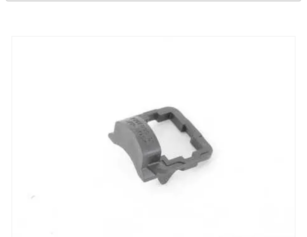

All is good still but I noticed there is a slip to hold the air charge temperature sensor that broke while I put it in. Can you find for me if this is a piece that can be purchased? It basically just holds the sensor onto the pipe and keeps sensor in place
Thursday, May 19th, 2022 AT 6:54 AM
Can you get a picture of the piece that you are looking for? I am only showing that the sensor is held in by two screws. Must be the wrong one.
Thursday, May 19th, 2022 AT 9:24 AM
DIVIDES
  • 898 POSTS
No screws, the air charge sensor is in the aluminum pipe on the passenger side. The pipe starts at throttle body as a hose then connects to this pipe via a plastic connector. I think I found it online. Called BMW twist protection part # 11617807095.
Thursday, May 19th, 2022 AT 9:49 AM
Got it. Yep. That looks like it. Thanks for adding that detail.
