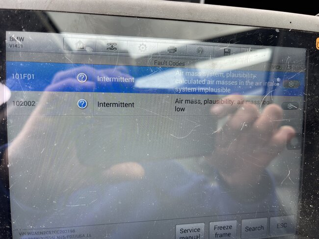

Starts okay, but the RPMs fluctuates at times, have this code. Is that usually an indication it's a bad MAF?
Image (Click to enlarge)
Nov 16, 2023 at 2:39 AM
Experienced Mechanic
110,248 POSTS
The code usually indicates a failed or dirty MAF. Also, keep in mind there could be a corrosion issue or loose wire at the MAF.
Try cleaning it first to see if it helps.
Here is a link that explains how it's done:
https://www.2carpros.com/articles/mass-air-flow-service
Try this and let me know the results. Also, confirm the connector is tight, clean, and undamaged.
