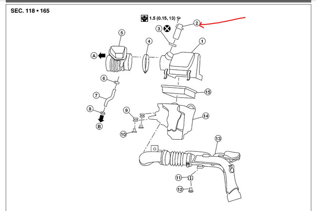

So, I took my car to a shop, and they added mass air flow cleaner to my car...while running...while revving the engine 3000x now my car feels like it wants to turn off.

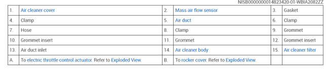

Yep, they might have made the sensor go bad because cleaner can ruin the MAF sensor, or they left an intake tube off. Here is the set up for the MAF sensor so you can check it out and replace the sensor if needed. Please let us know what you find. Check out the images (below).
