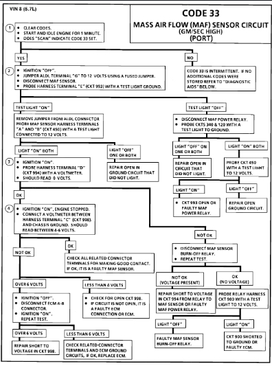

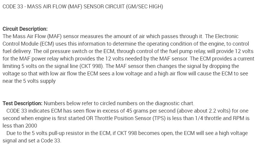

Thanks for responding.its a 1987 Corvette TPI so it's not obd2 The 36 code is gone and it'now flashes a 33 code on screen after I jumper the connector under dash.its saying the MaF signal is high! Too much air for engine.I checked TPS and IAC both are in range.Like I said it doesn't throw code till I run or drive the car about 5 miles or 5 min then car boggs out a little as I increase speed.

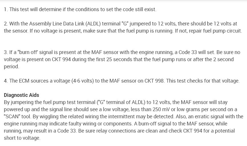

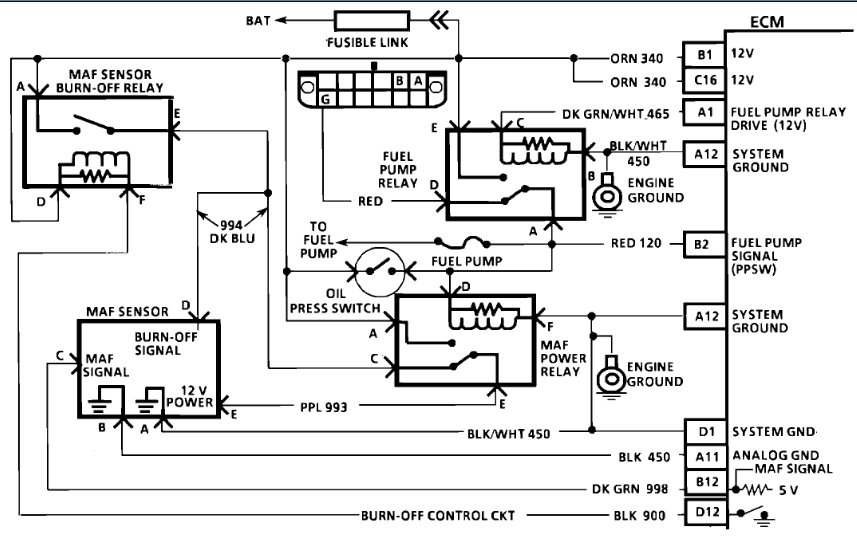

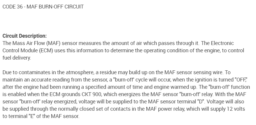

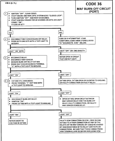

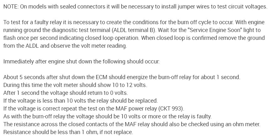

Hello, I'm Danny.

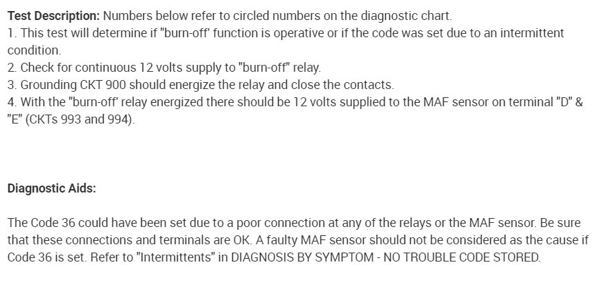

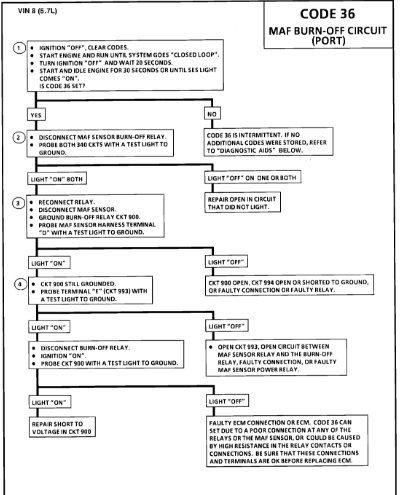

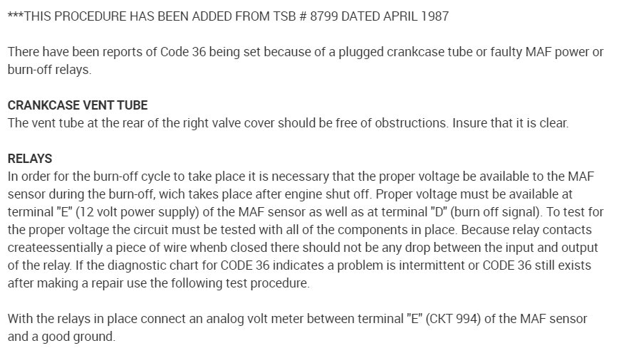

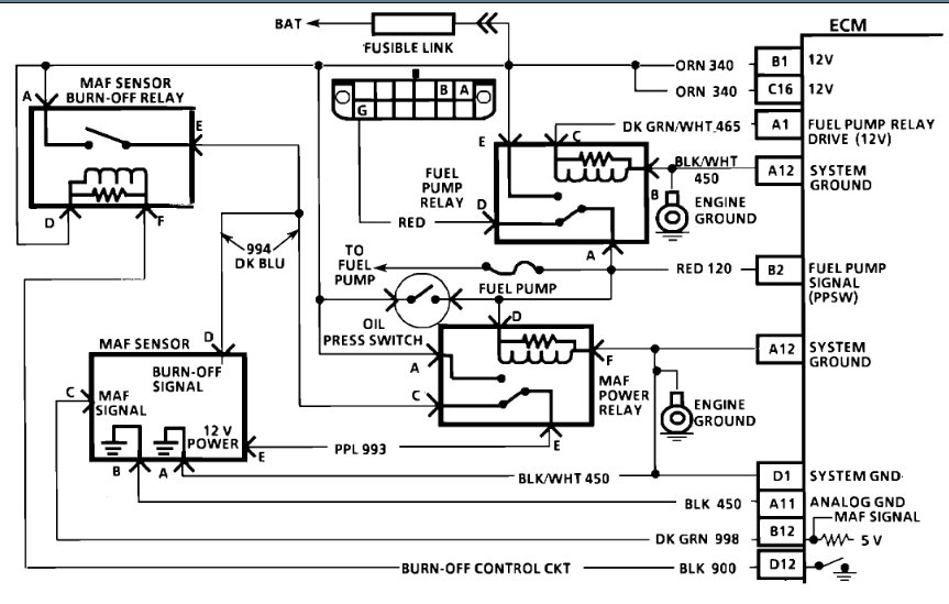

Just to add my 2 cents I've attached a bunch of picture flow charts and info to help you with code 36 and 33 diagnosis.Hope this helps and keep us updated.Thanks again for using 2CarPros.

Hello again.
It's not good to have holes in the boot at all.It might throw off the sensor like it being an air leak.I would suggest using the diagnostic chart to run down code 36 I posted earlier.Keep us updated as to what you find.Let me know if you have any further questions about this.Hope this helps and thanks again for using 2CarPros.

  • 36 POSTS
Code 36 is burn of relay circuit not working.
I haven't figured out why this is happening. I just replaced the two MAF relays! Power relay and burn off .

DANNY L
  • 5,648 POSTS
Hello again.
Okay, then it must be a wiring issue.Since you replaced the relays there must be an issue in the wiring like a short,open or ground issue in the circuit.The flowchart I've attached in the prior post shows you how to test and the wiring diagram was attached as well.Unfortunately this wasn't just a swap out relay to fix issue.Keep me updated and let me know if you have any other questions about this.Keep me updated.
