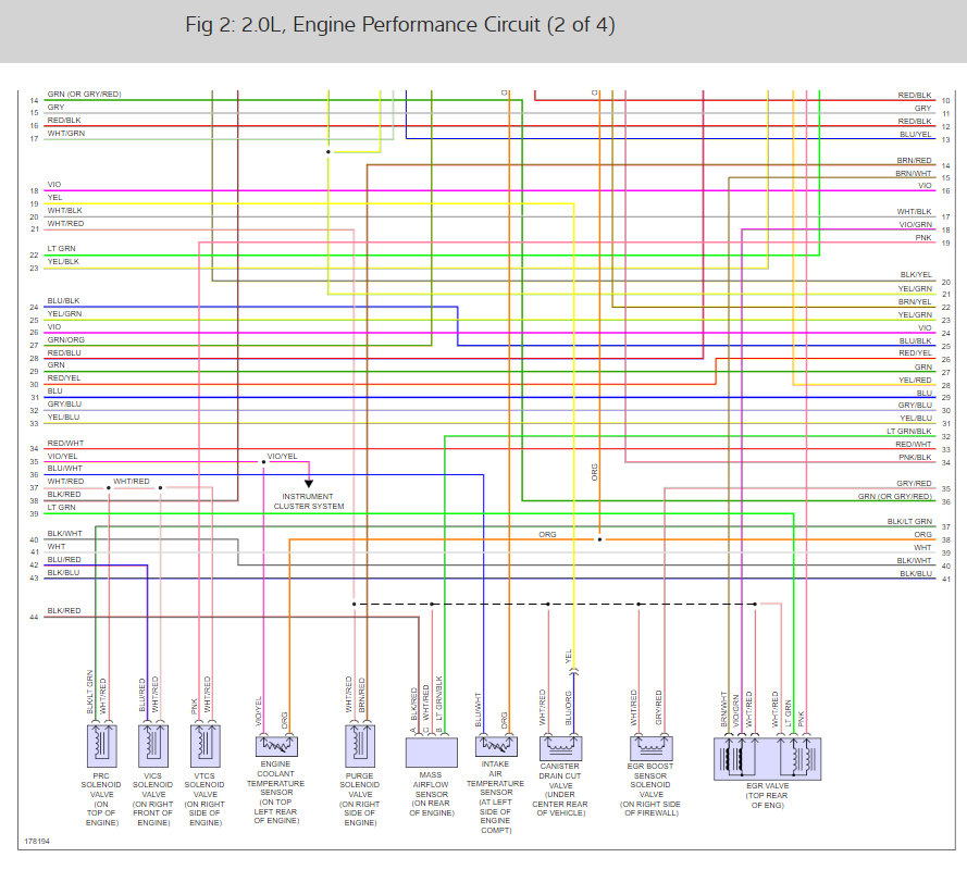

My MAF signal wire is not getting voltage 0-5 volts.
I have good ground to MAF
i have good 12 volts power source to MAF
iv replaced the MAF just to see if it would change anything.
i have traced every wire back to ECU, more than twenty times to check for frayed wires, but for some reason the signal wire does not fluctuate from 0-5 volts when rpm's are raised. Could this be a problem in my ECU? everything else works just fine.

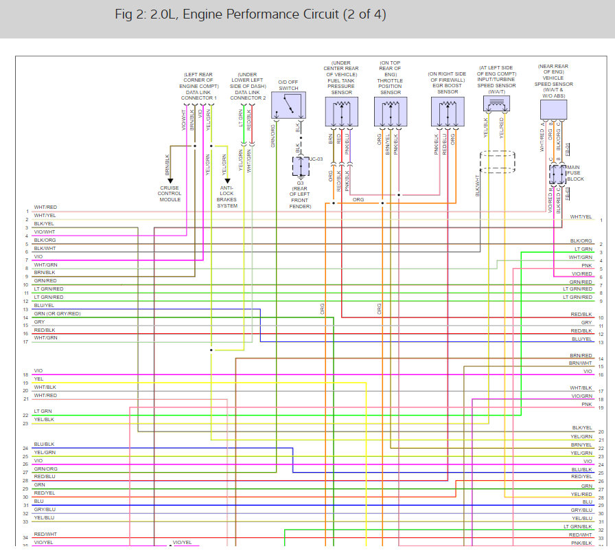

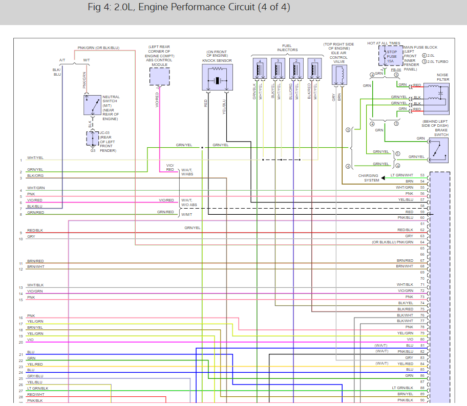

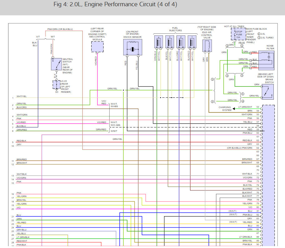

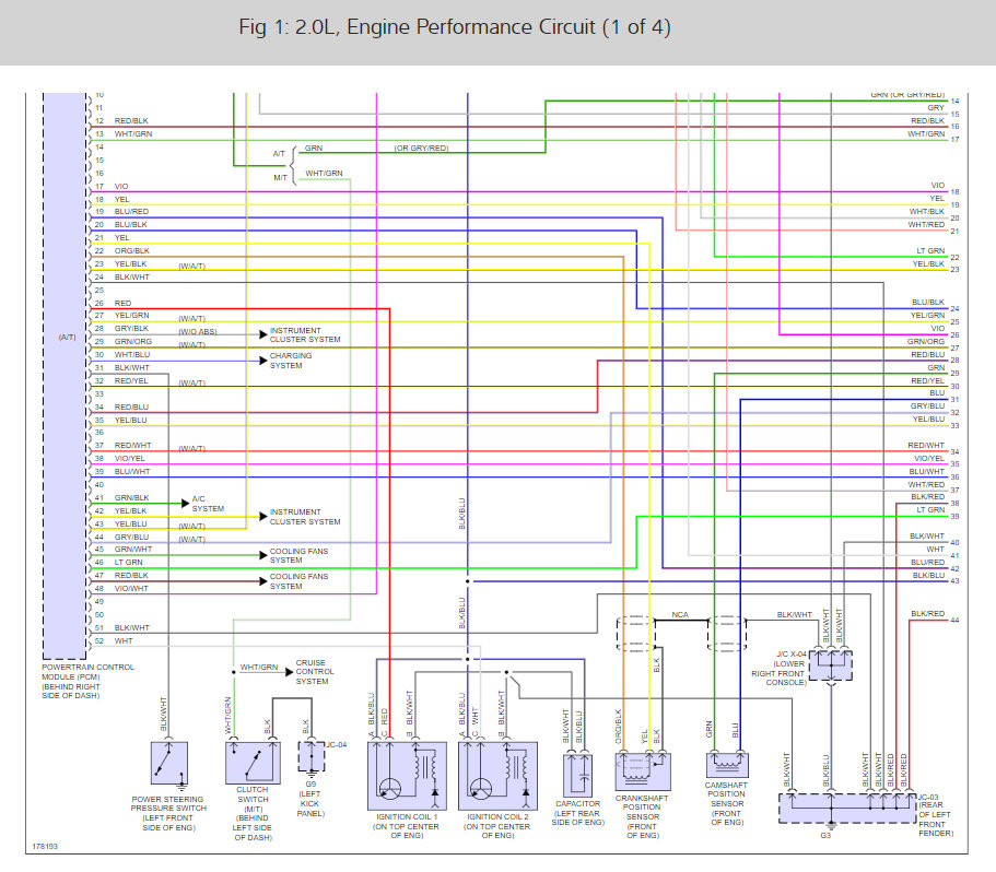

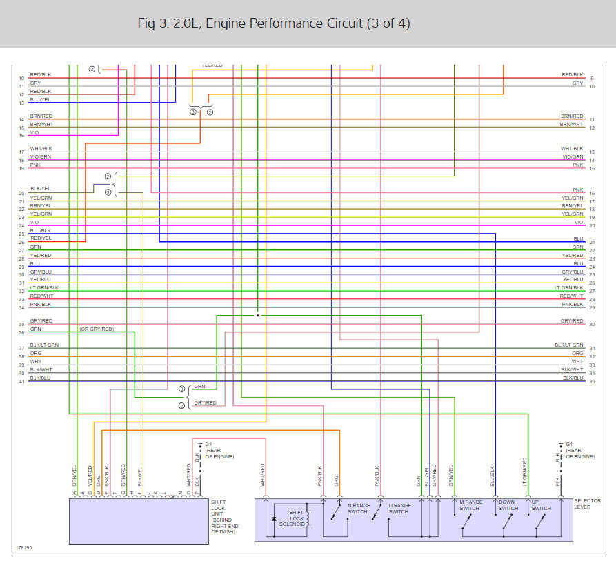

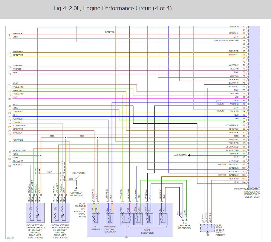

This sensor only gets power 12 volts, ground and feedback data to the computer. Here are the engine wiring diagrams so you can see what going on and how the system works and a guide on how to check the wiring
Have you checked the diagnostic fault codes?
Check out the diagrams (Below). Please run this test and get back to us.

I know it can be a problem knowing if the meter's probe made contact with the terminal when you back-probe through the weather-pack seal, but if you get any voltage reading other than 0.0, you know you are in there.
What you are using is not a scanner. You have a code reader. Professionals use scanners that cost between about $1000.00 and $3,000.00. You might find one at an auto parts store that rents or borrows tools. You can also find some inexpensive models on eBay that will do what you need for under $100.00. Be aware that those I have tried do provide sensor data, but the screens only have three or four lines of data, and they take as much as five seconds to update. Rapidly-occurring glitches and changes will be missed. These also do not have a record function which is useful when watching for intermittent problems on a test-drive.
The first thing I would suspect on yours is the power supply terminal is stretched in the connector body. That will cause the signal voltage to be always below the threshold at which it sets code 102. If your engine uses a MAP sensor too, it may be running in back-up mode off that sensor.
There is something else you can do to help me help you. Unplug the MAF sensor, turn the ignition switch on, then read the voltage on the signal wire. That is going to be either 0.2 volts or 5.0 volts. I will explain later what I am after when I am done fighting with this miserable computer!

Going further without a scanner is going to be difficult. Also, I do not know if your signal voltage is supposed to go up toward 4.5 volts or down toward 0.5 volts when engine speed increases. Most MAP sensors' voltages go down as vacuum goes up, but that is not relevant to this sad story. On top of that, the service manual only says the scanner will list MAF as grams per second, and that it should go up with increased engine speed. I know what a volt is.
Normally professionals do these electrical tests before condemning a sensor, like you did, then they order one if appropriate, like you did. This is one of those frustrating times when proper procedure didn't yield the expected results. Assuming we can trust the sensor is good, you might consider unplugging it, then using four jumper wires to connect the wires to the sensor. If you still get 0.5 volts on the signal wire, pop that signal jumper wire off, then measure right on the sensor's terminal. If the voltage comes up to normal while the engine is running, suspect that signal wire is grounded. The 0.5 volts you found can be explained by the meter picking up magnetic interference. You can prove that to yourself too by just setting the meter on the running engine without the probes connected to anything.

But i have pretty much ruled out the terminal connection problem by disconnecting the ecu and using a used nine volt battery (only about three volts left on it) to put power to the harness and using a multi-meter to check the unplugged connector On the other end by MAF. So the connection seems to be okay.
But the new MAF I bought while connected and back probing the signal wire reads only 0.8- 0.9 volts while running and raising RPM. It doesn't change. And the Actron scanner I have gives me a low signal code and I have a monitoring feature on the scanner and it reads 0.00(GR/SEC) for MAF.
So I installed the original one I took off that was also giving me trouble. And it gives me a code that signal is too high. Which I tested the same way by back probing and I get a high reading of around (11.34 volts) which is way to high. And I forgot to check the monitoring feature.if that would help you. I can check tomorrow with the old one again. But it is obviously bad if its reading that high of a voltage correct? So maybe the new one I bought is bad also or could have got shorted out somehow.

I got confused with the chain of events as to the various voltage readings, but I am getting the feeling there is a high resistance in a wire based on your two extreme voltages. One is maximum low and one is maximum high, and there is no in between. That is the kind of thing we'd see when measuring a wire that is open circuit at the end vs. one we are trying to draw current through an unwanted resistance. I wish I could be there to look over your shoulder. Instead of using a wimpy 3 volts, either apply 12 volts and use a test light, even a head light bulb, or measure the wire's resistance with an ohm meter.
