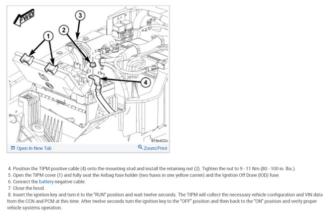

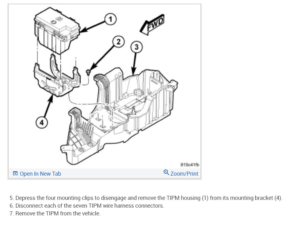

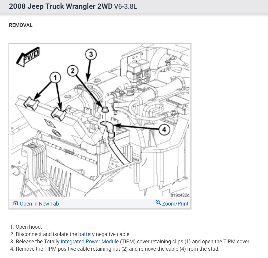

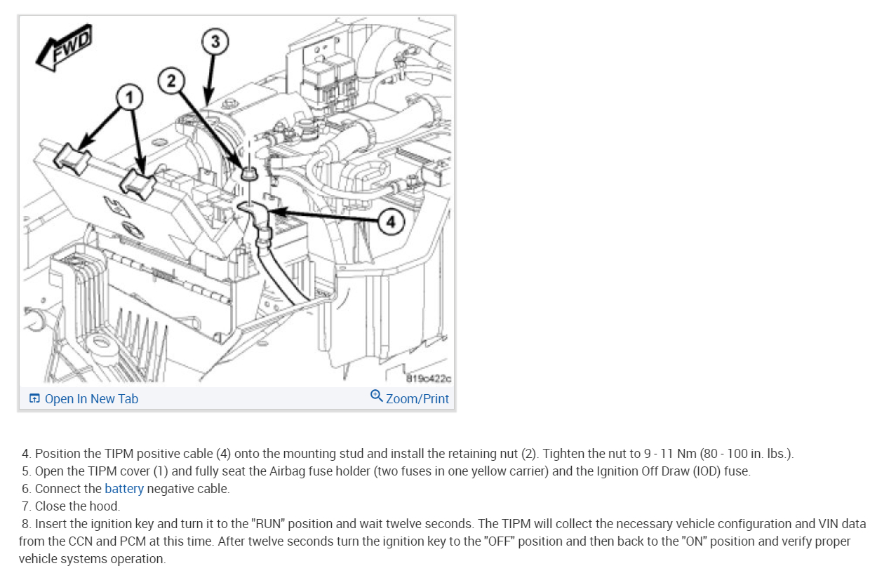

It looks like the fuse #m38 goes directly to the PCM see the images below so I would say the TIPM is going out which is common. Here are the instructions to change it out which is easy to do because to self learns. Check out the images (below). Please let us know if you need anything else to get the problem fixed.
