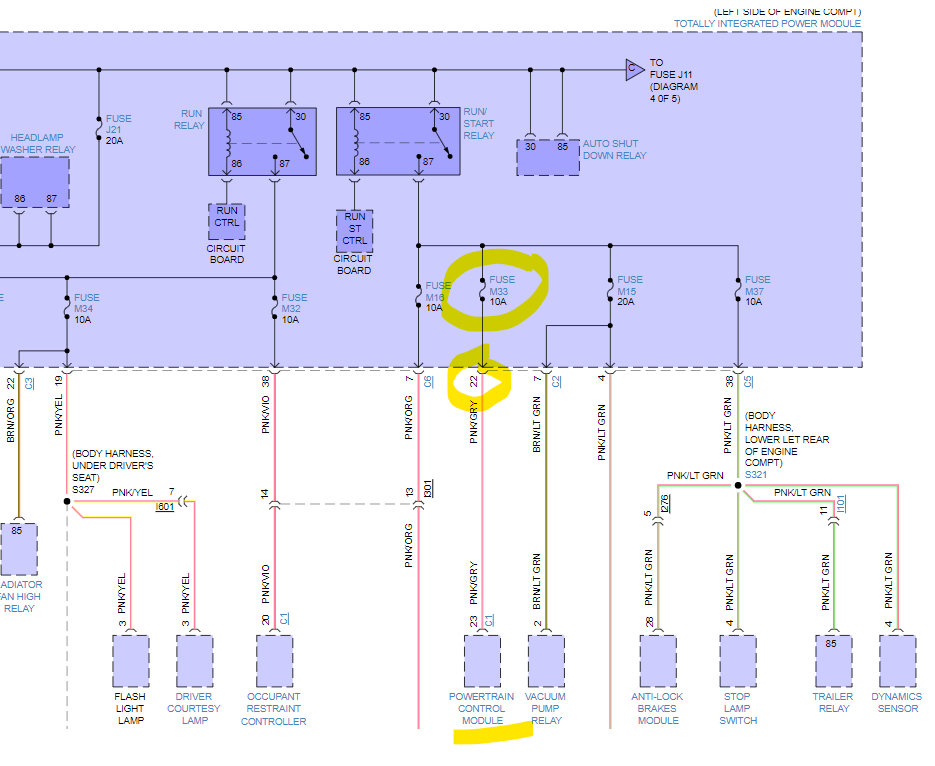

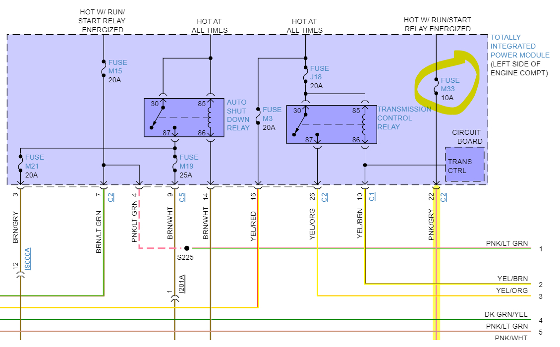

Hi, I am looking for a wire connected to TIPM fuse M33 (10 A). Please explain in which connector 1-7 the wire sits and what is the exact color of it for a precise location. That would be much appreciated. Regards, Ralphi

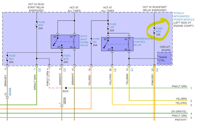

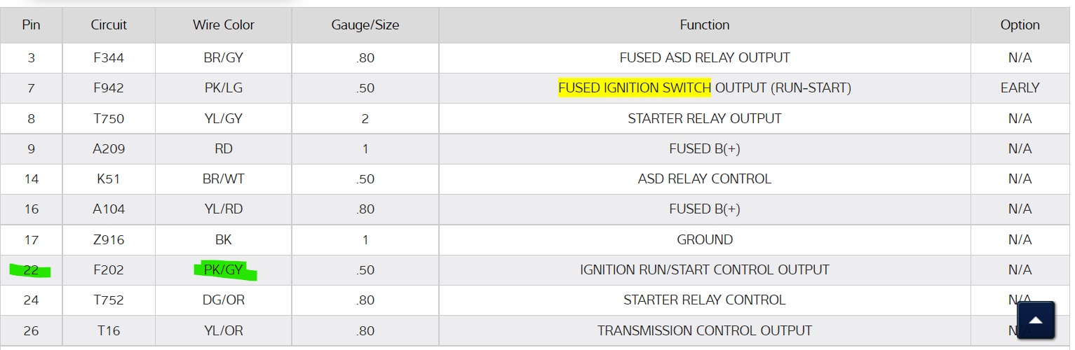

Fuse M33 looks like Ignition Run/Start Control Output 10amp, if there is a label on the fuse box does that sound correct? Pink/grey wire running to the ECM.

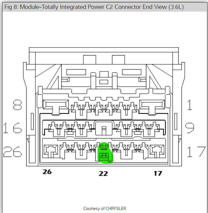

It is Connector C2(D3830B) Pin#22 of the TIPM

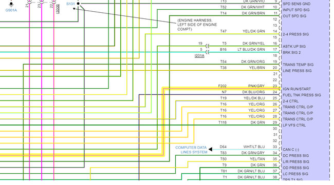

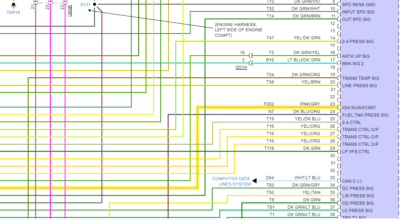

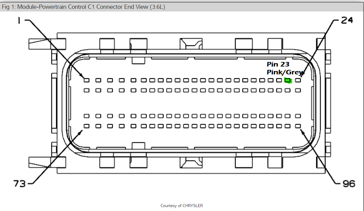

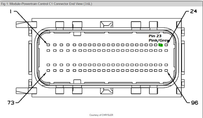

ECM connector C1 pin#23 (4th diagram).
