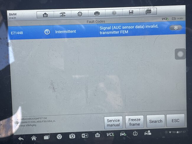

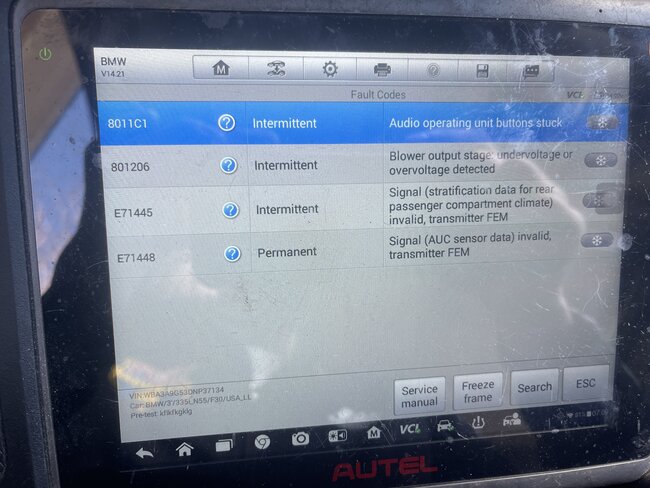

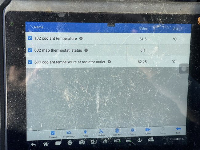

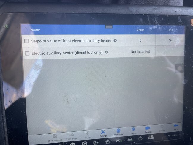

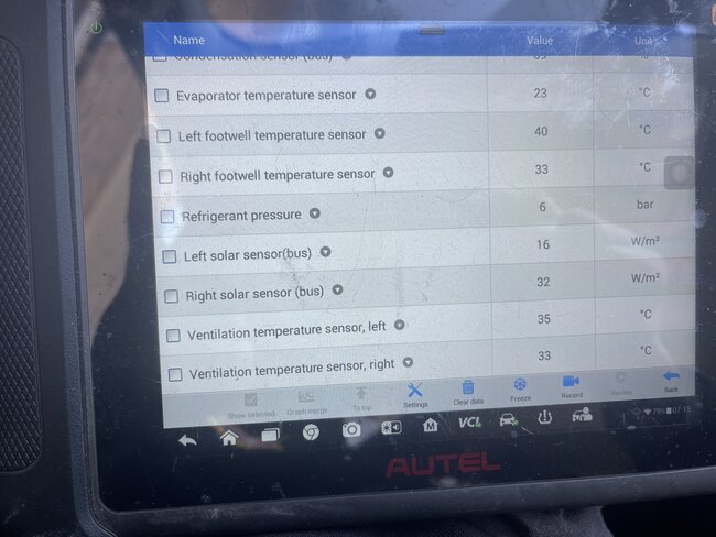

Takes forever to get some lukewarm to come out. Blower works fine; these are the codes I found. When I deleted them, I got one back which is in the picture that only shows one code (AUC). Can this affect heat? Coolant is full. I thought about the heater control valve, but I have not seen it on the driver side under the hood like most BMWs. Can you ee if there is one and where it is? Hoses to the firewall I would say are warm. I also suspect the thermostat but no codes or indications.

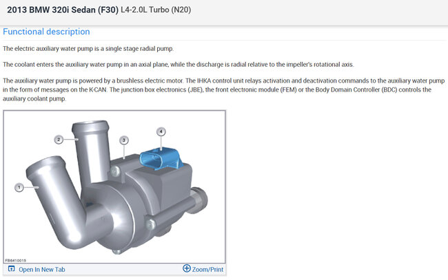

Does the engine get hot? If not, I would check the thermostat, but I can tell you the auxiliary water pump for the heater goes out all the time for these cars. You can remove it and put 12 volts to it and if it doesn't work, I would replace it, also check the fuse for it as well. Check out the images (below). Please let us know what happens.

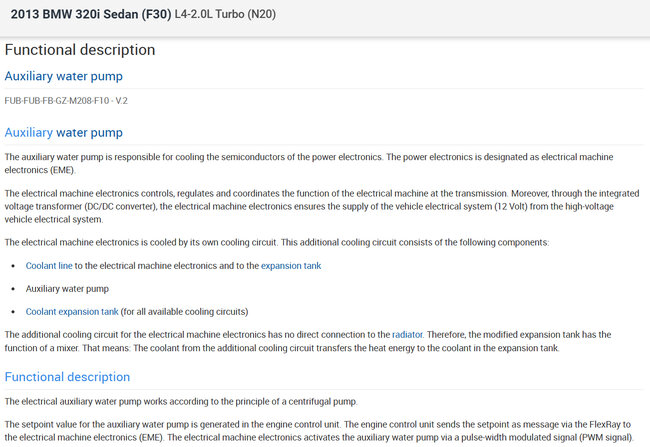

This says bye E92, his is the F30, the newer style. And the pictures talk about the fuel lines or filter. Where is the auxiliary pump located?

Okay, my bad, here is the auxiliary water pump which can be either one, follow the heater hoses and you should be able to find it, they don't show the location. I updated the images above.

Can you let me know if the F30 335i has an auxiliary pump and where it is? The above is for the E92

I updated the images above. Did you see them?

One of the images you updated above is for a 4-cylinder, this is a 6-cylinder turbo. Heater hoses, one goes to a thermostat the other to the radiator.

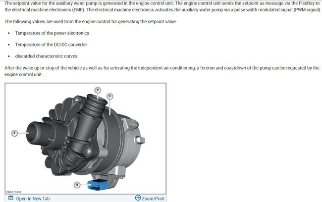

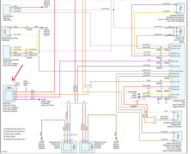

Maybe some one removed it? It says it is at the rear of the engine compartment. Check out the images (below). Please let us know what happens.

That's the coolant pump. I verified with someone that only the M package has the aux pump behind the headlight. So am now just looking for where this heater control valve is. Strange hoses to connect to upper radiator and one to thermostat.

My information says it does not have a heater control valve?
