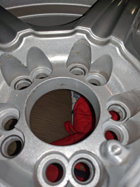

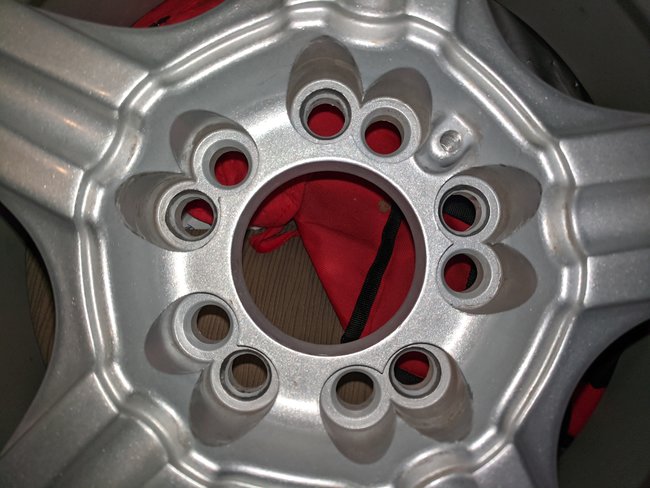

Here's the pics.

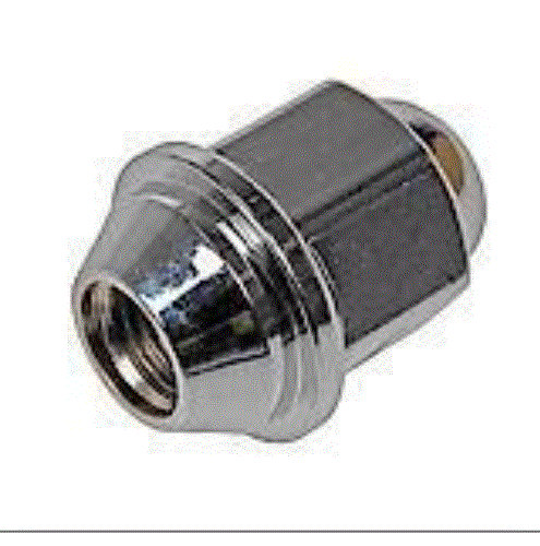

The wheels look like they would take a standard tapered type lug nut.
I attached a pic below. Tell me if that is what you already have and why it won't fit. Looking at the wheel, it appears it should fit.

They wouldn't take a mag nut with a washer? The studs are still the same as I had on it.

What happens is the lug nut doesn't fit through the opening and therefore can't be tightened all the way and there is play in the wheel.

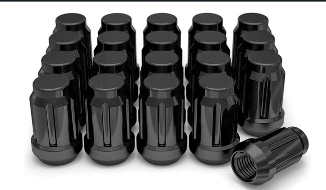

Have you contacted the seller to see what they recommend? They make different lugs that have a smaller outside diameter, but I don't want to tell you something and be wrong.
Take a look at the attached pic. It shows one with a smaller diameter, but it is a locking type. It requires a special tool to install and remove it (tighten and loosen).
