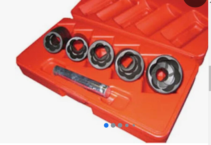

I've got locking lug nuts and I can't for the life of me find a key to fit it. Hoping you can help me figure out which key will work so I don't go wasting money on em for em to not work.

Hi Jenn,
Each key is manufactured specifically for the Lugnut. To find a specific key, you would need to know the manufacturer of the locks and the part number of them. Other than that, I know they make what is called a master locking lug nut key set
If you are unable to locate the correct key, the only solution I know of is to use a socket designed to remove rounded bolts. I attached a pic below of what they look like. Keep in mind, the socket will damage the lug nut, but it will remove it.
Take care.,
See pic below.
