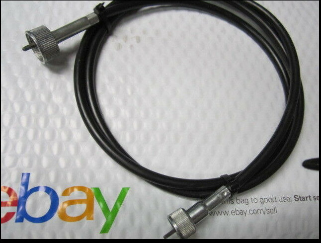

Hi, I have owned my car for 42 years. I need to know how to lubricate the cable once removed from the outer casing. I have a 1/2 oz tube of graphite. How do i make 1/2 oz of oil work on 70 inches of cable? I had recent back surgery and really trying not to remove the outer casing also. I know it's messy to work with. I removed the inner cable at the head. It's not shiny and didn't bind when removed. Just dry (needle jumping). Can i put it in a zip lock bag then feed it in? I have seen graphite spray also. Is that the same? My last thought is. Can i use a fine layer of synthetic wheel bearing grease? I know not to grease within 6 inches from the speedometer head. I have always replaced the cable as one piece. 40 years working on cars I have never done this. The new parts are such garbage! Thanks, any help/advice is appreciated. Have a great day and stay healthy. Neil

Yes, i bought the AGS Kable-lube. My speedometer head itself is not the problem. The problem is with the inner cable and outer casing. AKA, the speedometer cable. It's dry and needs lube. I took cable off the speedometer and removed the inner cable. It's 70 inches long. How does 1/2 oz of graphite oil lube that much? What is the best way to do it? I had recent back surgery and this was easier then removing/replacing the whole assembly I hope that explains my dilemma. That is why i asked about putting the cable and oil in a plastic bag 1st before feeding it back into the outer casing. Thanks
Jan 21, 2022 at 11:03 AM
Oh. I see. You took the cable itself apart. Then yes, I would do the plastic bag method and then put it back in the out "casing."
Never did it that way so I understand what you are saying, and I can't think of another way that would be better.
Maybe using rubber gloves and just put a little in your palm and start running the cable through your hand? The rubber glove will keep it from drying out too quickly like your hand would, but the plastic bag is going to do the same thing.
I would continue with what you were doing and see how it works out.
