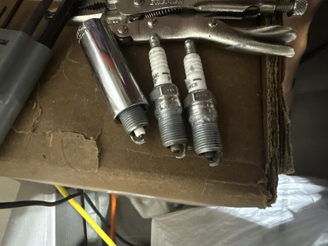

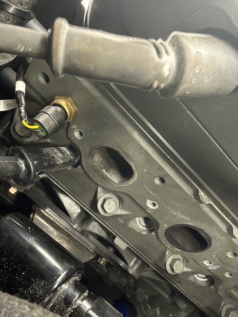

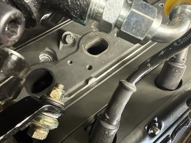

La swap on my 1955 bel air . I followed 2carpros how to rebuilt 5.3 & LS swap vids. I attached three photos - cylinder exhaust port 3 & 7 are black compared to the others. This is from the initial start up. Only stated engine 4 time for no longer than 5mins each time I started it up. There was smoke coming from headers and smelled like rubber. Engine block and heads were sent to machine shop… I’m looking for your opinion please :) . Is this leaking valve steam, position rings? Thank your review and help

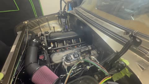

Quick video

Thanks for the images and video. So it looks like the ports with the carbon are normal, they are rich because the cylinders/spark plugs without color are not firing making the computer think you have a lean condition, so it richens the mixture up. I would start with a compression test on those cylinders (non color), change the coils out, check for fuel injector pulse. Here is a video to help with the compression test.
https://www.youtube.com/watch?v=KOxIm1F8AW0
This guide can help go over the misfire causes and how to check them.
Please go over these guides and get back to me. Ken

The install looks clean, good job!
