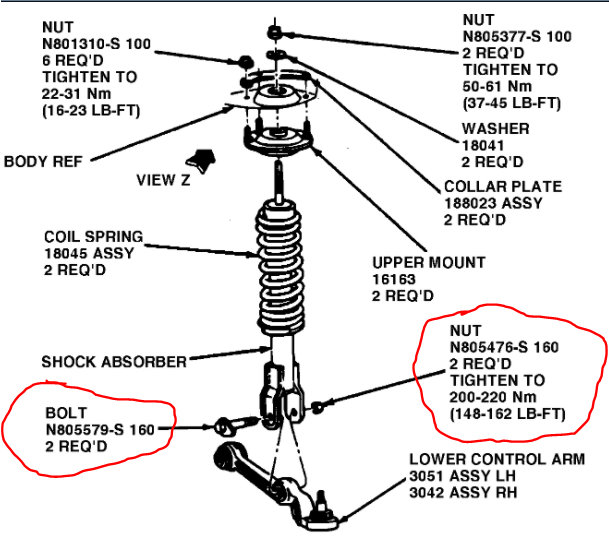

I have been replacing the control arms and have been wondering what size the lower strut to control arm mounts are.

Hello, I'm Danny.
I've attached a picture below of the information you've requested. It gave a Ford part number but not the actual size. I've circled the part number in red.If you contact a local Ford dealer parts department they can give you the size by giving them the part number.Hope this helps and thanks for using 2CarPros.
