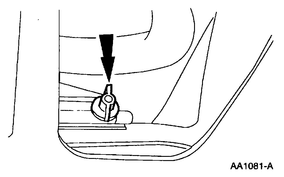

2. Drain the radiator.
pic 2

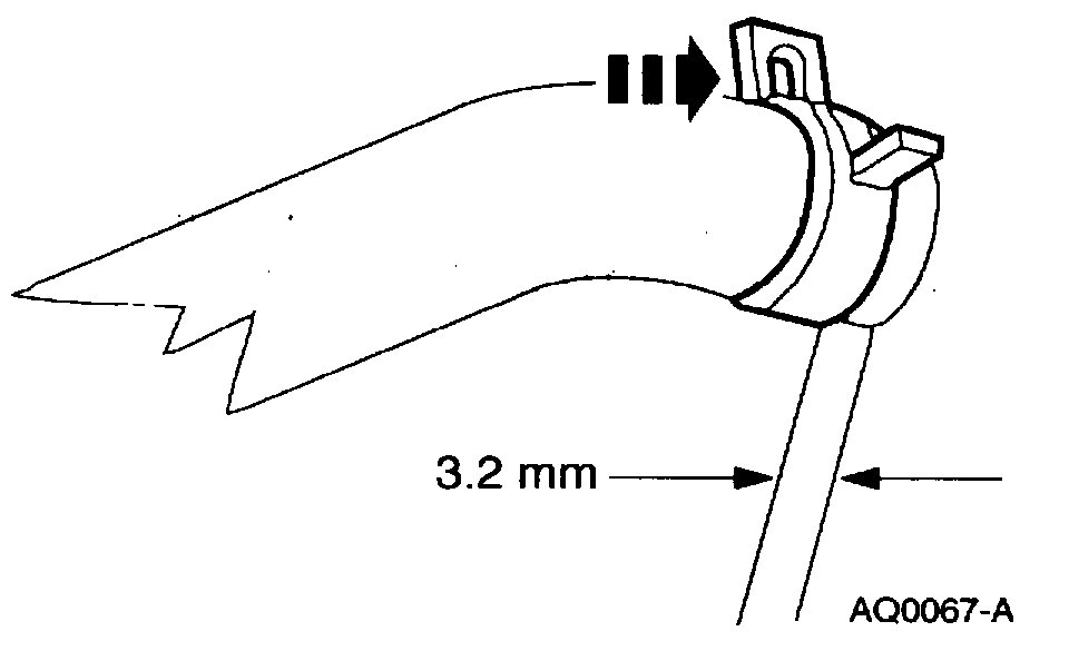

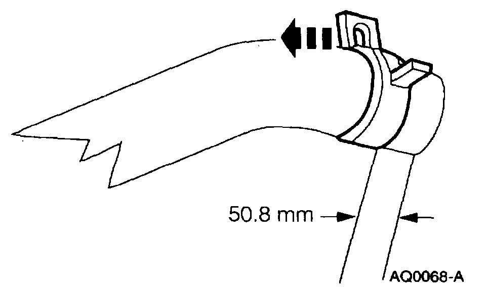

CAUTION: Reposition the clamps beyond the bead and place in the center of the clamping surface of the connections. Constant-tension hose clamps must be installed inside the alignment marks or engine coolant leaks and engine damage may occur.
pic 3
1. Position the hose clamps at least 50.8 mm (2 inches) from each end of the hose.

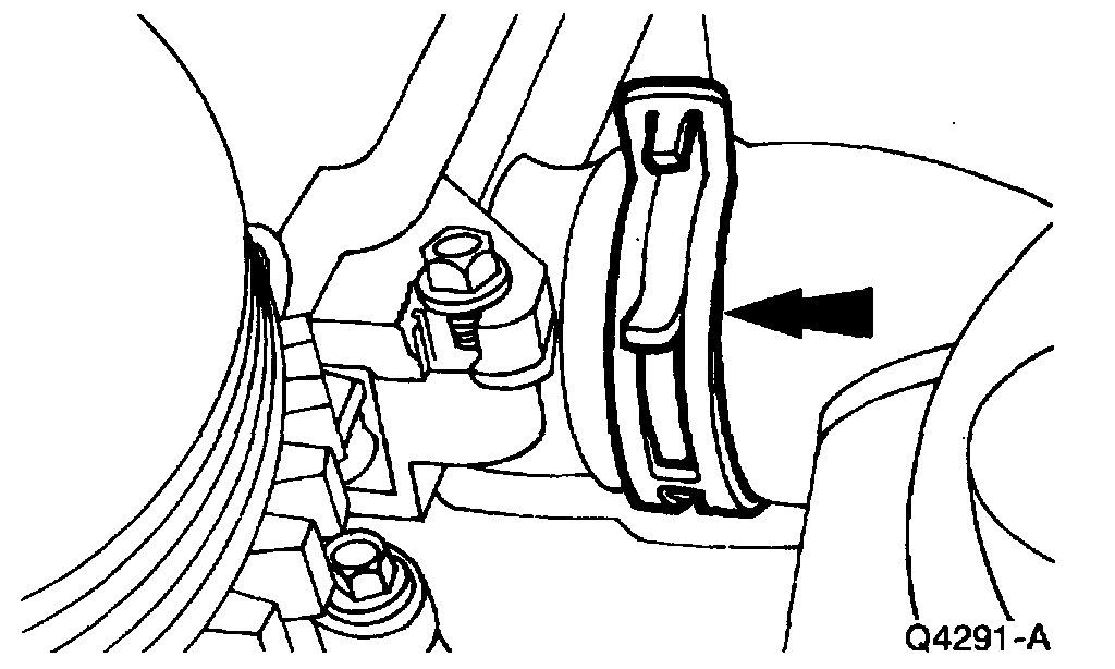

2. Slide the hoses on the connections.
pic 4
3. Position the hose clamps in the center of the clamping position at least 3.2 mm (0.126 in) from end of hose.

As far as the lower hose, the easiest way to access it is through the inner fender. If you remove the right front wheel and then the plastic inner fender, you should be able to see it easier.
If you look at pic 5, it shows the hose as it's attached to the pump. If you are trying to access it from the top of the vehicle, it will be very difficult, and I think that is what you are doing.
Let me know if that helps.

Thank you. I did remove the right side wheel to access it but could get it on. I was able to get the old one off successfully but just the new one I could not get on. I even tried removing the tensioner pulls to get better clearance but the bolt to the tensioner was too long. it wouldn’t clear the chassis body. is it possible that the water pump hose end on the new hose is too narrow or tight? Are all the hose brands made different?
Mar 31, 2020 at 6:08 AM
  • 110,244 POSTS
Anything is possible. Did you compare the two? I can't understand why it wouldn't go on. It may be tight, but still should slide on. Usually I have to twist back and forth to get them.
Also, if you have the clamp partially on the hose before installing it, that may be stopping it. It's just a thought. Make sure it is loose or pulled back on the hose at least three inches.
