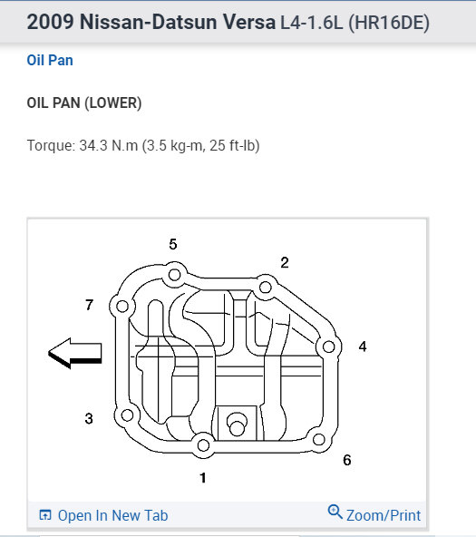

need torque spec and pattern for replacing lower oil pan.

As far as the lower oil pan torque specifications, see pic below. The picture also includes the torque sequence.
Note: The manufacturer recommends using a gasket maker product. If that is what you are doing, make sure to follow the directions. Also, allow the pan to sit dry for at least an hour before adding oil.
Let me know if this is what you needed.
