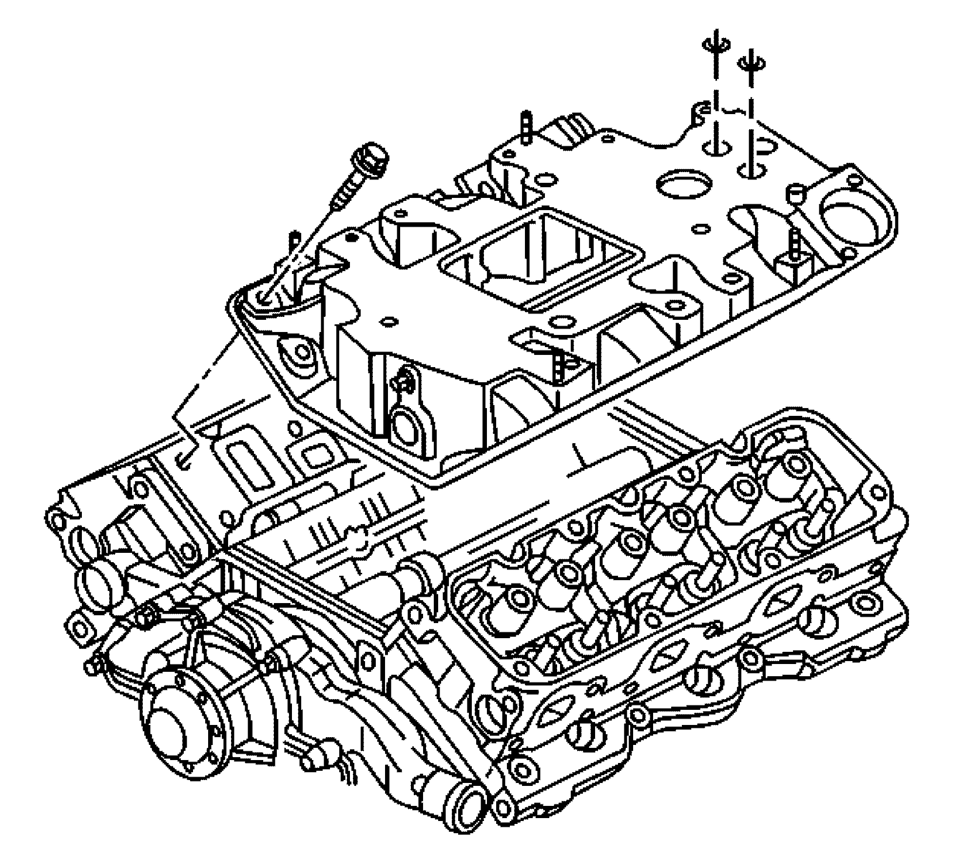

I have the car listed above GTP model with series 3 SC 3800.. Does the series 2 and 3 use the same lower intake manifold?
Mar 9, 2021 at 8:47 AM
  • 110,194 POSTS
It should be the same. If I recall, changes were made to the supercharger. As far as replacement, here are directions for the lower manifold. I'm adding them because they include torque specs.

1. Drain the cooling system.
2. Remove the supercharger.
pic 1

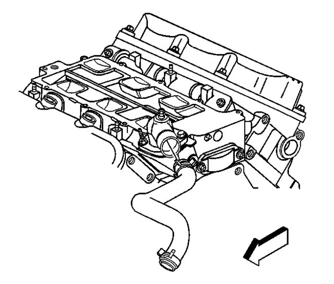

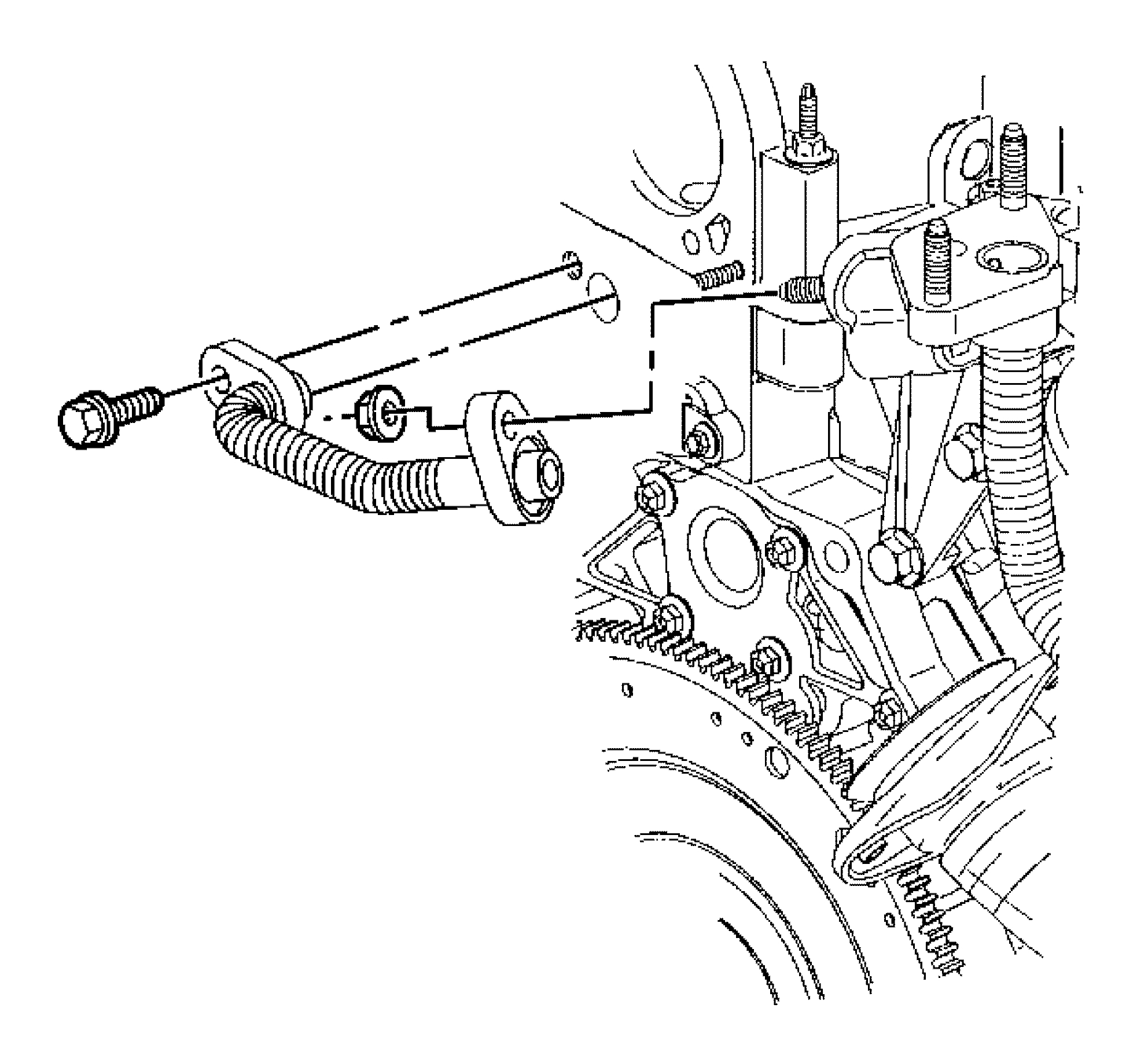

3. Remove the radiator inlet hose from the water outlet housing.
pic 2

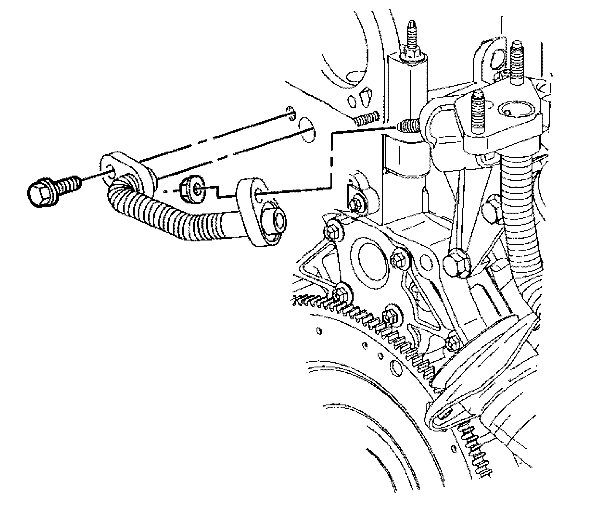

4. Remove the exhaust gas recirculation (EGR) outlet pipe bolt from the lower intake manifold.
5. Remove the EGR outlet pipe from the lower intake manifold.

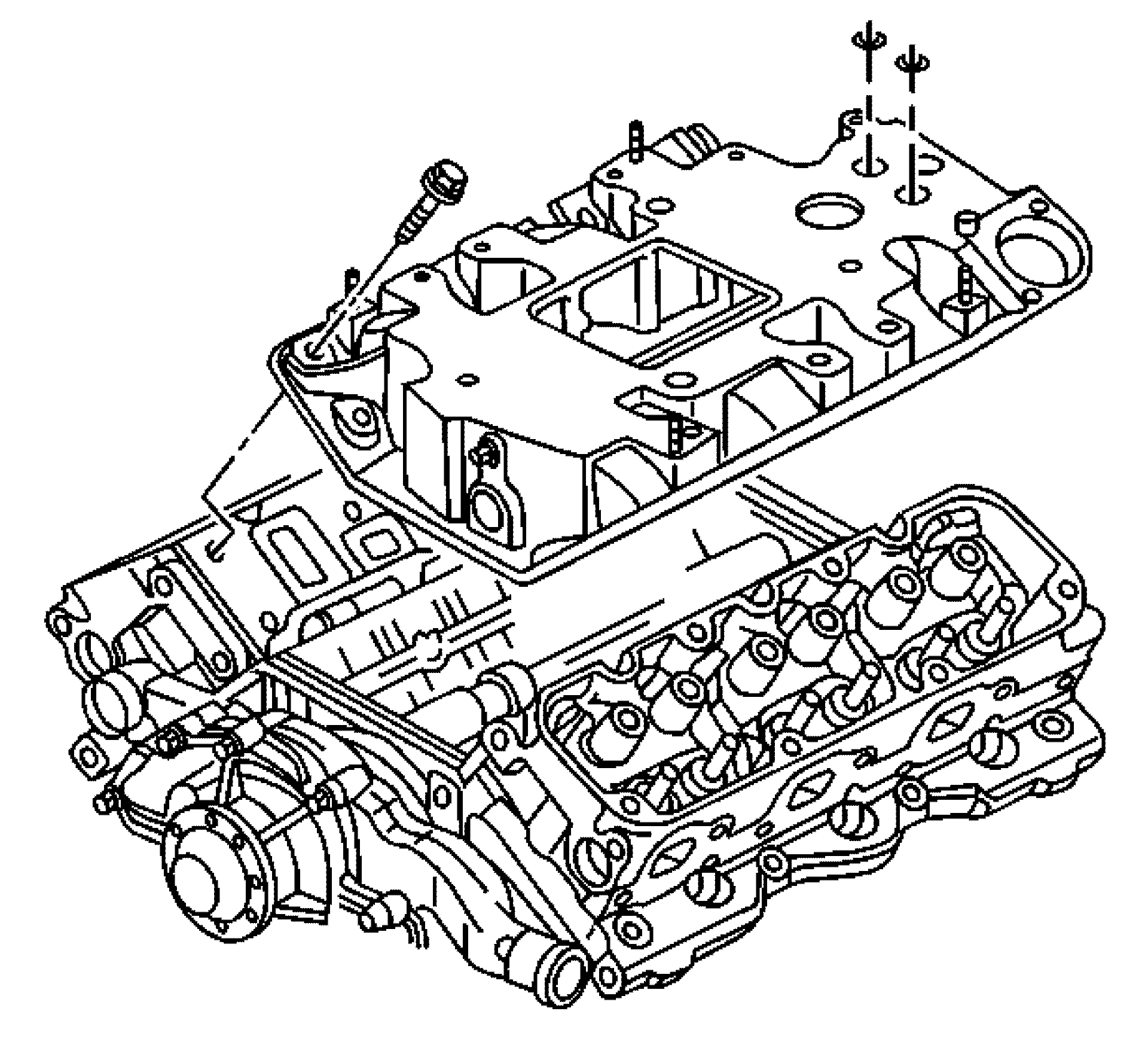

7. Remove the lower intake manifold bolts.
8. Remove the lower intake manifold. The coolant bypass tube will release from the intake manifold as the manifold is removed.

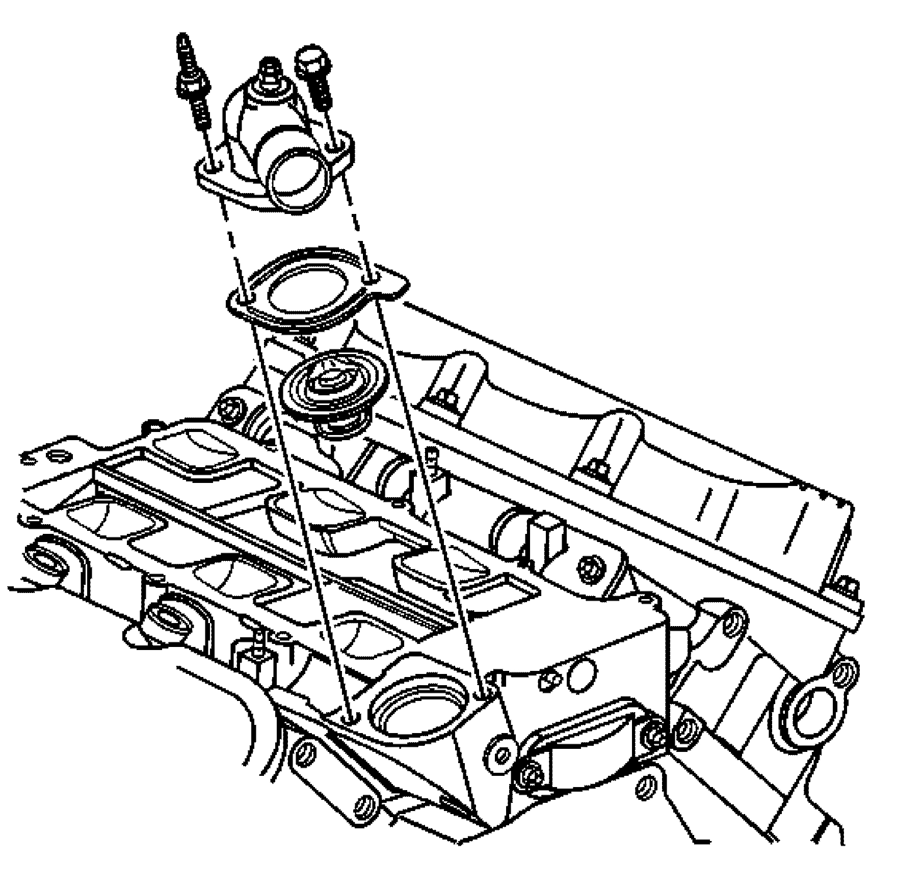

2. If removed, install the thermostat, the gasket, and the water outlet housing.
3. Install the water outlet housing bolt and the stud.
Tighten
Tighten the bolt and the stud to 27 Nm (20 lb ft).

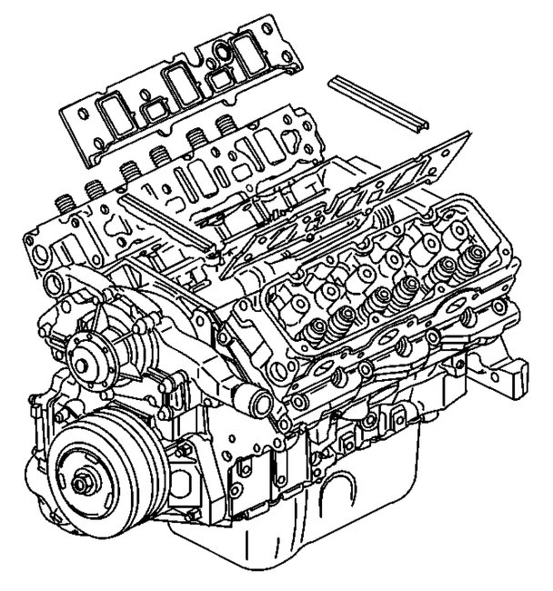

4. Install the intake manifold gaskets.

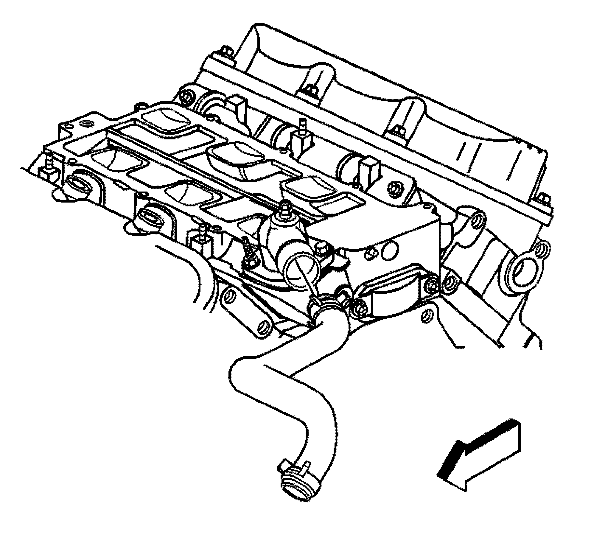

5. Apply sealer, GM P/N 12346286 (Canadian P/N 10953472) or equivalent, to the ends of the intake seals.
6. Install the lower intake manifold seals.
