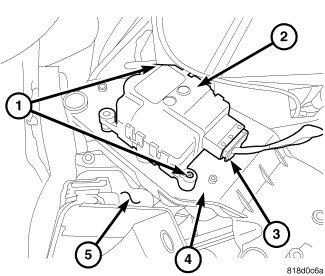

Heater blows out defrost and dash vents but not lower vent. What can I do to find out what is causing this?

The air flow direction is controlled by what is called a mode door. The mode door changes directions of the air flow when an actuator moves it. Now, I suspect that either the mode door actuator is bad or the door is stuck and not allowing it to position itself for floor vents.
With that in mind, you will need to check the actuator. Here are directions for removal and install. You will need to remove the actuator and then see if it works when you select floor position. The actuator is located under the dash on the HVAC box.
_____________________________
REMOVAL
WARNING: Disable the airbag system before attempting any steering wheel, steering column or instrument panel component diagnosis or service. Disconnect and isolate the negative battery (ground) cable and wait two minutes for the airbag system capacitor to discharge before performing further diagnosis or service. This is the only sure way to disable the airbag system. Failure to follow these instructions may result in accidental
airbag deployment and possible serious or fatal injury.
See picture 1
NOTE: LHD model shown. RHD model similar.
1. Disconnect and isolate the negative battery cable.
2. If equipped, remove the silencer from below the driver side of the instrument panel.
3. Disconnect the wire harness connector (3) from the mode door actuator (2) located on the driver side of the air distribution housing (5).
4. Remove the two screws (1) that secure the mode door actuator to the actuator mounting bracket (4) and remove the actuator.

When you remove it for inspection and testing, make sure to also inspect the linkage between the actuator and the door as well as if the door can move to all positions.
