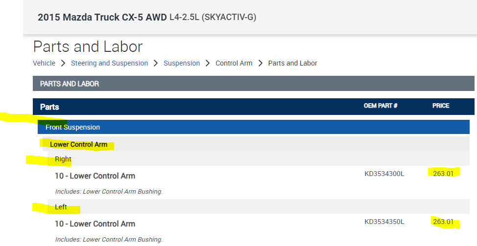

Dealer said my lower front control arms need replacing rubber bushings cracked they want a lot of money to replace them. I wanted to know how much in Oregon parts and labor costs would be I'm in Keizer Oregon.

If the only problem is the bushing, it can be replaced without replacing the entire control arm.

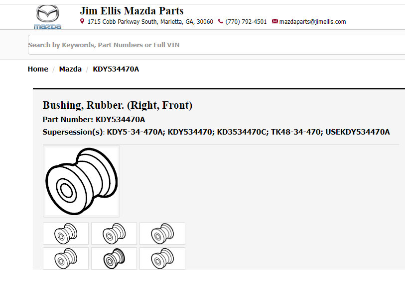

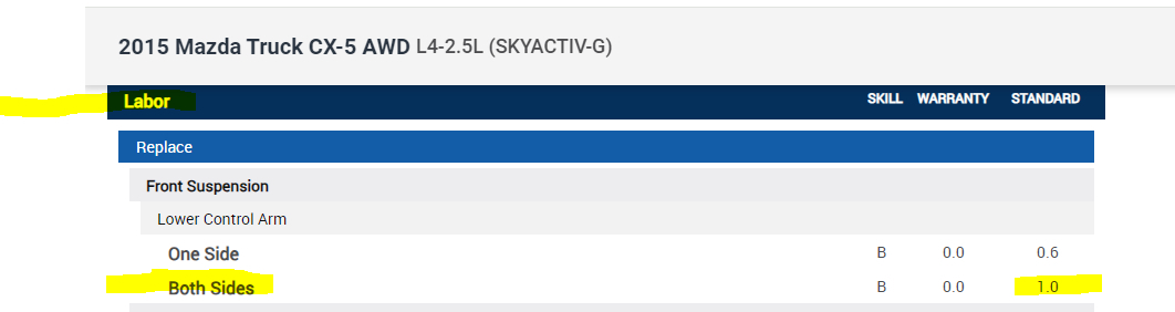

If you look at pics 1 and 2 below, they show the cost of the OEM new lower control arms which is expensive. Additionally, to install both only calls for one hour labor, so you would need to ask the dealer their labor cost.
Here is the thing. There was a bulletin out for this vehicle that had a creaking noise coming from the lower control arm bushings when they got wet. The fix was to simply remove the control arm, press the old bushing out and replace it with an updated one that wouldn't make noise. See pic 3 for the price of the bushing.
I would ask if that is something they would consider. The labor rate is 0.8 hour per side, but the part cost is way less. (this recommendation is something AI can't do LOL)
