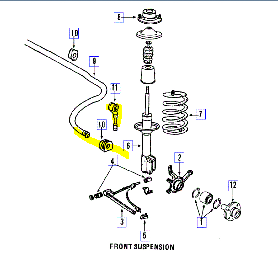

Also, check and make sure the backing plates behind the brake calipers are not bent and rubbing against the rotors. Make sure things like the stabilizer links are connected and nothing is touching the sway bar itself. (I highlighted what I'm referring to in the pic below.
See pic below.
