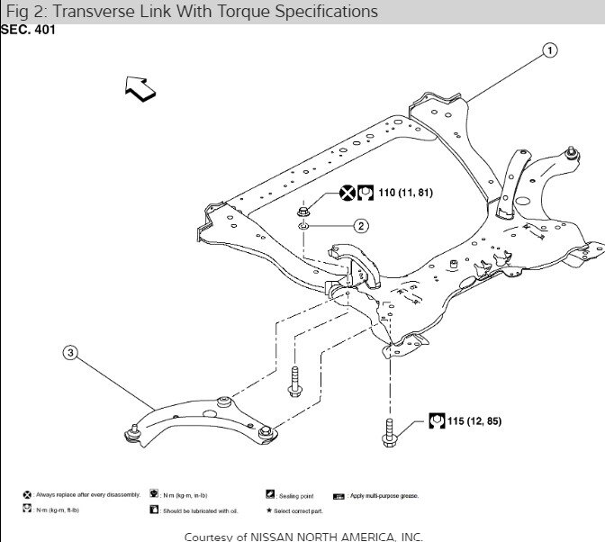

What are the lower control arm torque specifications?
2018 NISSAN KICKS
70,000 MILES • 1.6L • 4 CYL • 2WD • AUTOMATIC
BACKJAUER
I need to find the torque specifications for the lower control arms on the vehicle listed above. The part numbers are listed below:
54501-5RL1B (Left)
54500-5RL1B (Right)
Thanks!

Hello and thanks for your question!
The torque for the lower control arms is 85 ft lbs.
Be sure to torque these with the vehicle weight on the ground, or binding of the arm bushings can occur and cause problems.
Let us know if you need anything else, we are here to help.
