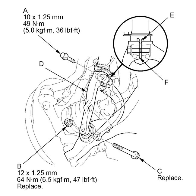

3. Remove the damper pinch bolt (A) and the damper fork mounting nut (B) while holding the mounting bolt (C), then remove the damper fork (D) from the damper and the lower arm.
NOTE:
- During installation, insert the aligning tab (E) on the damper unit into the slot (F) of the damper fork.
- Use the new damper fork mounting bolt and the new mounting nut, and torque the nut while holding the bolt during reassembly.

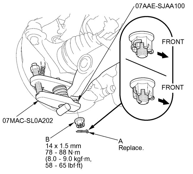

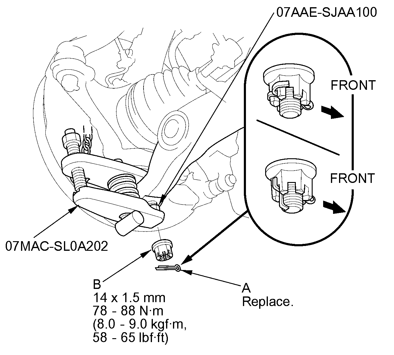

5. Remove the cotter pin (A) from the knuckle ball joint, then remove the castle nut (B).
NOTE: During installation, insert the new cotter pin into the ball joint pin hole from the front to the rear of the vehicle, and bend its end as shown. Check the ball joint pin hole direction before connecting the ball joint.
pic 2
6. Disconnect the knuckle ball joint from the lower arm using the ball joint thread protector and the ball joint remover See: Ball Joint > Removal and Replacement > Ball Joint Removal.

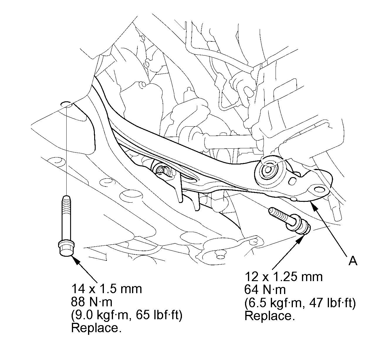

7. Remove the lower arm mounting bolts, and remove the lower arm (A).
NOTE: Use new lower arm mounting bolts during reassembly.
pic 3
8. Install the lower arm in the reverse order of removal, and note these items:
- First install all of the components, and lightly tighten the bolts and the nuts, then raise the suspension to load it with the vehicle's weight before fully tightening it to the specified torque. Do not place the jack against the ball joint pin of the knuckle.

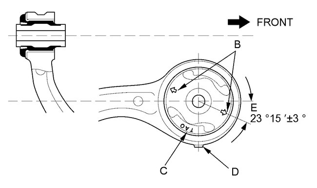

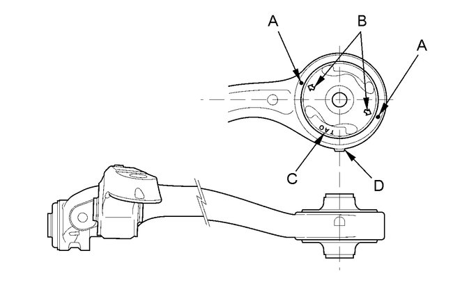

Compliance Bushing Replacement
1. Remove the lower arm.

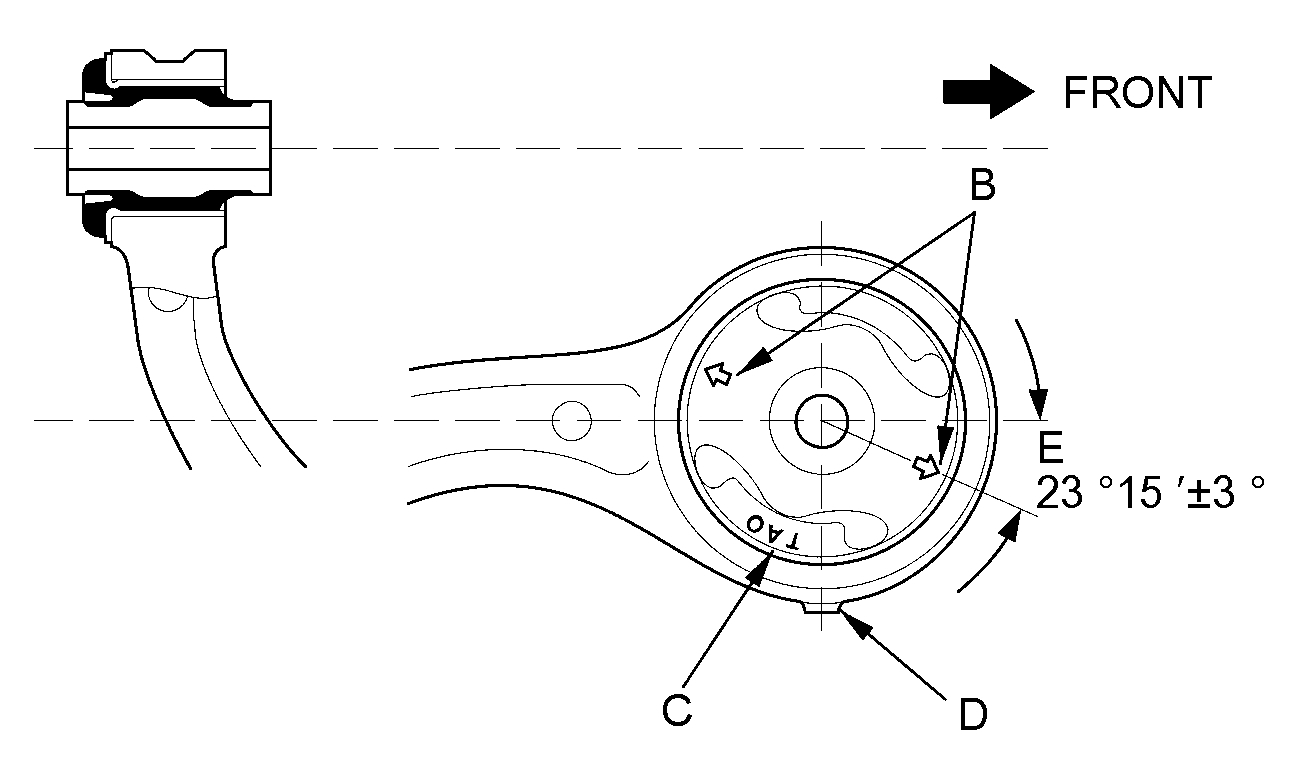

2. Mark alignment marks (A) on the bottom of the lower arm next to the aligning marks (B) on the compliance bushing.
NOTE: The compliance bushing has a specific installation position. Turn the lower arm so that its bottom side is up. Position the bushing identifying mark (C) face up and near the tab (D) on the lower arm. Then align the bushing aligning marks on the bushing and the lower arm.
If the alignment marks are gone, align the angle (E) between the lower arm and the bushing as shown.
Aligning the marking position
pic 4
Aligning the angle (reference)
pic 5

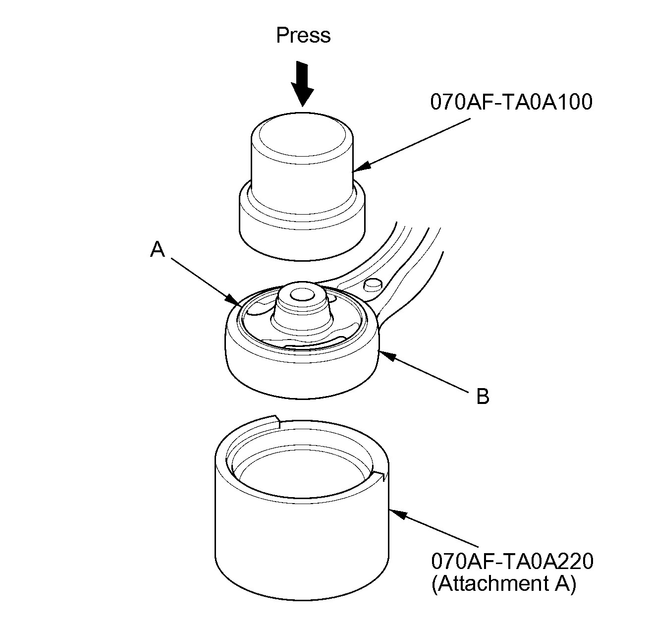

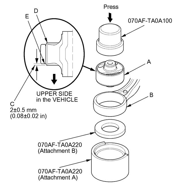

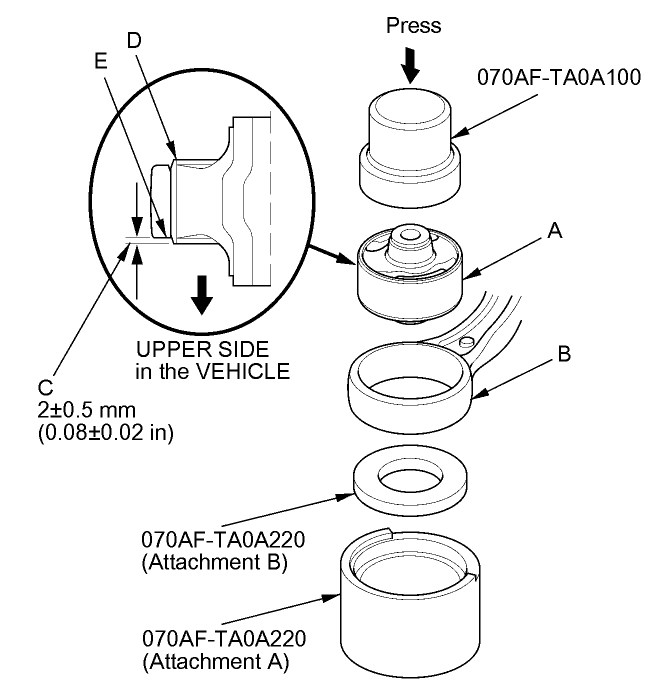

3. Press out the compliance bushing (A) with the bushing driver, the bushing receiver set (attachment A), and a hydraulic press, and remove the bushing from the lower arm (B).
NOTE: Be careful not to damage the inside of the bushing hole on the lower arm.
pic 6

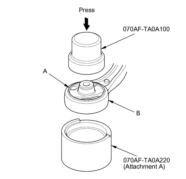

4. Clean the mating surfaces of the new compliance bushing (A) and the lower arm (B).
pic 7
5. Make sure of the compliance bushing installation direction, align the bushing aligning marks with the lower arm, then press in the bushing into the lower arm using the bushing driver, the bushing receiver set (attachments A and B), and a hydraulic press.
NOTE:
- Press in the bushing from the bottom side of the lower arm.
- After installation, check the protrusion (C) of the bushing outer sleeve (D) through the lower arm bushing hole (E).
