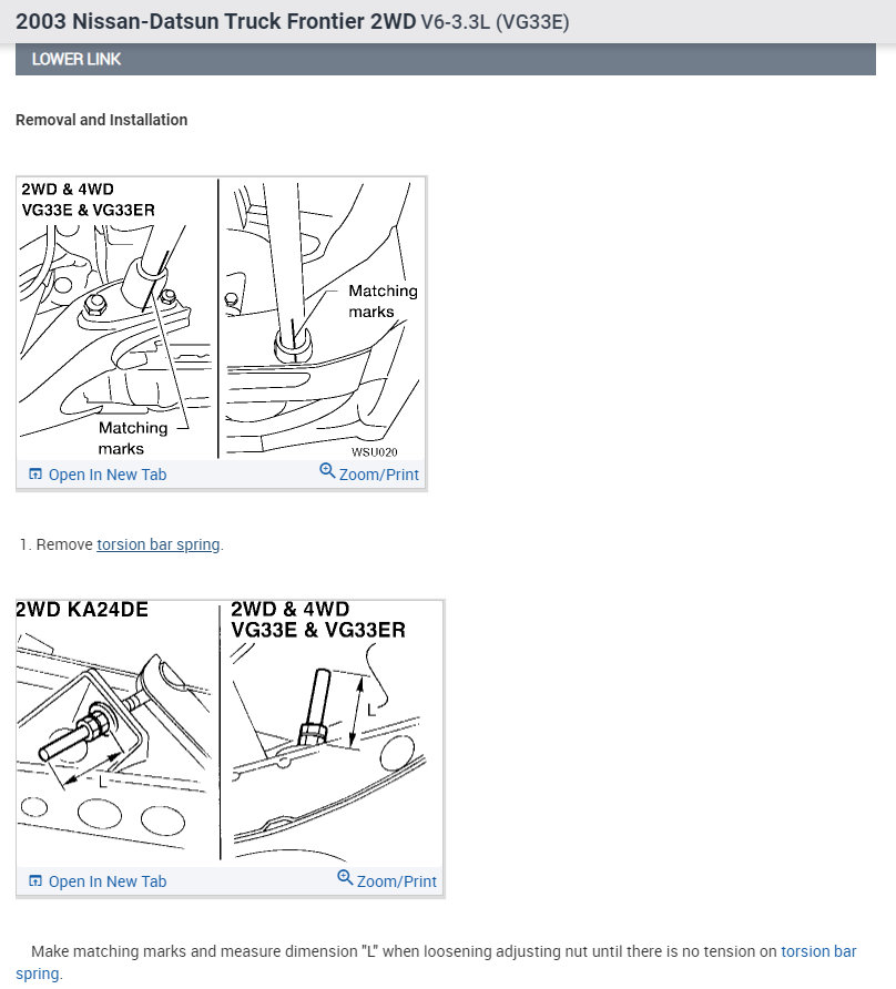

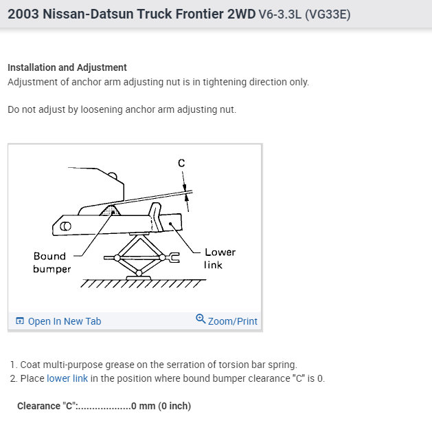

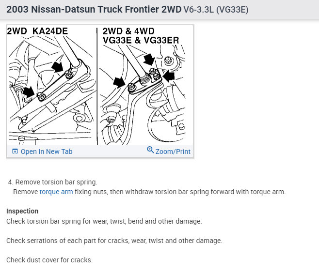

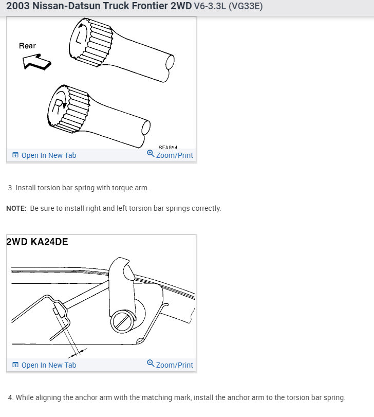

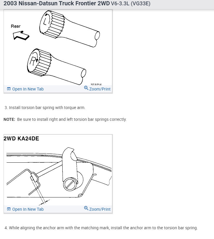

What do I have to do to the torsion bar in order to remove the lower control arm?
Jun 19, 2022 at 10:03 AM
SQM
Experienced Mechanic
6,383 POSTS

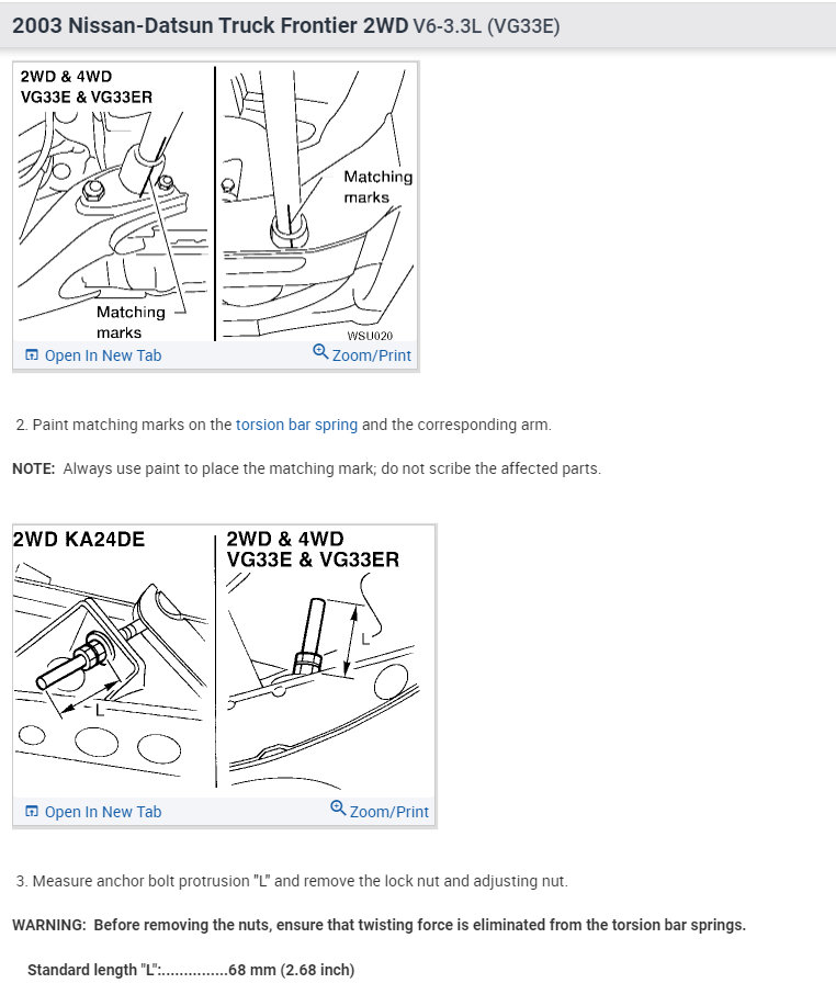

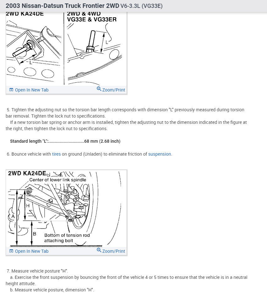

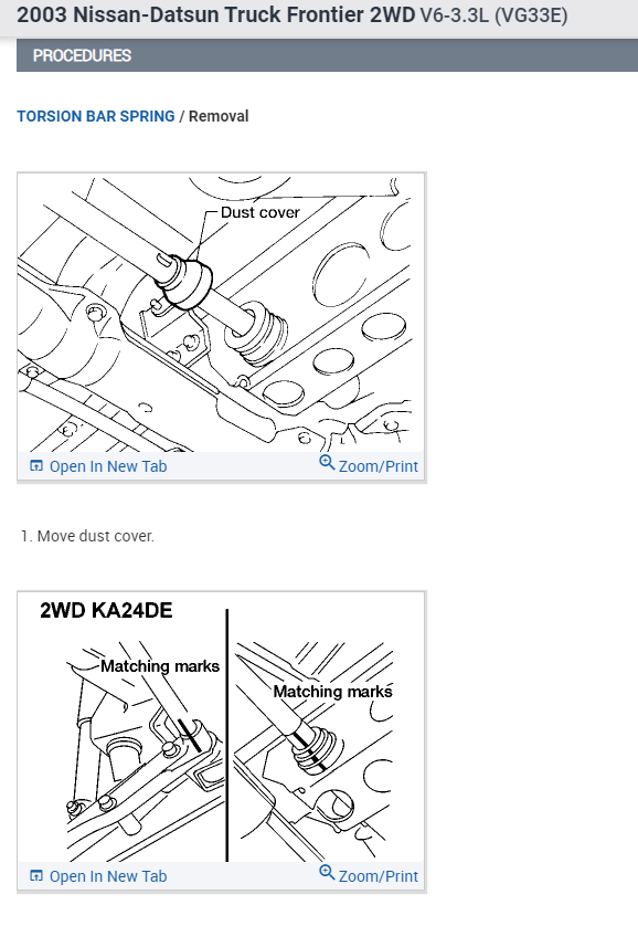

The torsion bar will have to be removed before replacing the lower control arm.
Keep in mind that it might need an alignment after the torsion bar removal.
See attached, I have included the replacement procedure for your reference.
Let me know of any questions.

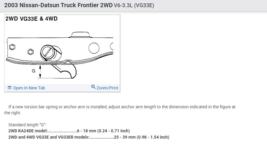

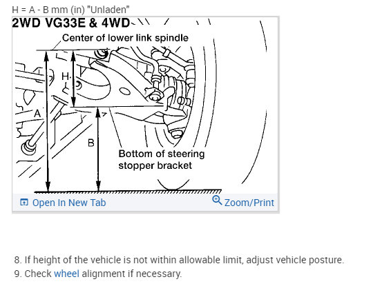

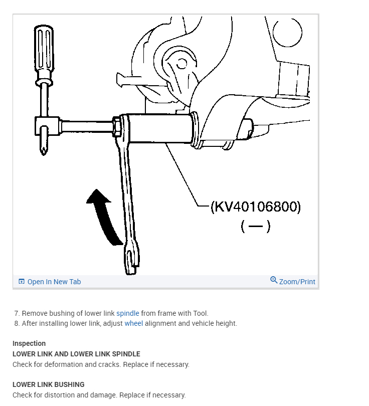

Can I have the instructions for replacing the front lower control arm?
Jun 21, 2022 at 5:54 AM
SQM
6,383 POSTS
If you look at the first 3 images on the previous post, that is for the lower control arm.
