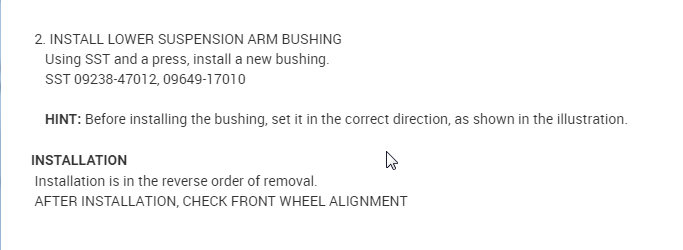

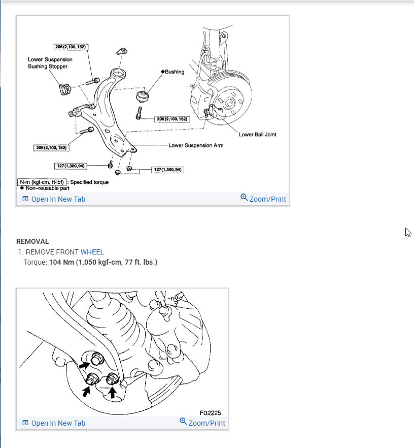

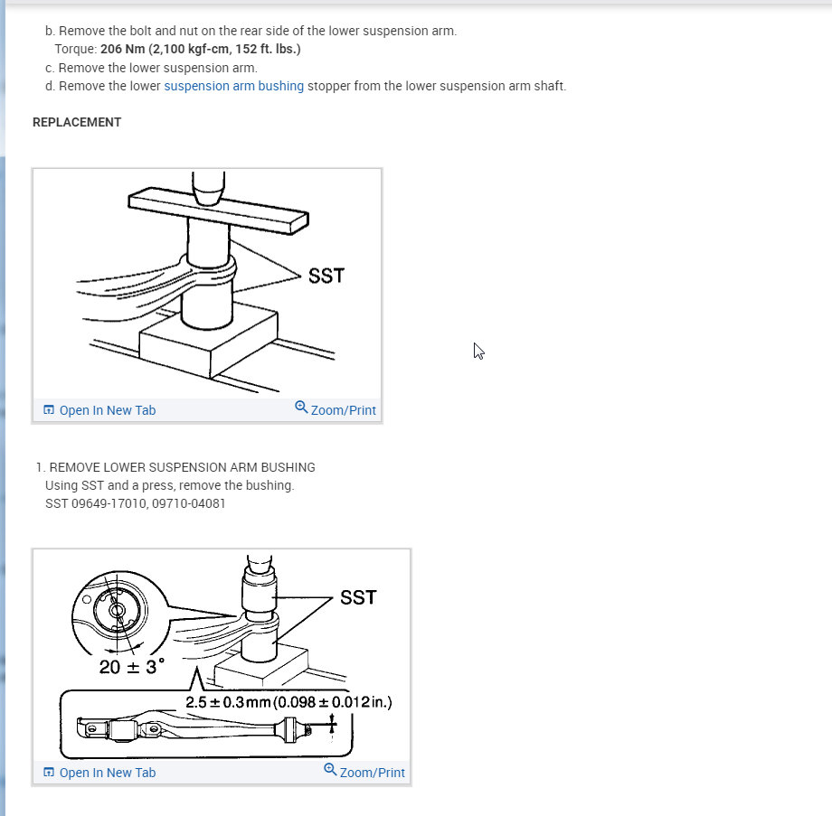

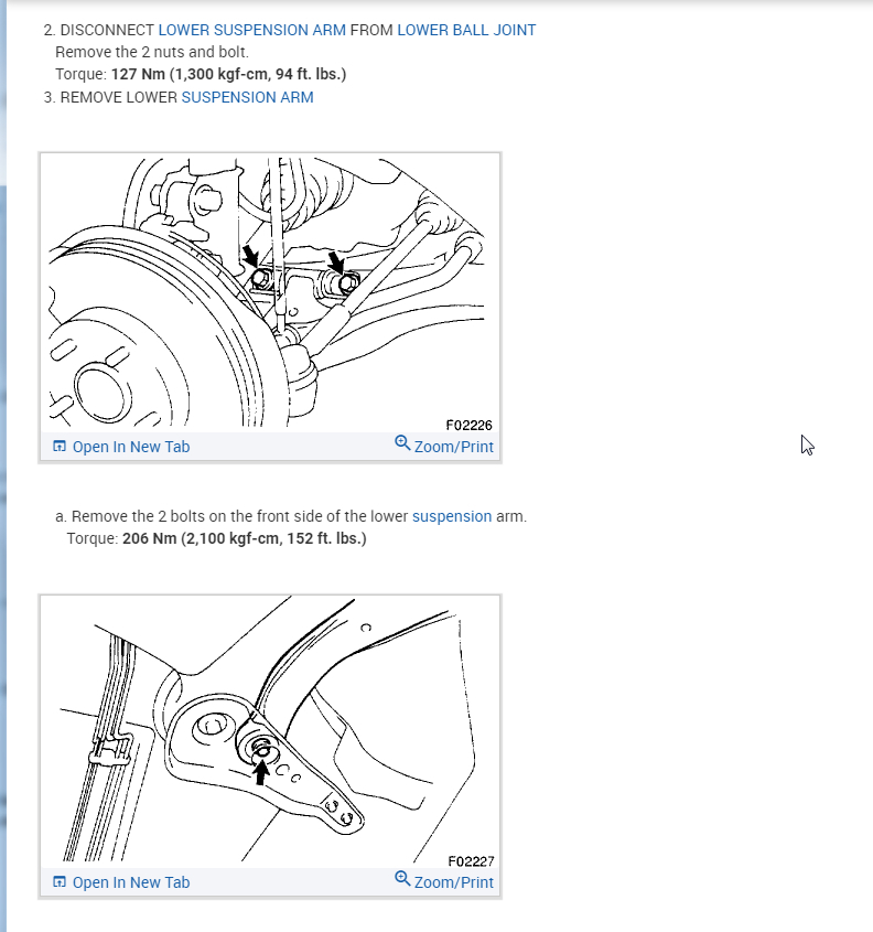

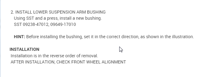

I attached the process for replacing the control arms and installing new bushings. However, I am sure you can find a replacement control arm that comes with new bushings. If you have found play in a bushing then it needs replaced.
Let me know if you have questions but unfortunately there is only one repair that will fix this type of issue. Thanks
