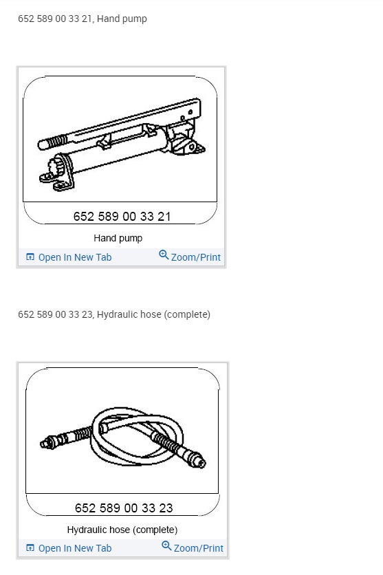

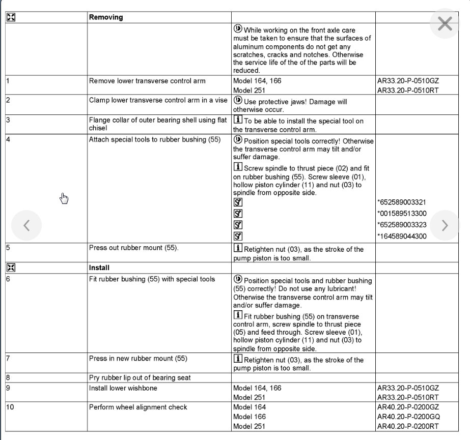

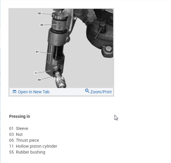

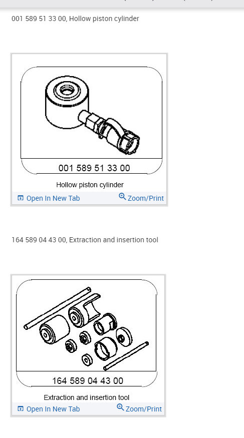

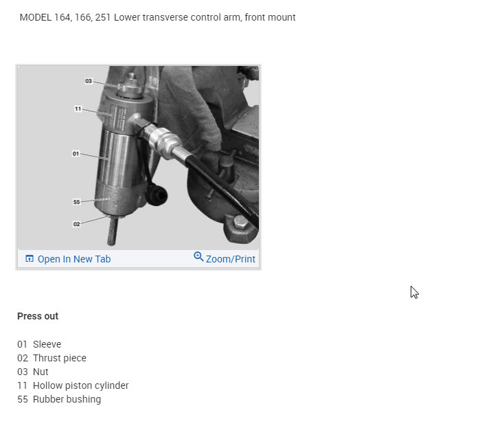

How to replace front lower control arm bushing?
Sep 26, 2019 at 4:44 PM
Experienced Mechanic
18,907 POSTS
Here is the procedure from Alldata that shows how to remove the lower bushing. It appears you have to press it out which requires some special tools.
Please let me know if you need more information. Thanks
