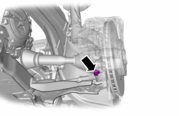

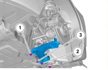

This is the P3 chassis. nothing on YouTube. I got the old arm out but having major difficulty getting the new one in.
do i have to remove the entire hub? I have not yet. I got the old one out by just jacking up the knuckle a bit and the old arm slipped right out.
I only have one side on jack stand.

Here are the directions right from Alldata related to replacing the control arm. The attached pictures correlate with these directions.
__________________________________
FRONT CONTROL ARM
Front control arm
Operation number: 61202-2
Removal
Note! Removal steps in this procedure may contain installation details.
Remove the wheel Refer to: Wheels See: Wheels > Removal and Replacement
Torque: Ball joint to wheel knuckle, 110 Nm
Remove the following items:
1. Torque: Lower arm front to subframe (front mounting) Stage 1: 140 Nm Stage 2: 45 degree
2. Torque: Lower arm front to subframe (rear mounting), 175 Nm
3. Torque: Lower arm front to subframe (rear mounting), 175 Nm
Installation
To install, reverse the removal procedure.
