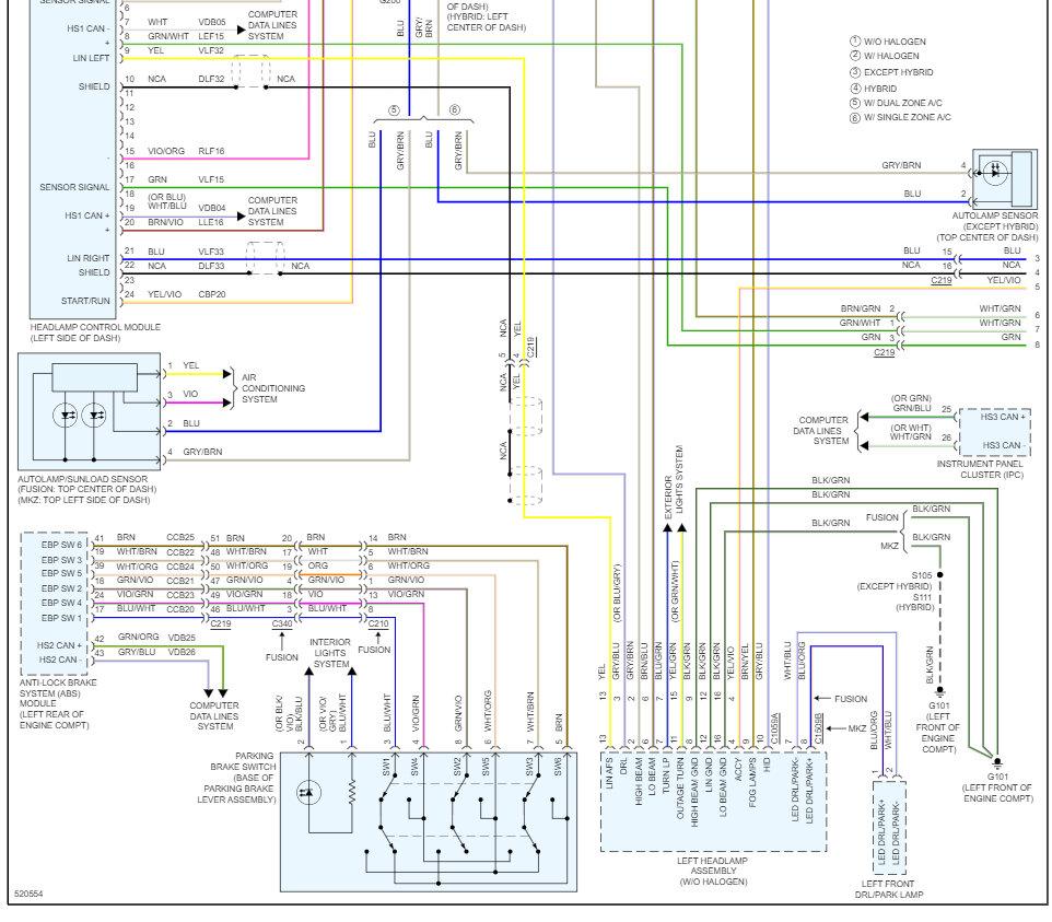

We have the car listed above SE. Just noticed copilot low beam headlight is out. We replaced the whiter and brighter bulb we just installed in September, still nothing.
Replaced overheated socket (when new bulb didn't work, we next thought the socket had overheated by the way it looks, see attached picture), still nothing.
Now totally perplexed!
Research shows some fuse panels having a fuse for each light, so 4 fuses, one for each low beam and one for each high beam. Our owner manual does not list any fuses for headlights at all.
Can anyone who is super familiar with internal electrical system give us (seniors) any ideas of what to try next before we take it in to a repair shop and have them rape us for something computer related?

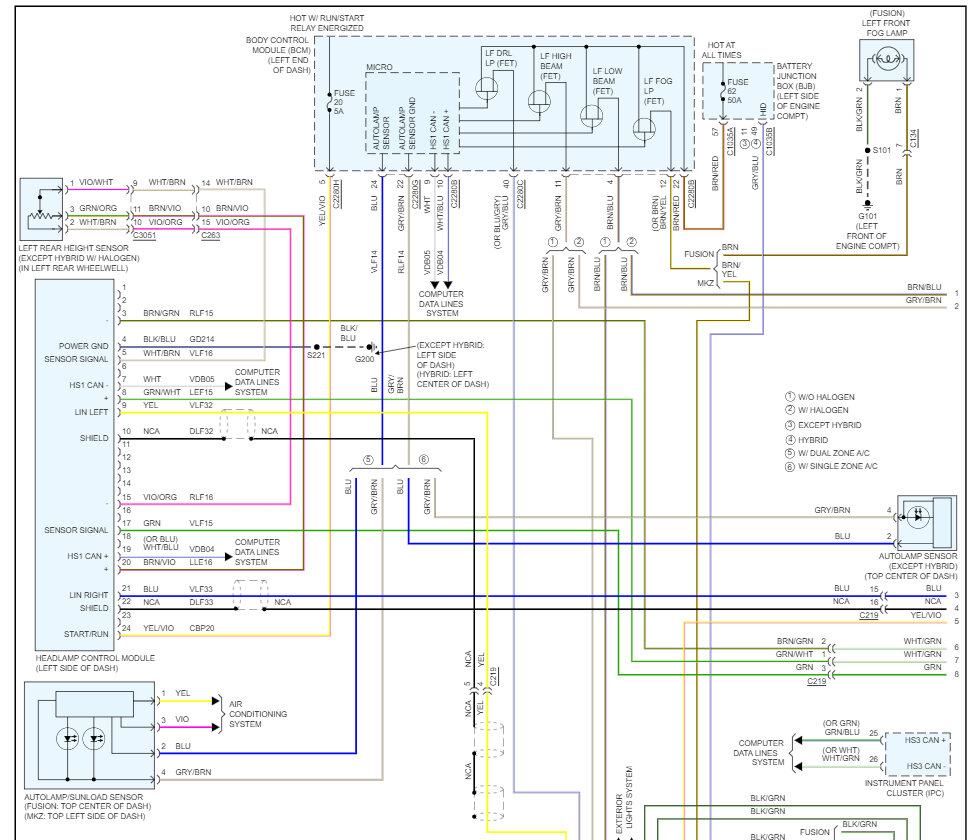

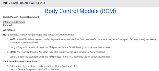

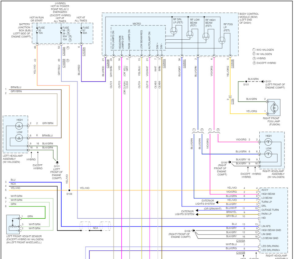

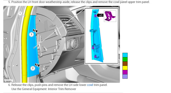

I don't see the picture. With the socket overheated I would say the BCM has gone out, which is what controls the headlights, but you should check all fuses first with the systems on.
We can confirm the BCM failure by doing a CAN scan. You can get a CAN scanner (Controller Area Network) which will work on most cars from Amazon.
https://youtu.be/u-4syLc-ifQ
and

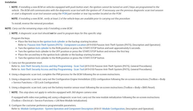

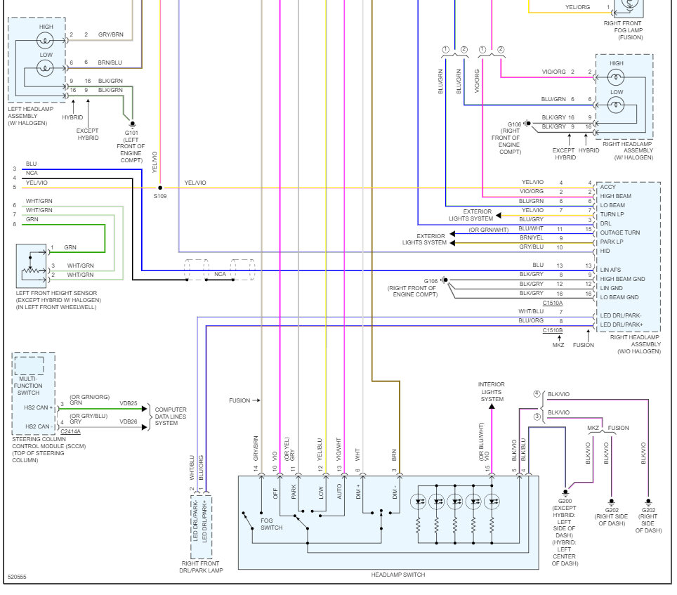

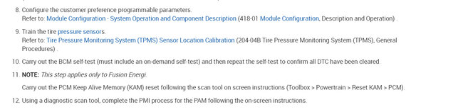

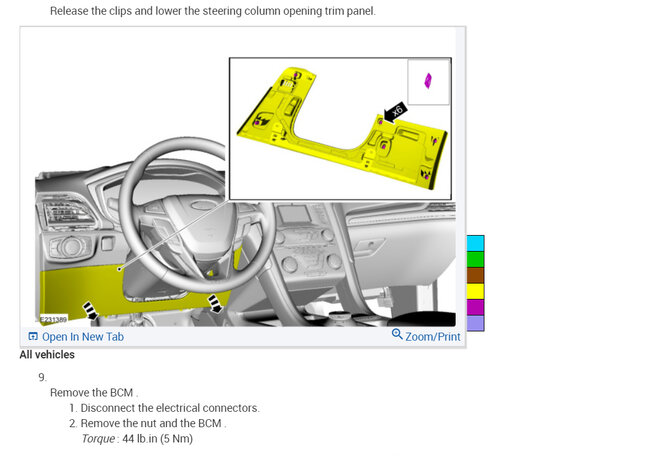

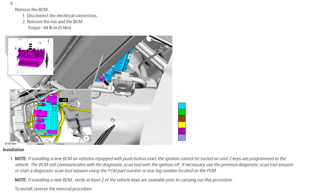

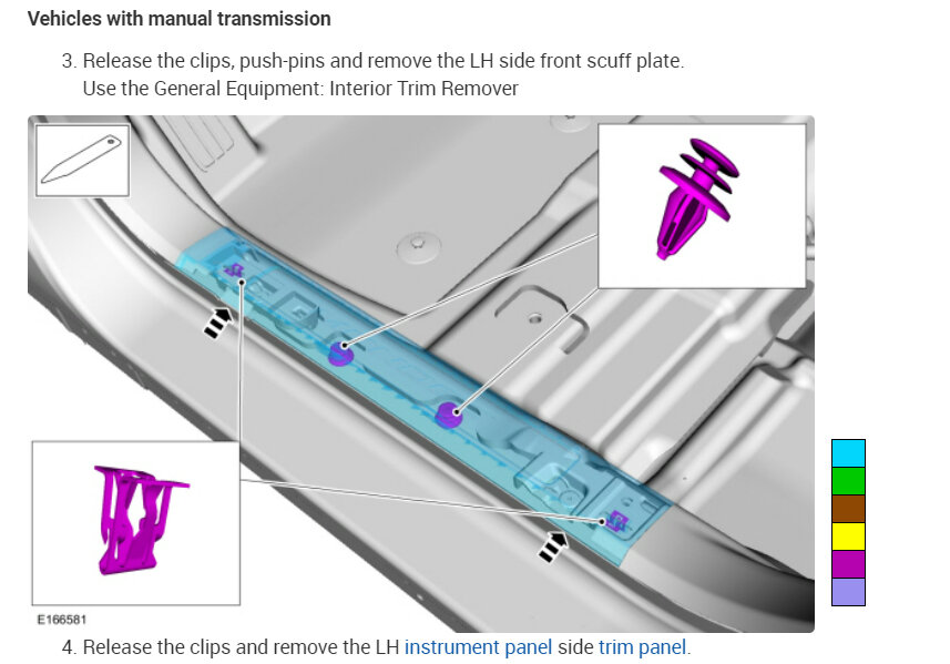

Here is he wiring diagrams for the headlights which show you how the headlights work and i have included how to change out the BCM in case you need it. You can get a preprogrammed unit by searching Google or Ebay. Check out the images (below). Please let us know what happens.
