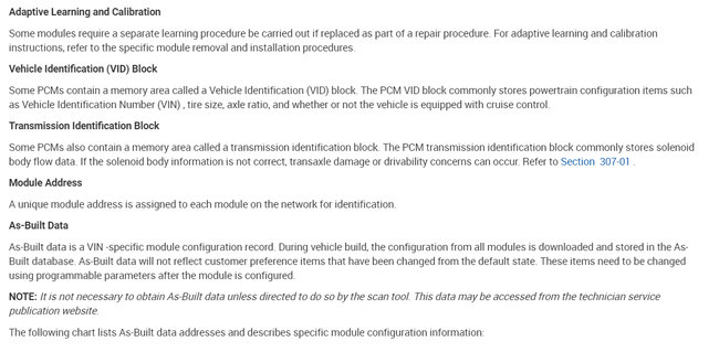

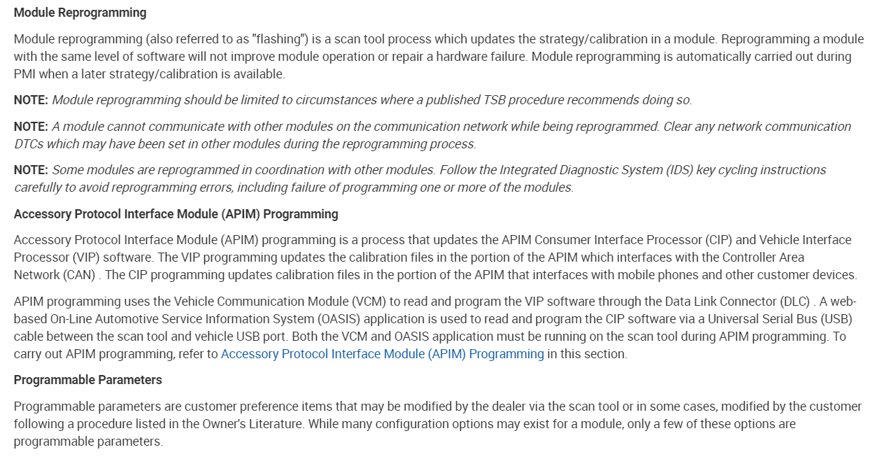

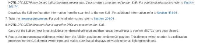

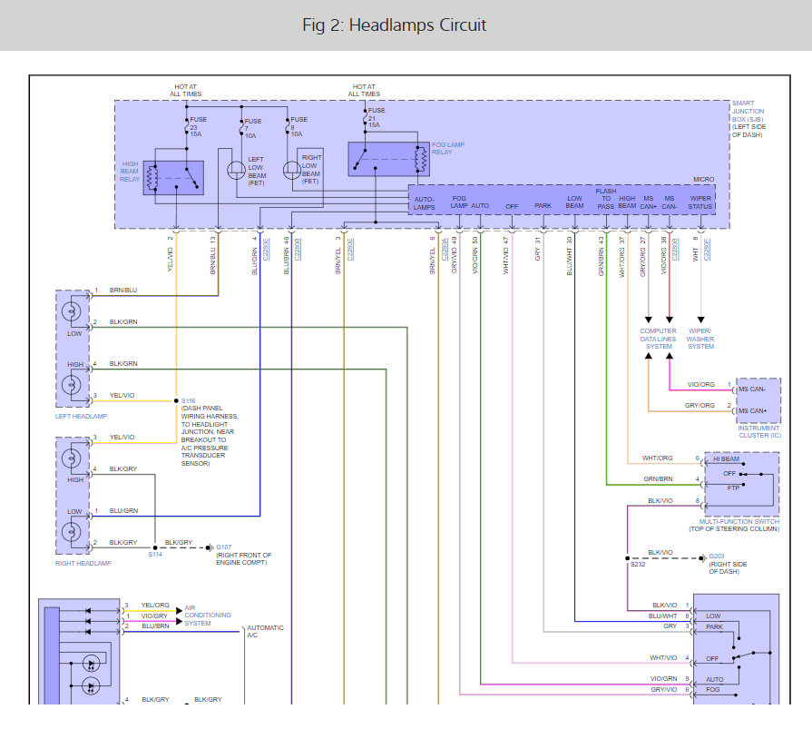

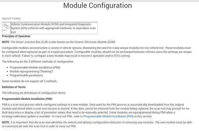

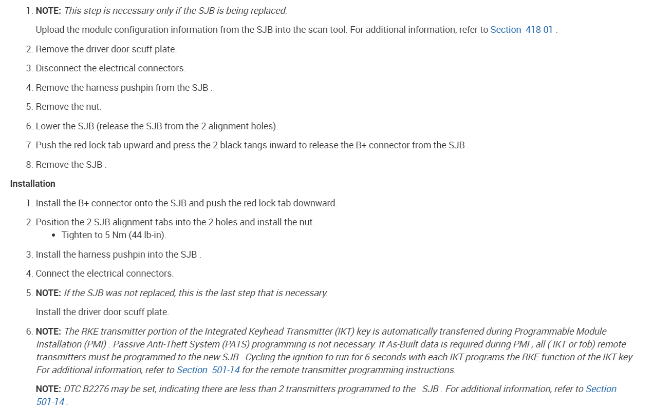

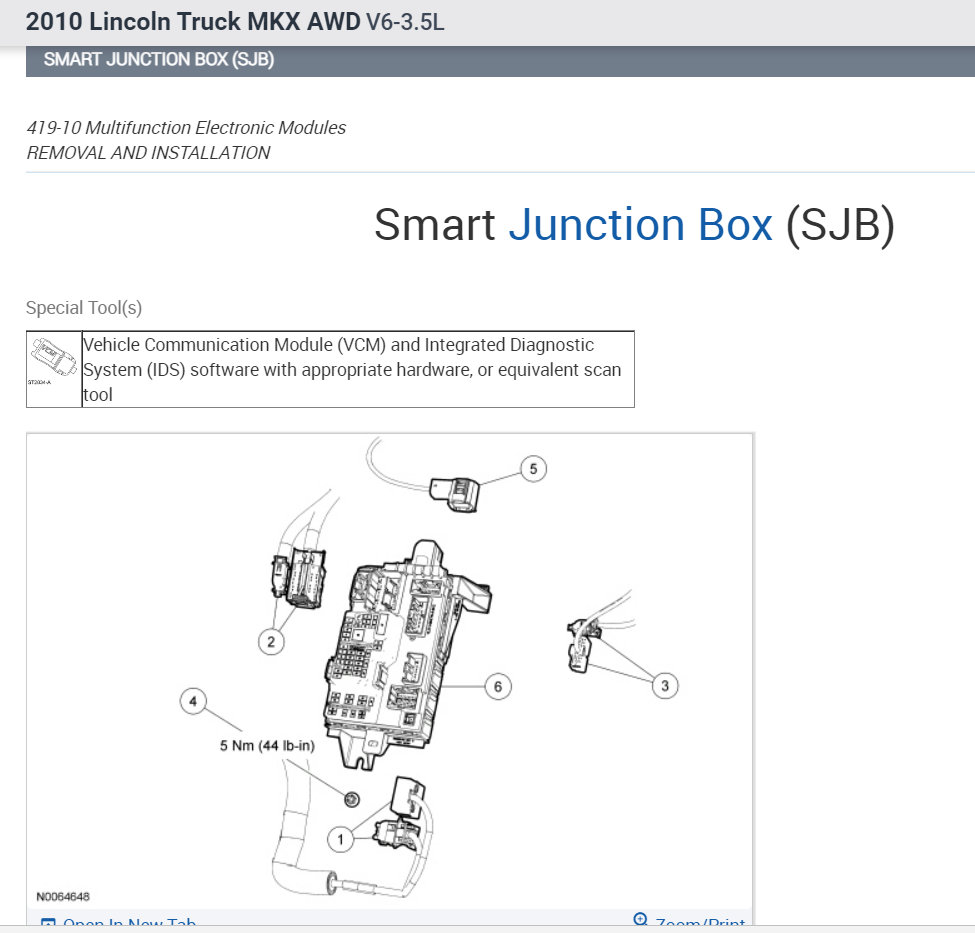

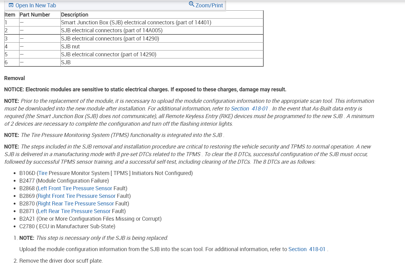

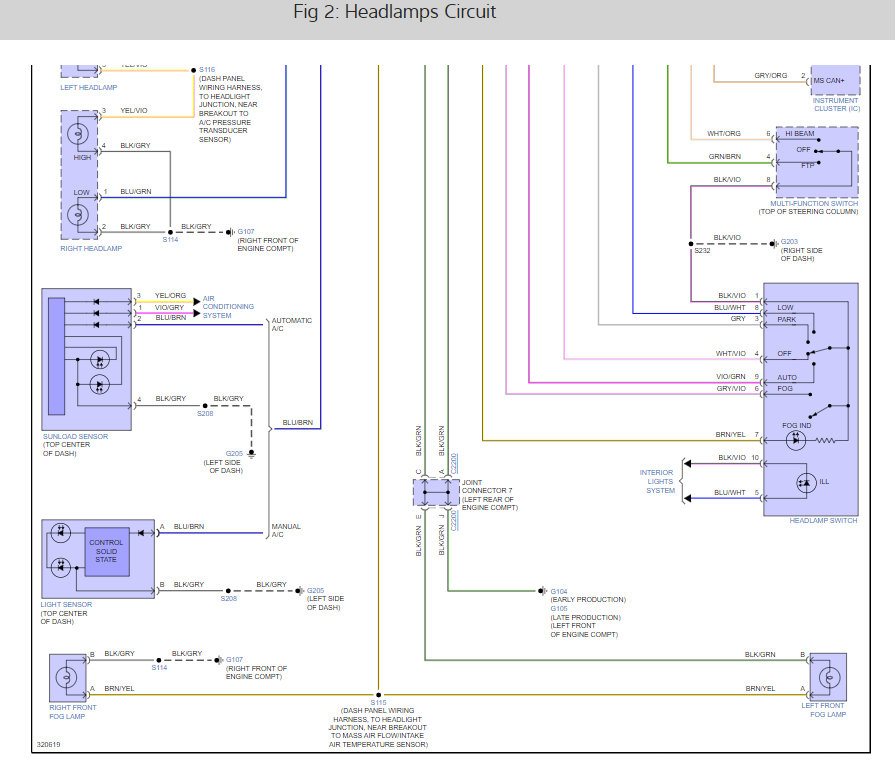

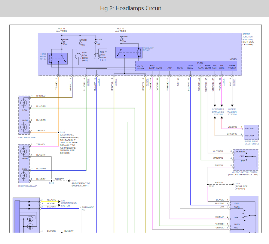

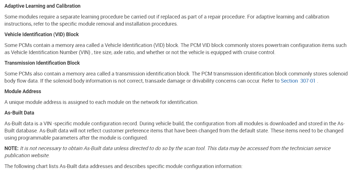

This happens when the SJB (smart junction box) goes out, here is the headlight wiring diagrams so you can see how the headlamp system works and I have included how to change out the SJB in the images below. Check out the images (below). Let us know what happens and please upload pictures or videos of the problem.

Most of your images aren’t actually opening so I can’t see anything other than the wiring diagram.
The SJB would cause only one headlight to malfunction?
Sep 30, 2022 at 4:59 AM
  • 55,423 POSTS
You need to refresh the page to get it to work, it is a bug on our website, sorry. Yes, the SJB box treats the lights individually, check out the wiring diagrams for clarity.
