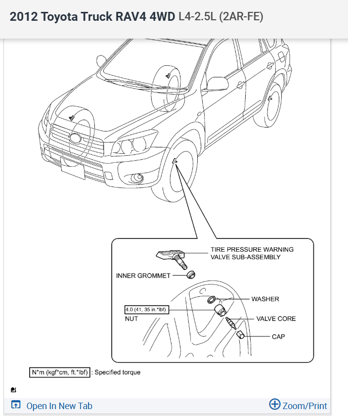

Low Tire Pressure Dashboard light, is there a way to reset?
2012 TOYOTA RAV4
89,000 MILES • 4 CYL • 4WD • AUTOMATIC
JIM DEMPSEY
All tires including spare are properly inflated 3/14/25. Light has been on for a couple of months. Is there a way to reset?
Mar 14, 2025 at 4:31 AM
  • 55,256 POSTS
The system resets itself when all the tire pressor sensor are working which it sounds like one or more are not which is common, we need to scan the system for codes to tell us which sensor is not working.
https://youtu.be/u-4syLc-ifQ
Here is how to change the sensor out so you can see what needs to be done. Check out the images (below). Please let us know what happens.
