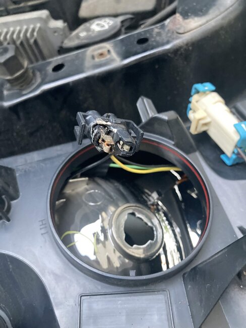

I drive a 2007 Chevy Malibu LS with L4 engine 2.2L capacity. I am replacing the low beam headlight socket with a new pigtail because my old one either melted or corroded. I need to know whether I should purchase a low or high temperature socket because both are compatible with my car. I use standard halogen H11 bulbs. Which socket do I need? Low or high temperature?

I would get he high temperature socket because the bulb gets hot for this application, please what this video to show you how to change it out.
https://www.youtube.com/watch?v=PxA5wczsCVo&t=1s&pp=0gcJCU8LAYcqIYzv
This is not the same car but the procedure is the same. Let me know how it goes
