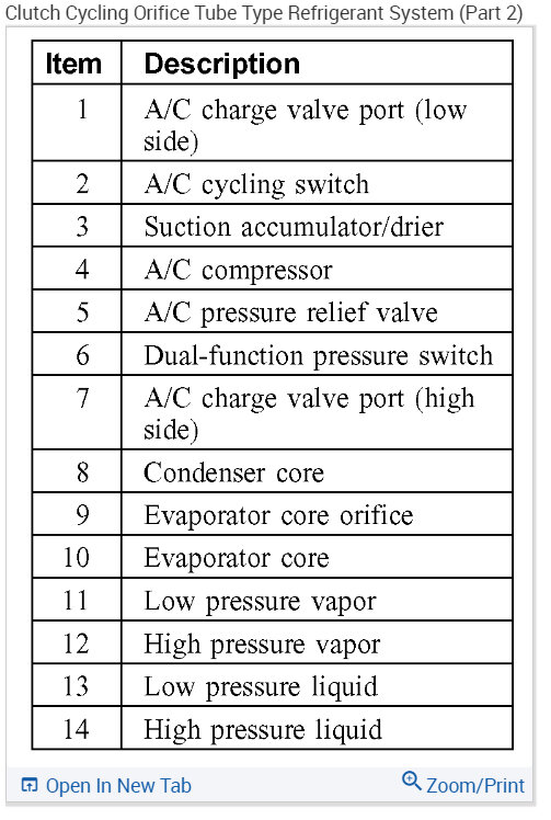

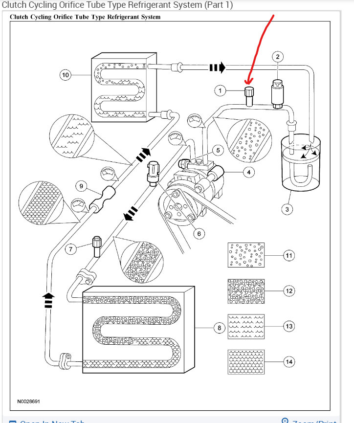

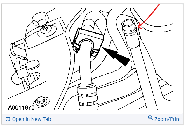

I am trying to charge my A/C and the can I got says it connects to the low side service port. It won't lock on the one we thought was the low side port.
Aug 30, 2023 at 2:56 AM
  • 55,433 POSTS
The low side service port is always on the return line from the firewall to the compressor. This video can help. please check the images below as well.
https://youtu.be/ON2dYcmXIAw?si=Vrw1adHCb3mZZUls
Aug 30, 2023 at 5:41 AM
SFLANARY
We got it. Thank you
