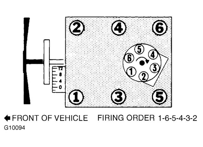

I start truck revs up than slowly falls to 5 once truck warms up idle goes rough and down to 4 and one time went down below that and thought I could smell raw fuel I have chance every thing I can think of I took it to I mech he said poss valve issue I put new distributor in set timing 2degress retard I am at my wits end

check for a blown gasket at bottom of tbi unit use choke cleaner and spray around it if idle changes then replace it.

I put a bran new on had lest new injectors fuel pump press check comp check

timing should be at 0 not 2 retard for one thing. recheck firing order see pic

Hi checked firing order ok returned to zero still low when hot thx

Hi I still can't find out what going on with my truck but today I found out that I have a leaking intake manifold gasket and I had a code that read o2 running rich would fixing that leak stop engine from running rich and stop service engine light from coming on at idle and going off when I drive and low rough idle your thoughts.

anytime you have a vacuum leak it will screw up the idle and make run rough due to incorrect fuel mix coming in. the O2 should be reading lean not rich however.
