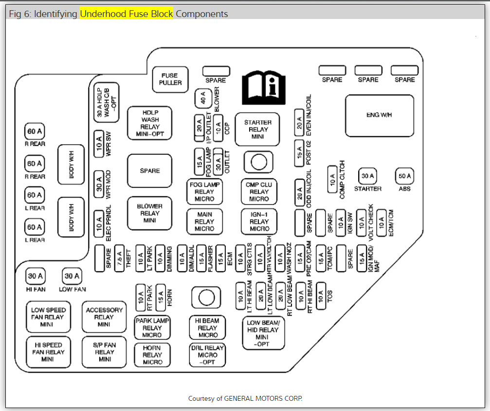

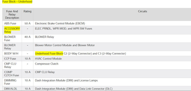

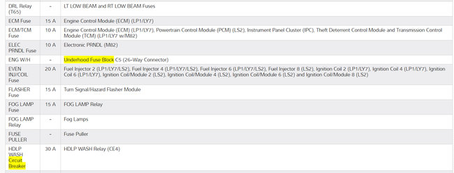

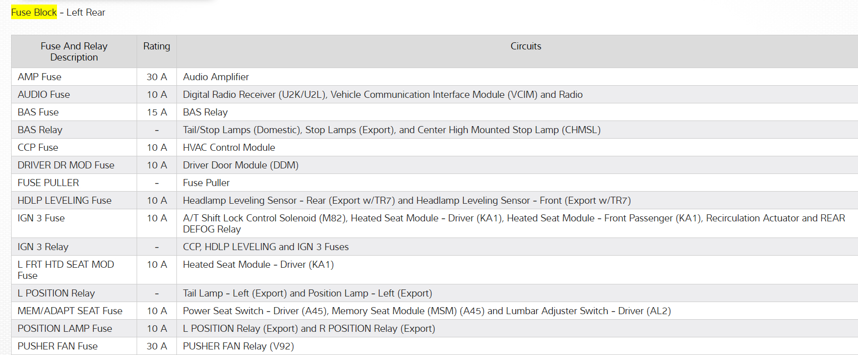

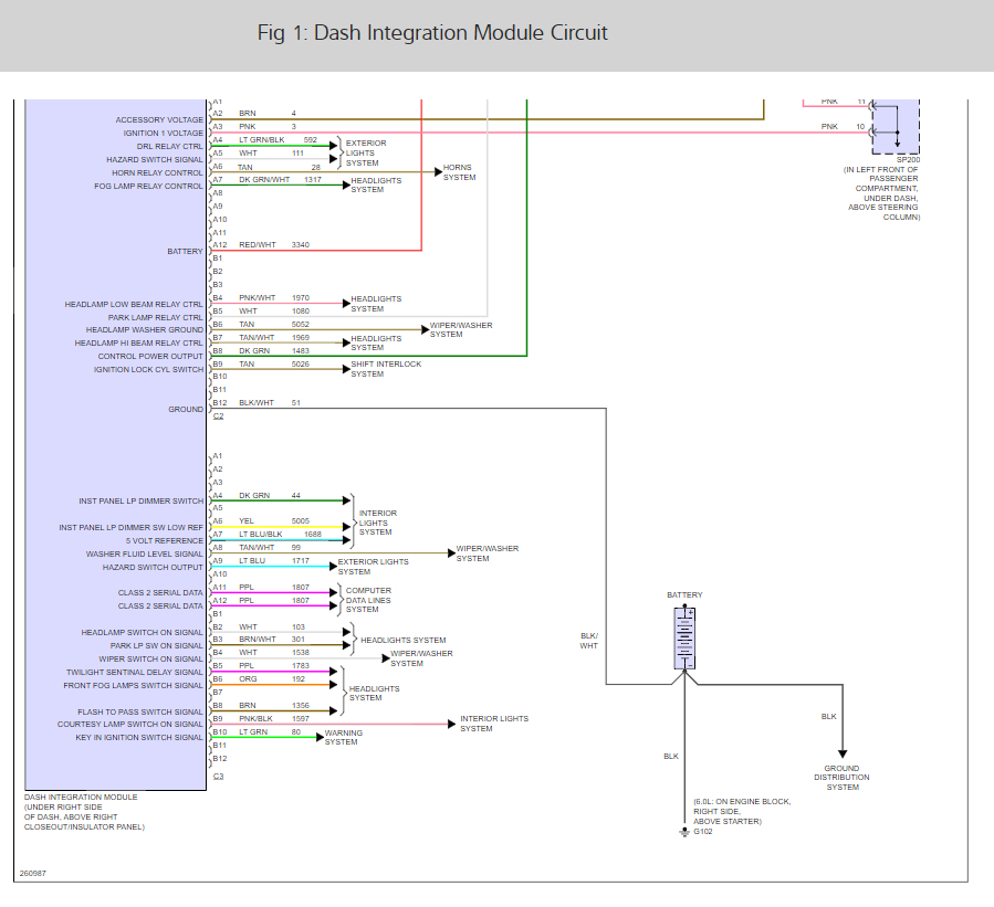

I have three quarters of a tank of gas, yet get the message "low range". Car will not start and does not crank over, although the dash and headlights have power and battery is fine.
Tuesday, January 9th, 2018 AT 7:06 PM
KEN L
  • MASTER CERTIFIED MECHANIC
  • 48,363 POSTS

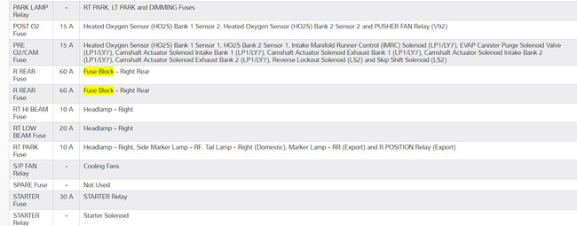

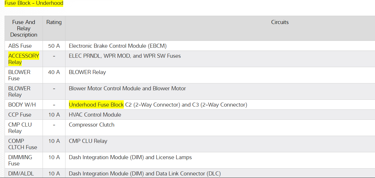

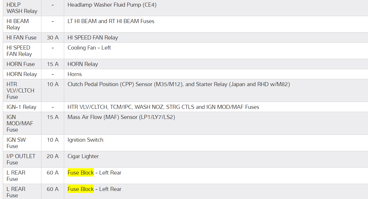

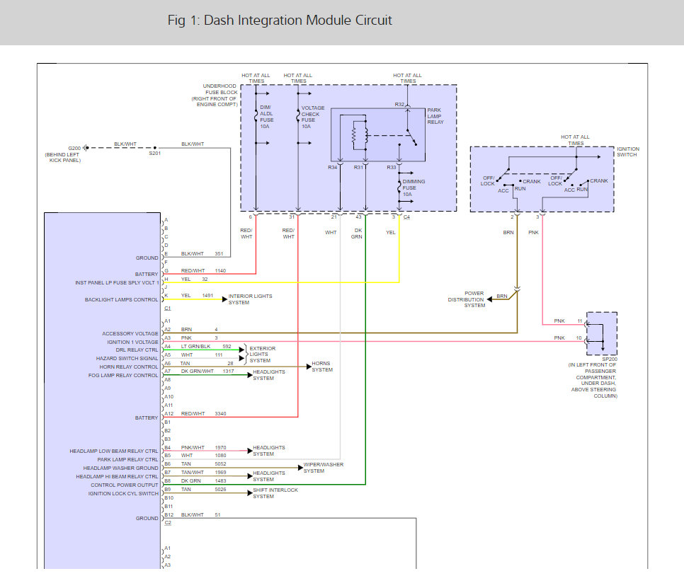

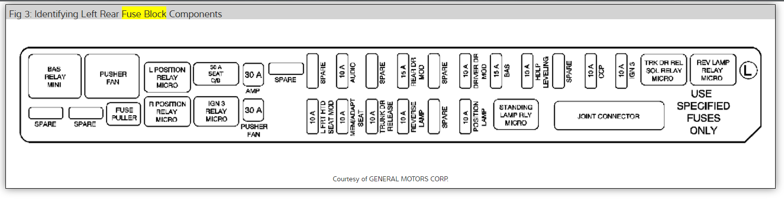

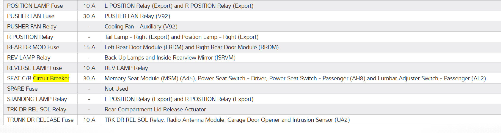

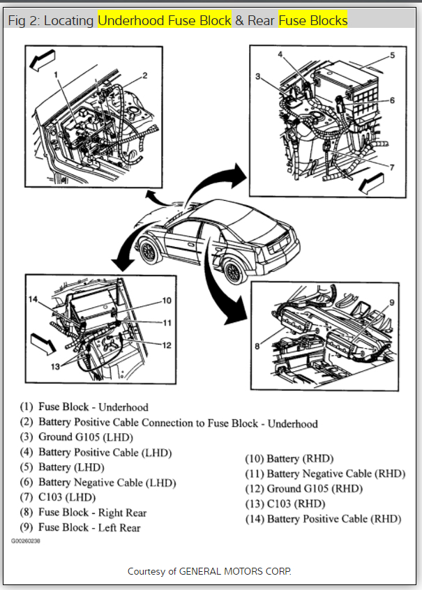

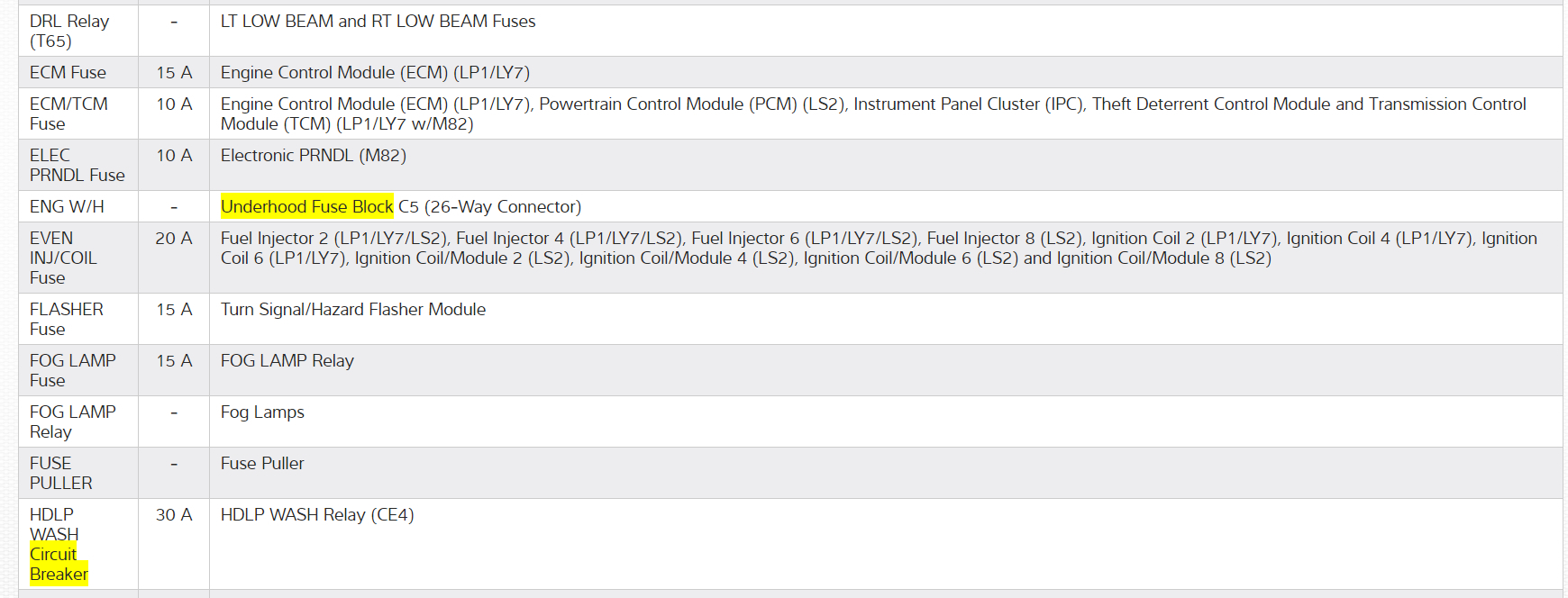

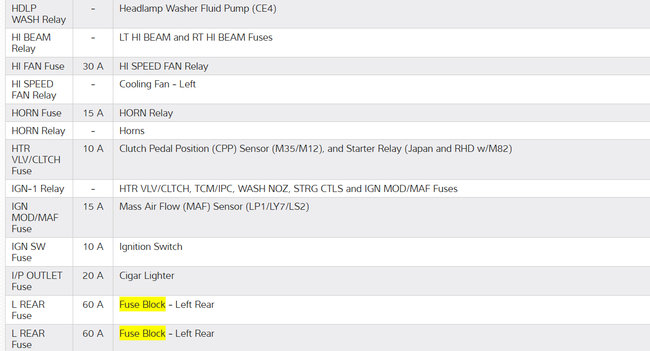

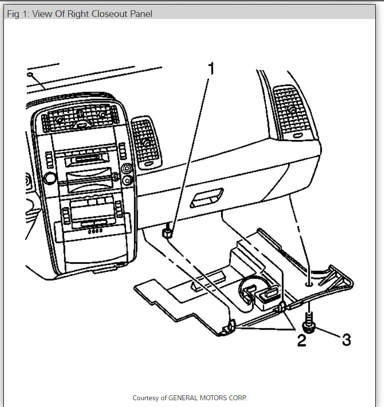

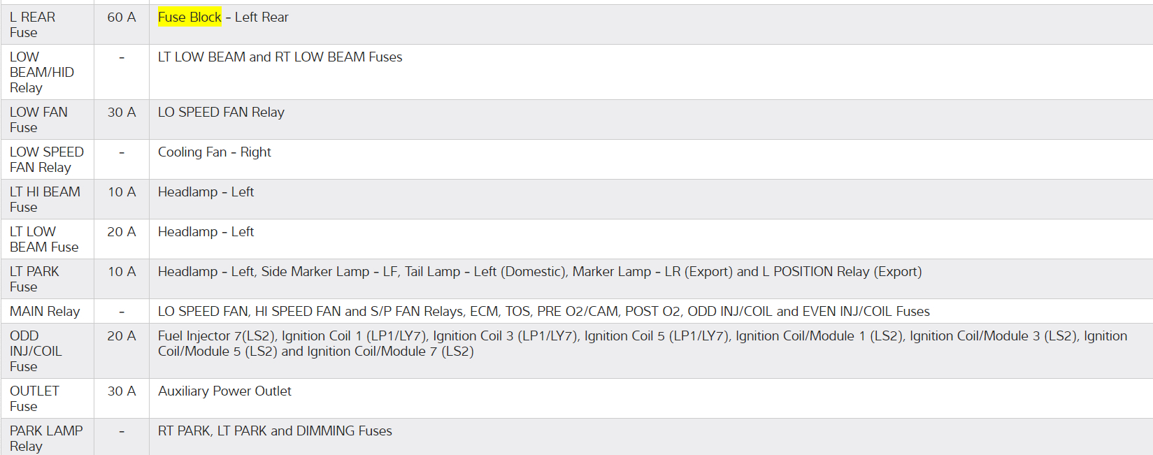

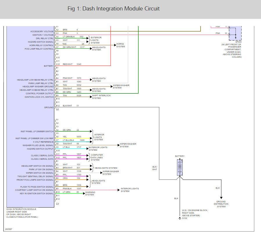

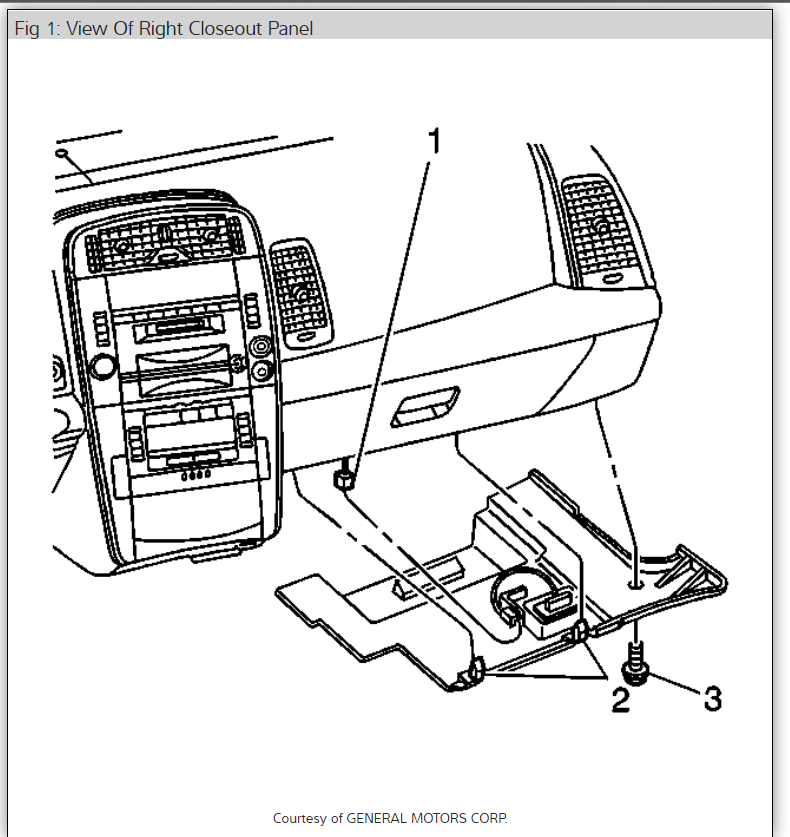

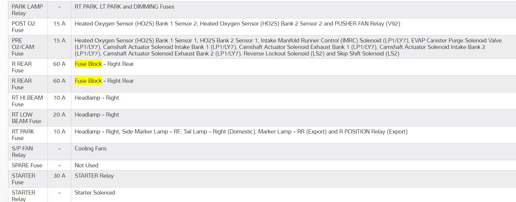

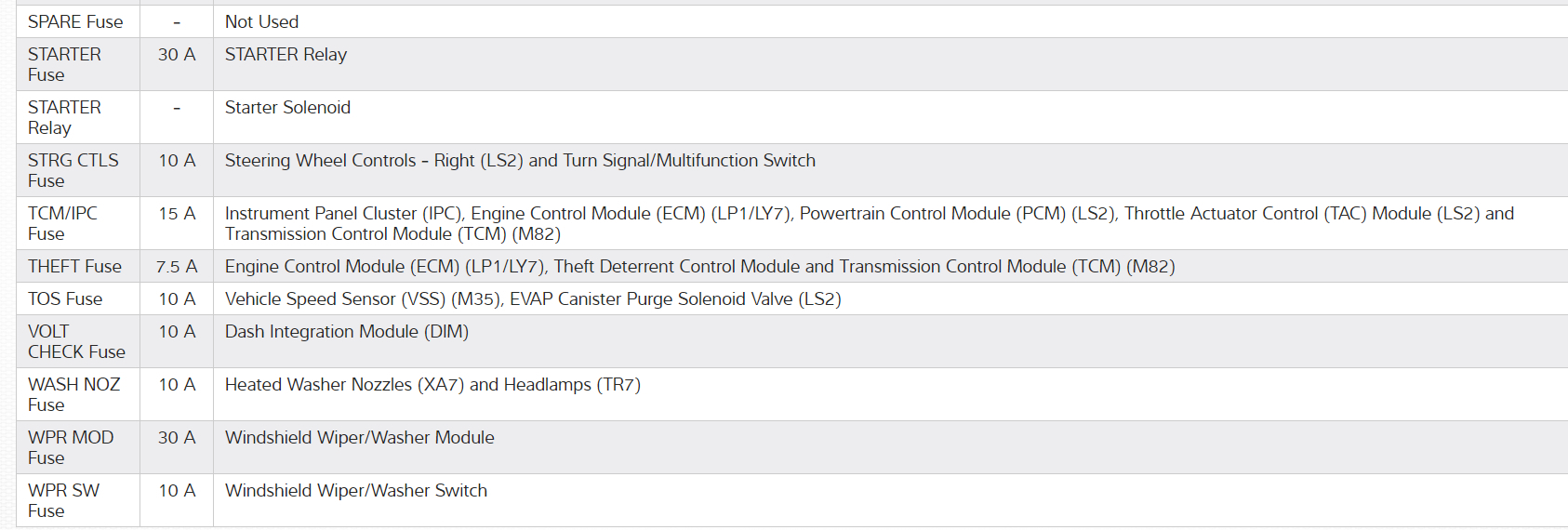

It sounds like the dash integration module is having problems but to be sure we should check the fuses to make sure they are all good. ALDL and voltage check fuses.
Here is a guide to help you:
Please run this test and get back to us.
