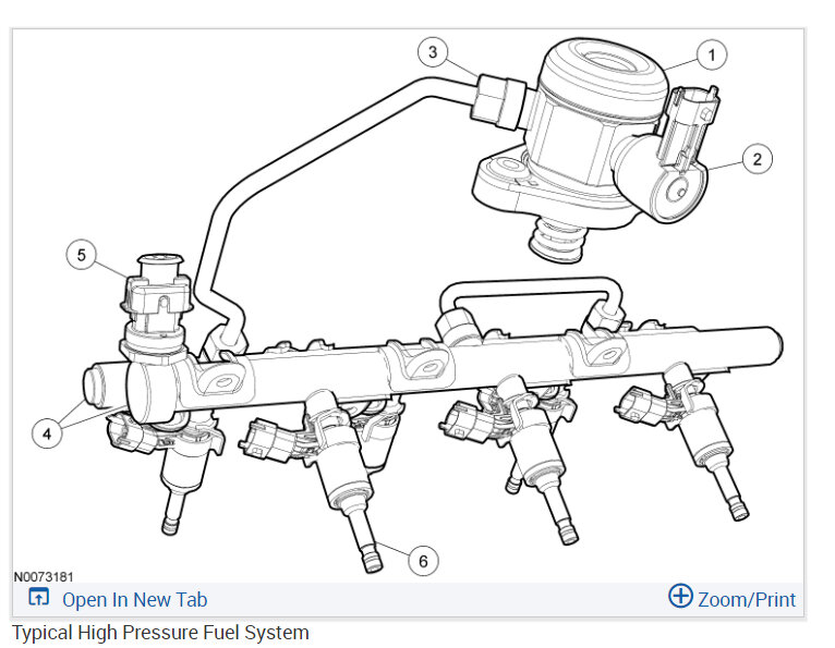

P00C6 "Fuel Rail Pressure Low During Engine Cranking."
This means the high-pressure pump has gone out, also, when the pump is out, I would use a flashlight to look at the condition of the camshaft to make sure the fuel pump activation lobe is not ground down. Check out the images (below). Please upload pictures or videos of the problem so we can see what's going on.

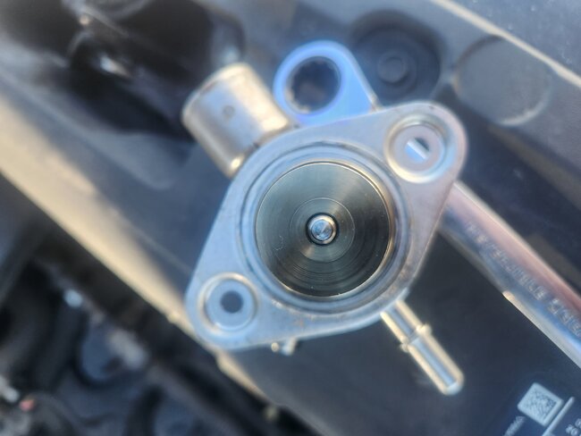

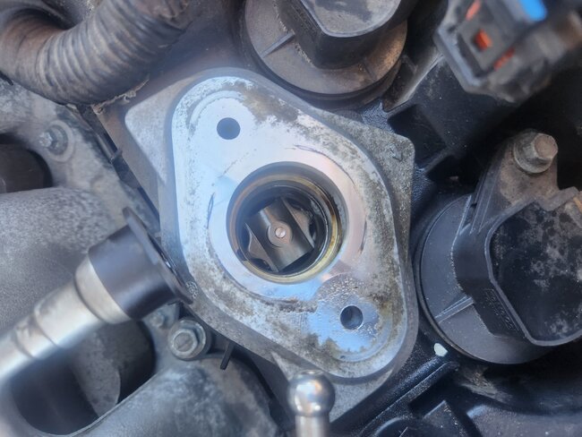

19 degrees out. Going to check it right now.
Nov 27, 2023 at 1:07 AM
  • 55,691 POSTS
Celsius, I hope?
Nov 27, 2023 at 1:15 AM
JEFF HERMAN
  • 486 POSTS
Nope, Fahrenheit. Here's what the pump and lobe look like. I think they look good, no excessive wear.
Nov 27, 2023 at 4:18 AM
  • 55,691 POSTS
Brrrrrr... :/ thanks for the images, I would replace the pump and then clear the codes, let me know what happens please.

Waiting for the pump to come. Before I put it in, I'll remove the follower and look at the actual lobe. I don't expect excessive wear, but I'll check the roller for free movement.
Nov 28, 2023 at 1:32 AM
  • 55,691 POSTS
Good call, let me know how it goes with the new pump, also if you think you see wear and the cam after the follower has been removed please upload an image.
Nov 28, 2023 at 3:17 AM
JEFF HERMAN
  • 486 POSTS
19 degrees F, so waiting for mid to high 30s tomorrow.
Nov 28, 2023 at 3:41 AM
  • 55,691 POSTS
Sounds good.
Nov 30, 2023 at 1:12 AM
JEFF HERMAN
  • 486 POSTS
I inspected the lobe and follower. No wear and the roller spins freely and is oiled. This looks like good news. Lol
Nov 30, 2023 at 1:25 AM
  • 55,691 POSTS
Yep, that is good news. Let me know what happens after you install the new high pressure fuel pump.

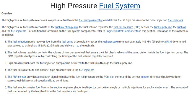

It could be a low compression issue; can I ask if you cleared the code, and did it come back? I was thinking maybe the lift pump in the tank could not be supplying the fuel to the high-pressure pump, let's run a fuel pressure test on the low-pressure system to see if that is the problem. Also let's check the compression on #2.
These guides should help:
and
Engine running 55.1 - 75.4 psi (380 - 520 kPa)
KOEO 58 psi (400 kPa)
Please go over these guides and get back to us.
