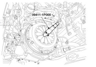

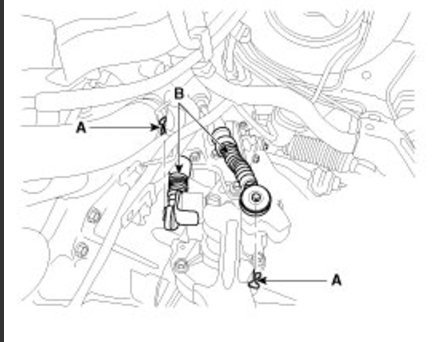

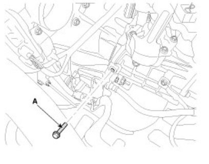

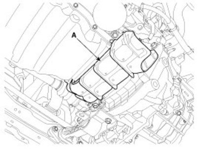

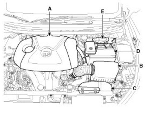

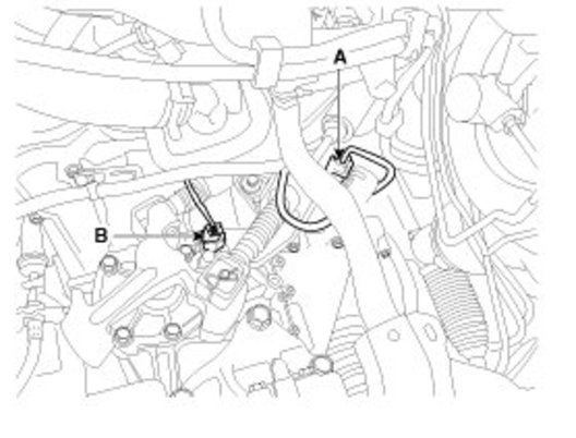

  • 55,743 POSTS
Yep that will do it.
Here is a guide that will show you what you are in for when doing the job.
https://www.2carpros.com/articles/how-to-replace-a-clutch

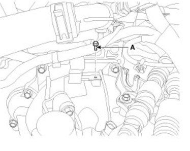

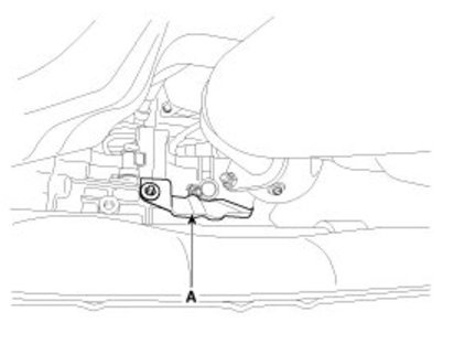

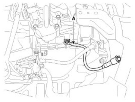

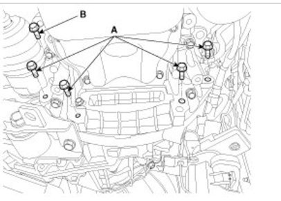

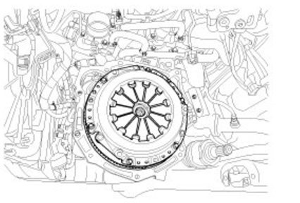

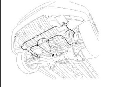

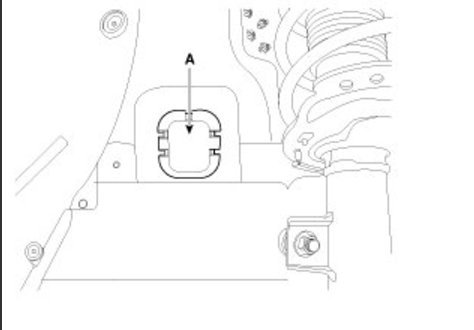

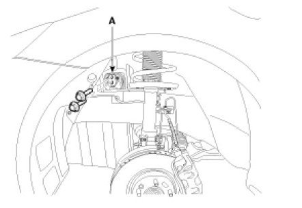

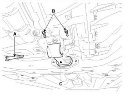

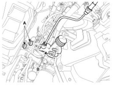

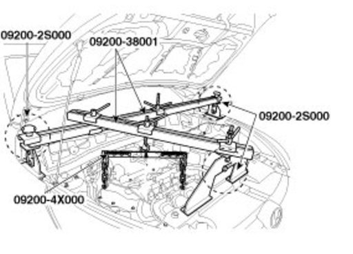

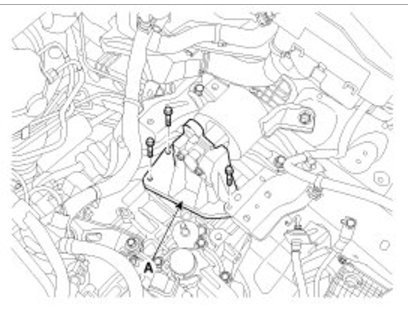

And here are some diagrams of what it will be like on your car.

  • 55,743 POSTS
Yes if the clutch is slipping it will cause low mileage. You should be able to tell if it is slipping can you?
