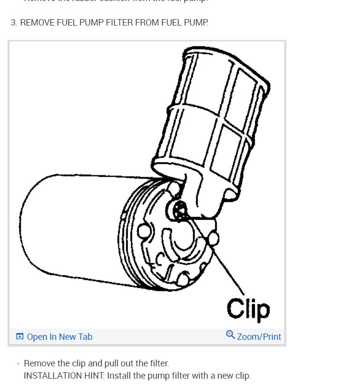

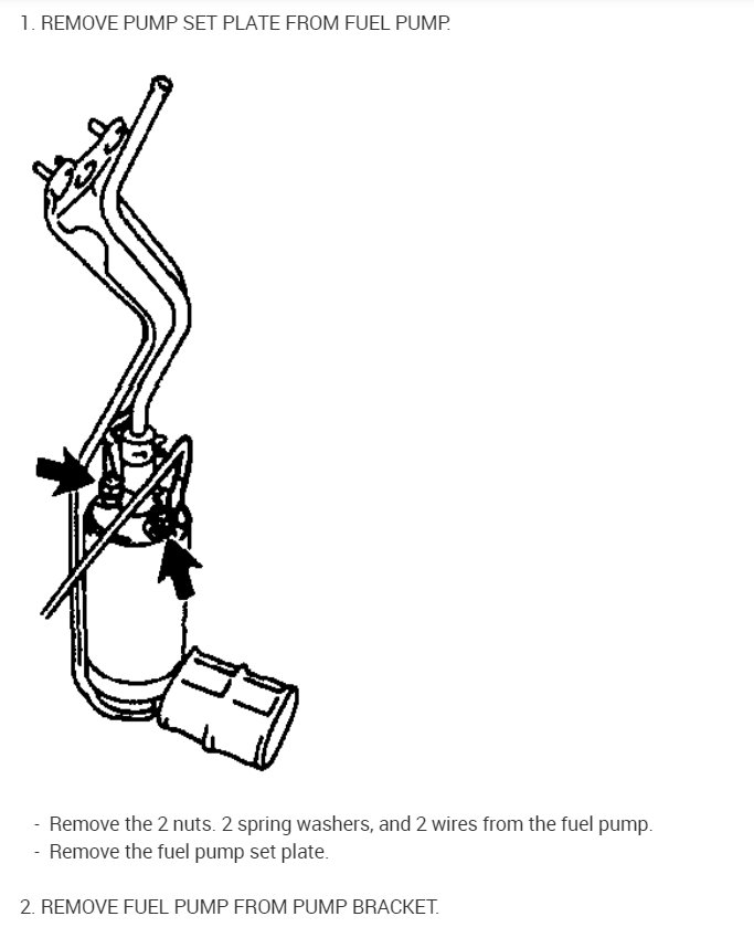

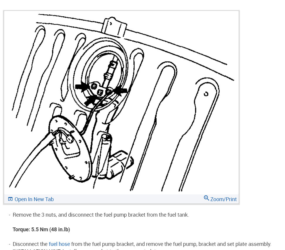

I had to replace my fuel filter,fuel pump,plugs,coils, fuel regulator,air filter. I did this because I ran out of gas and I didn't have power.It ran good for 2 weeks and then just lost power again.It sat up for 2 days and it started up real good. I top it off it ran good for a few days.Then the same problem no power. what could it be?
Oct 1, 2019 at 2:13 PM
  • 55,721 POSTS

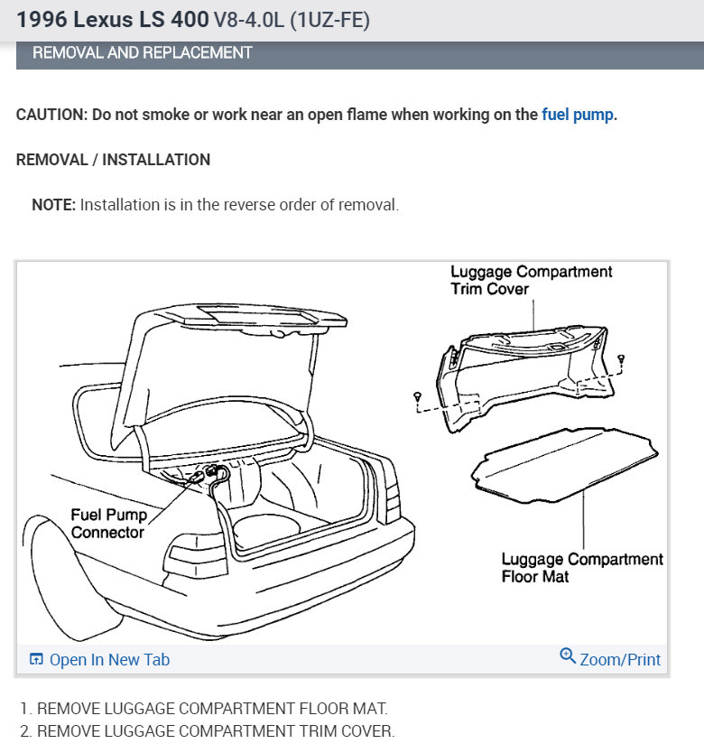

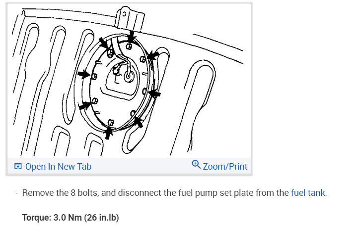

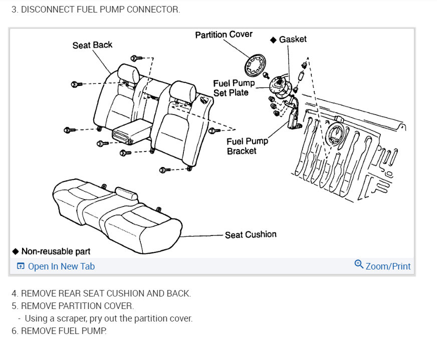

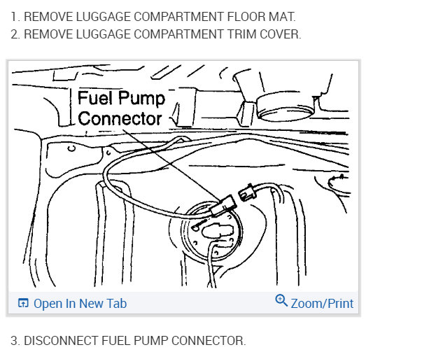

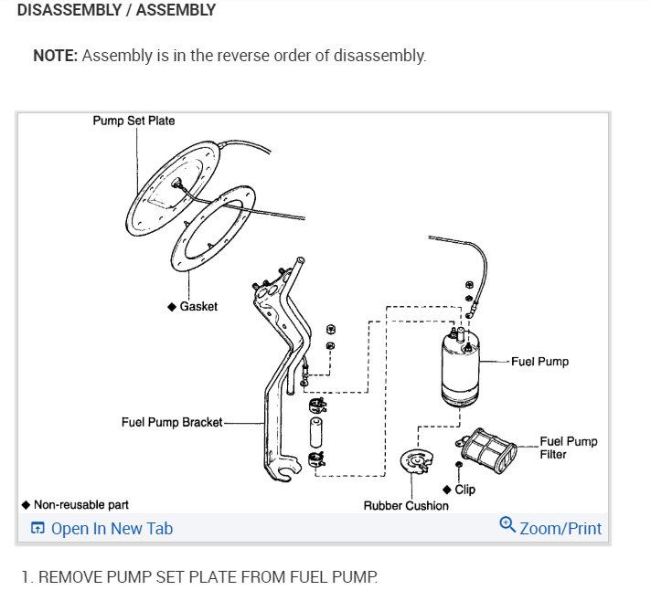

This sounds like you have a fuel pump going out. To be sure we need to check the fuel pressure. Here is a guide to help and instruction below on how to change the pump out:
These guides can help as well:
https://www.2carpros.com/articles/engine-has-low-power-output
