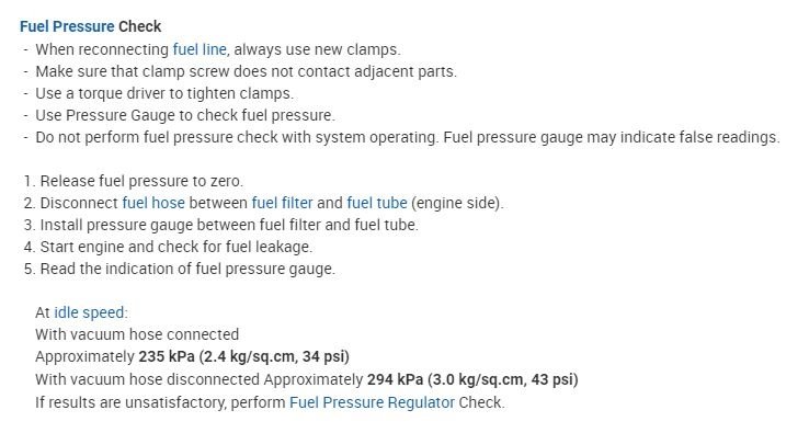

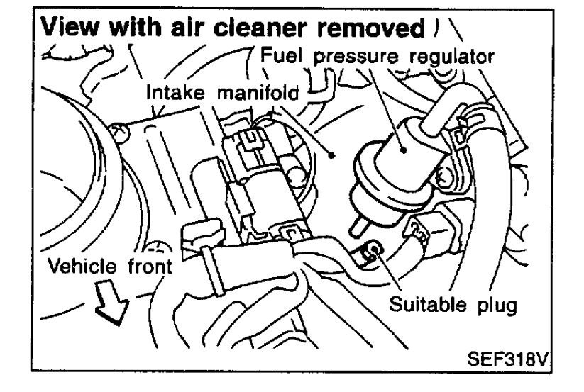

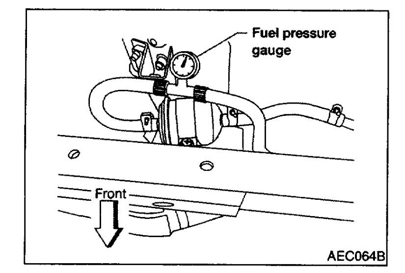

Good morning,
This could be from low fuel pressure. I would check the actual pressure.

Okay, back to fuel pressure.
