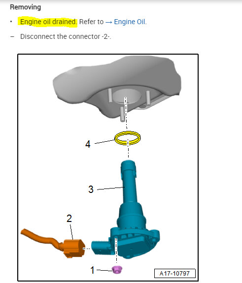

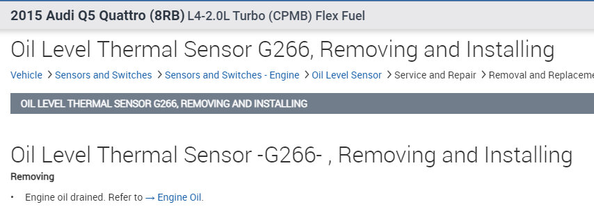

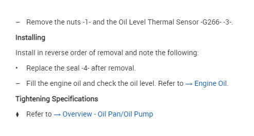

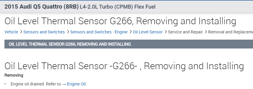

The oil level/temperature sensor is located on the bottom of the engine oil pan. It is held in with three 10mm bolts.
If you plan to replace the sensor, the engine oil needs to be drained first. When you install the new sensor, make sure the O-ring is replaced as well. Also, lubricate the o-ring with motor oil prior to installation.
I attached the directions below from my manual. If you haven't already, check to make sure the oil level isn't low.
Nov 4, 2023 at 2:41 PM

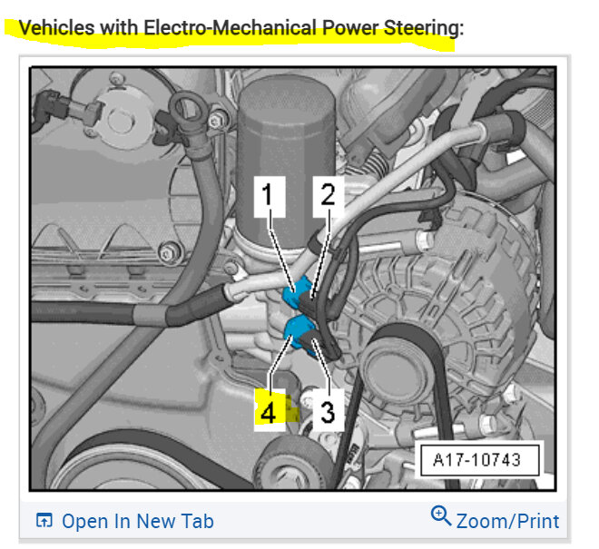

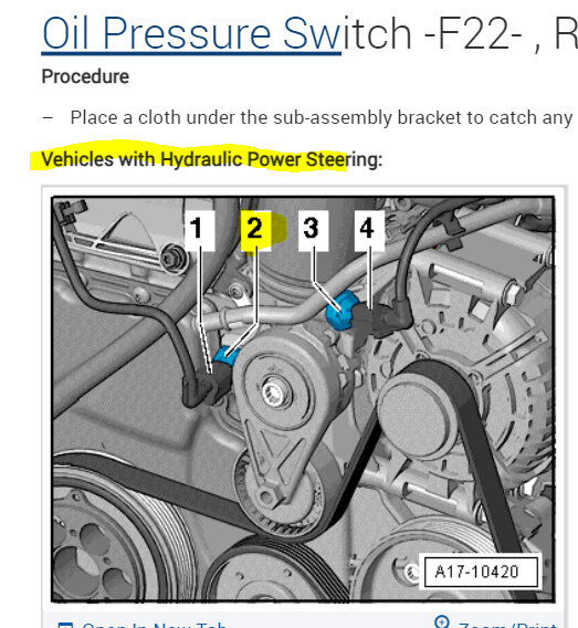

What about the oil pressure sensor?
Nov 5, 2023 at 10:26 AM
  • 110,244 POSTS
There are a couple of possible locations. It is based on if the vehicle has a hydraulic power steering pump or electric-assist power steering.
I attached two pics below showing the locations. If you have a hybrid or something different, let me know.
See pic below.
Nov 5, 2023 at 1:13 PM
