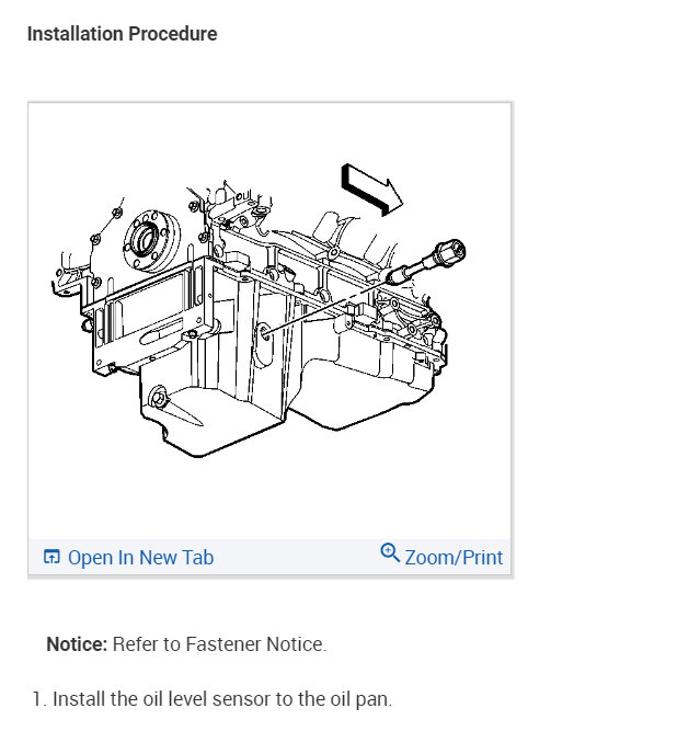

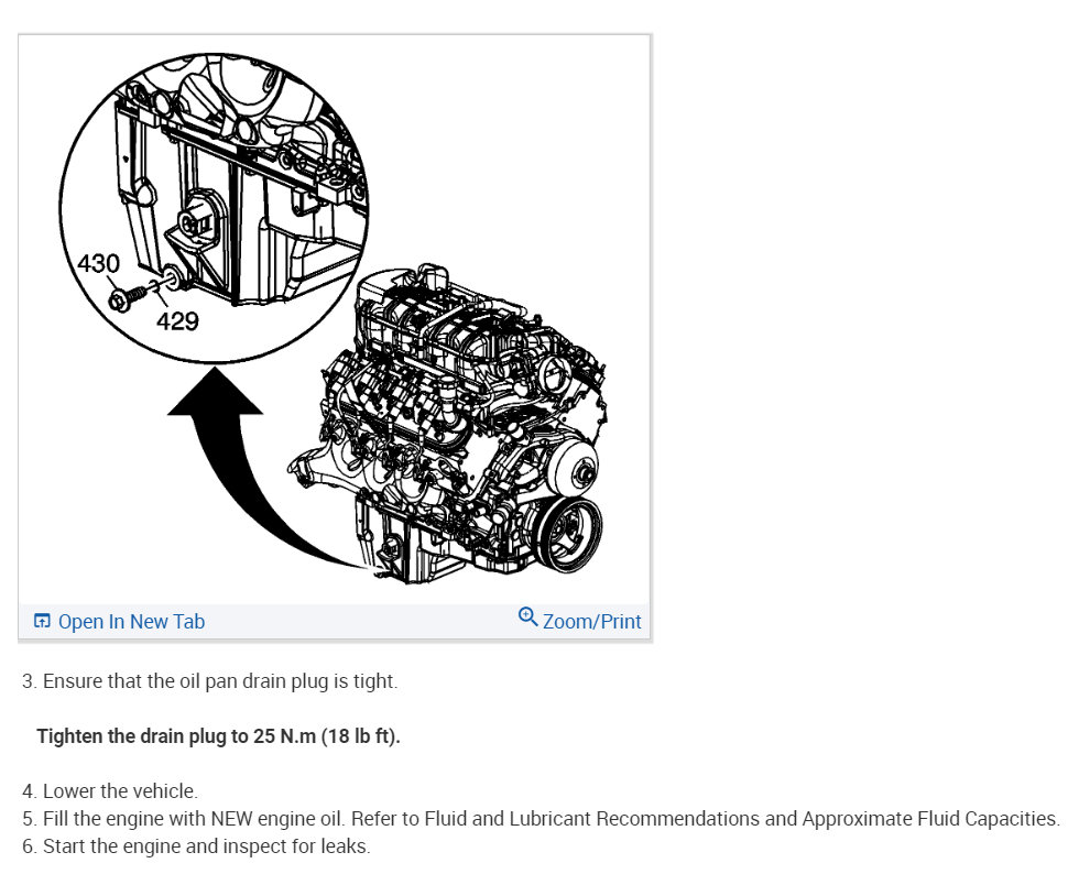

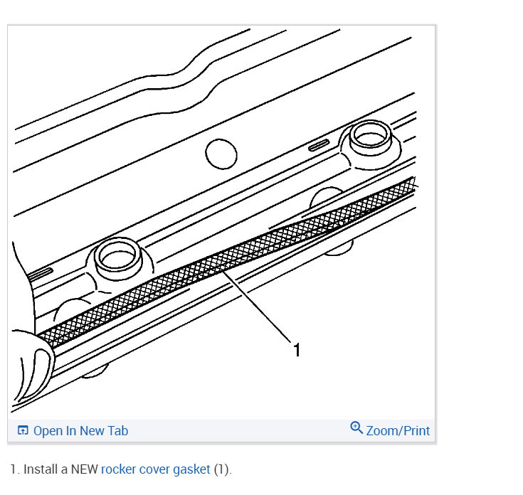

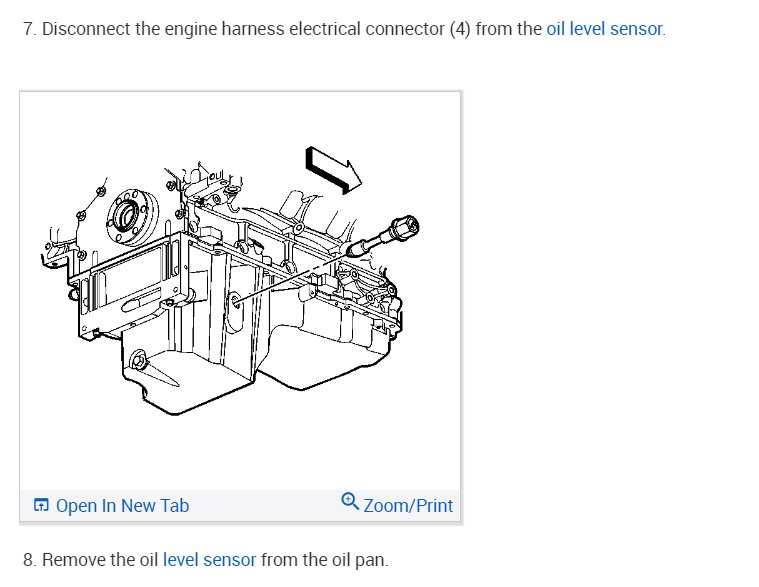

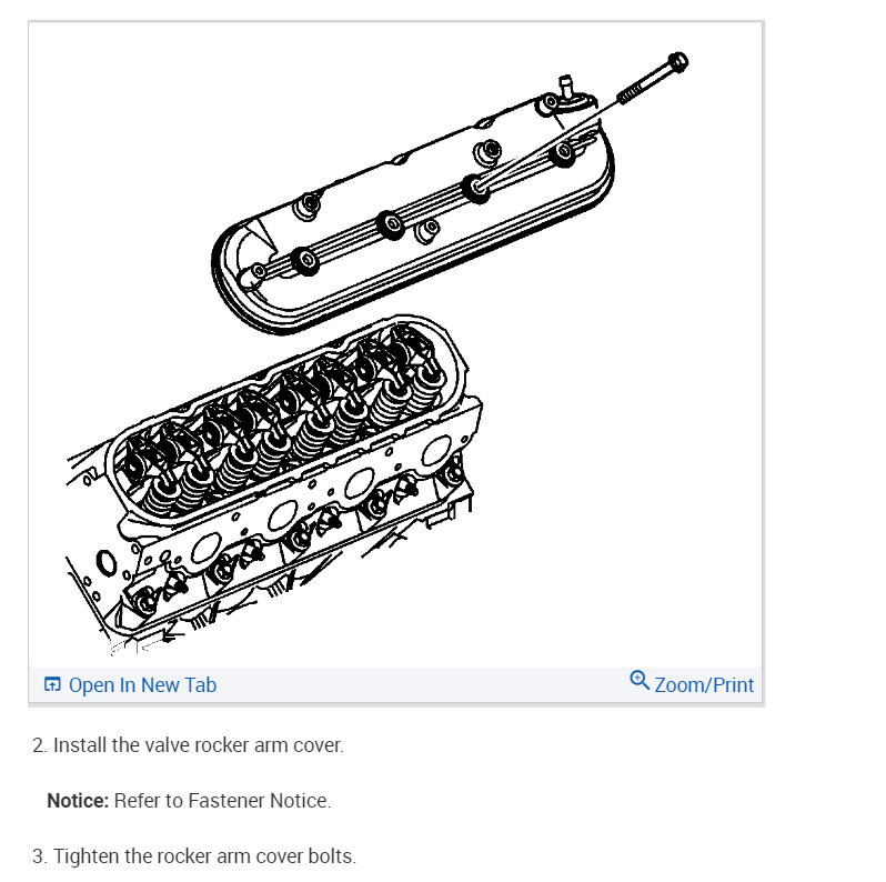

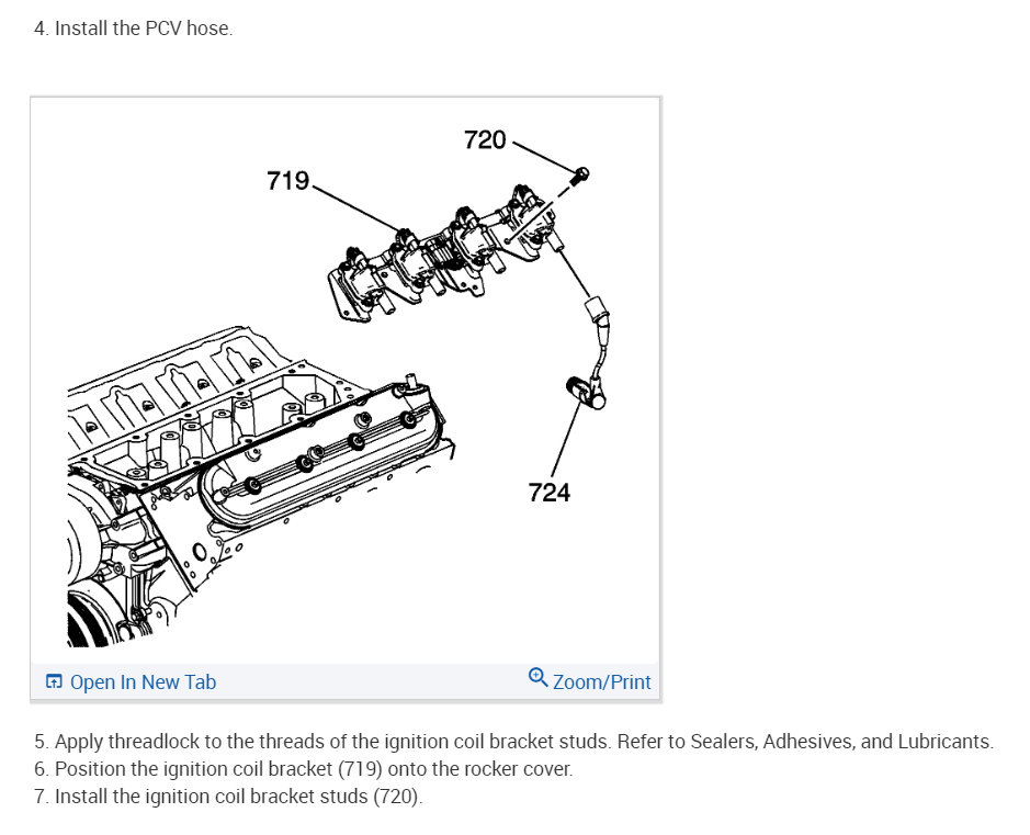

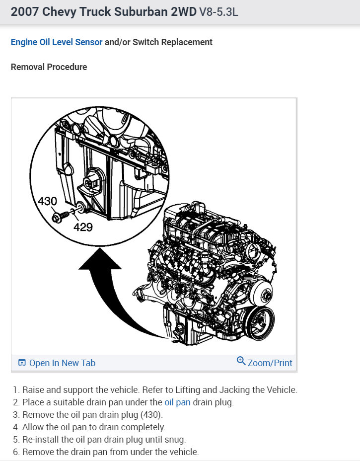

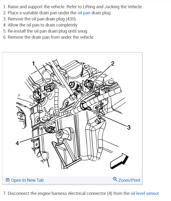

Low oil warning came on, so I added oil. Drove 15 miles and warning light came back on. Stopped and checked the oil stick and it's reading halfway up oil stick, but I can smell oil burning as well. Also, replaced fuel pump because a month ago due to ignition turning over for several seconds and taking several times to crank. And now it's doing the same thing. Help
Aug 10, 2022 at 12:09 PM
  • 55,447 POSTS

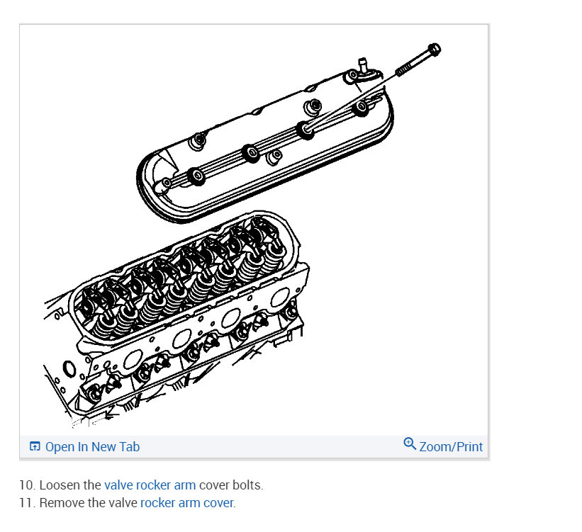

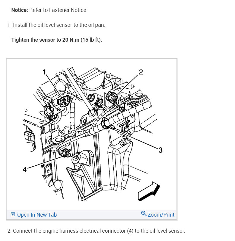

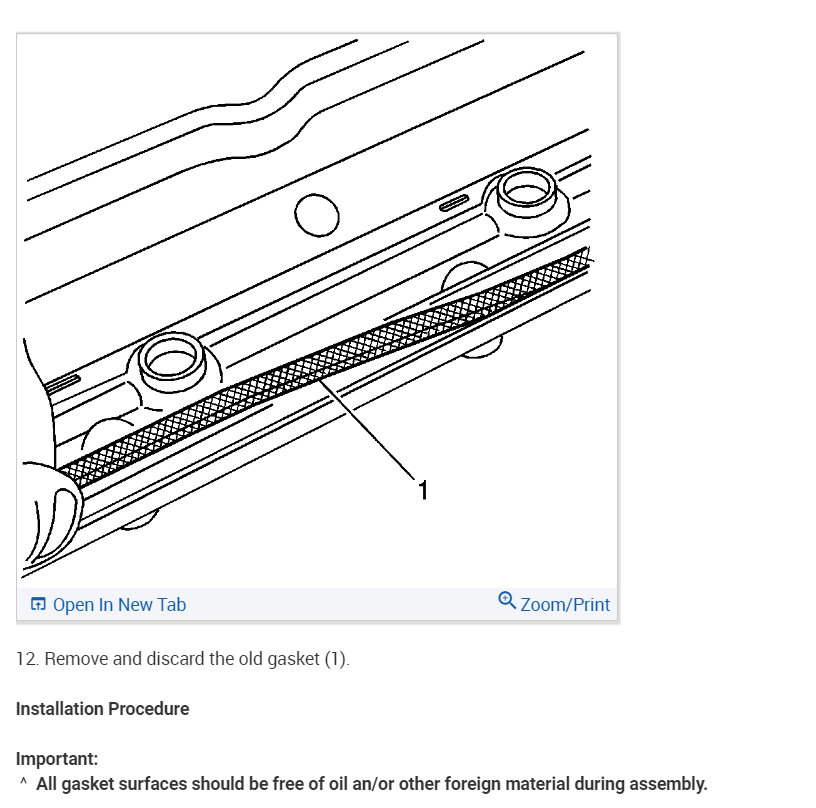

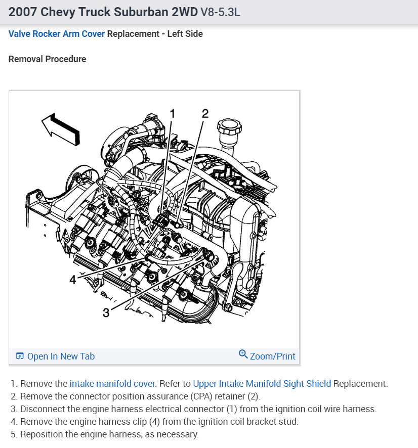

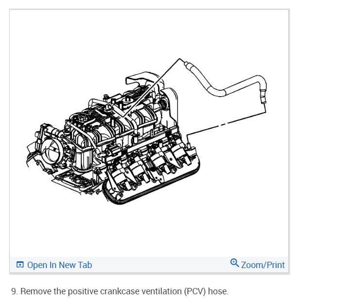

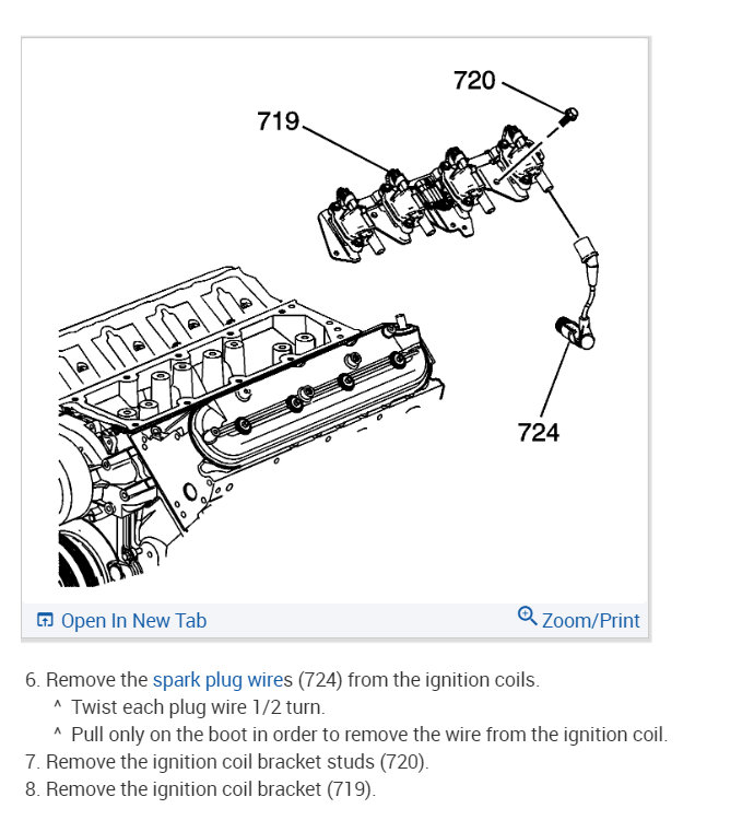

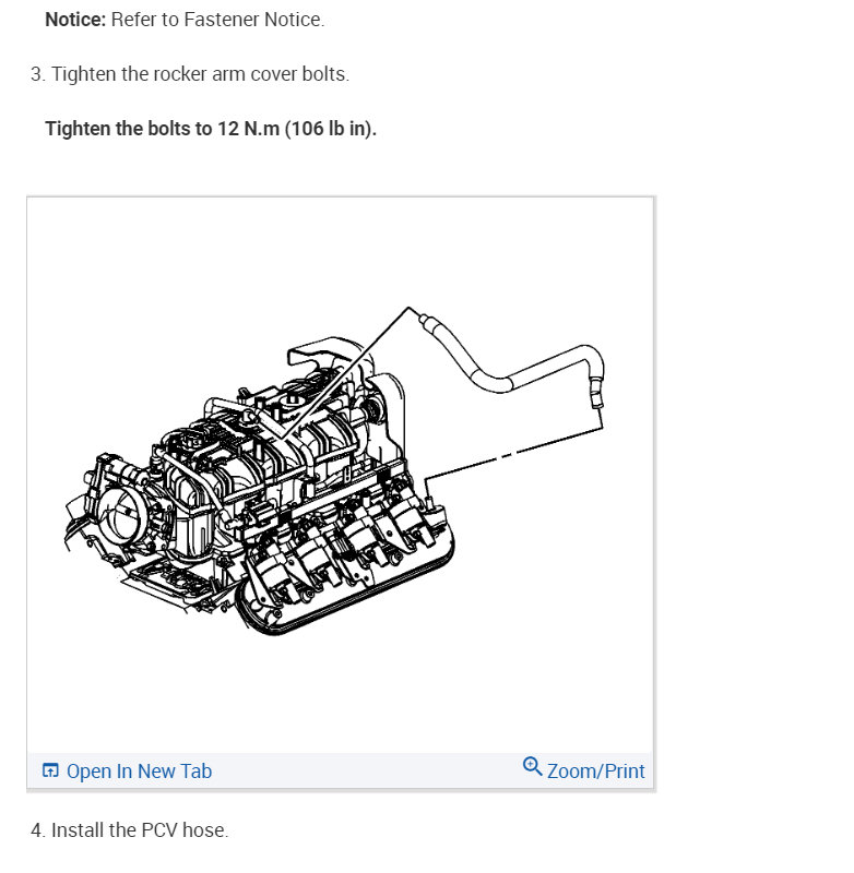

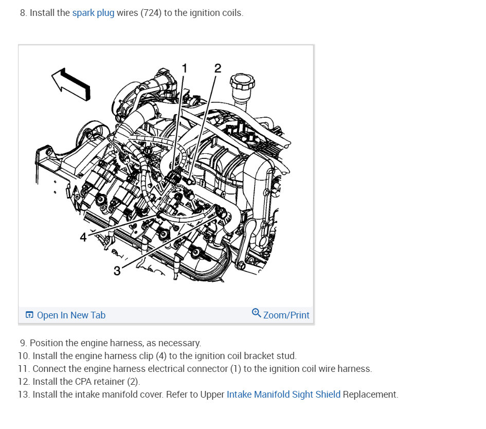

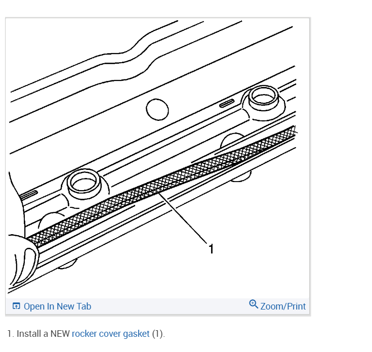

We can only handle one problem per question so you will need to start a new question for the fuel pump issue. It sounds like you have a valve cover that is leaking onto the exhaust manifold which causes the smell, and you have an oil level sensor that is no good. here is a generic guide on how to change out a valve cover gasket with instructions in the diagrams below to show you on your car. Also, I have included the location of the oil level sensor so you can check it out. I would drain the oil first.
https://www.2carpros.com/articles/replace-valve-cover-gasket
